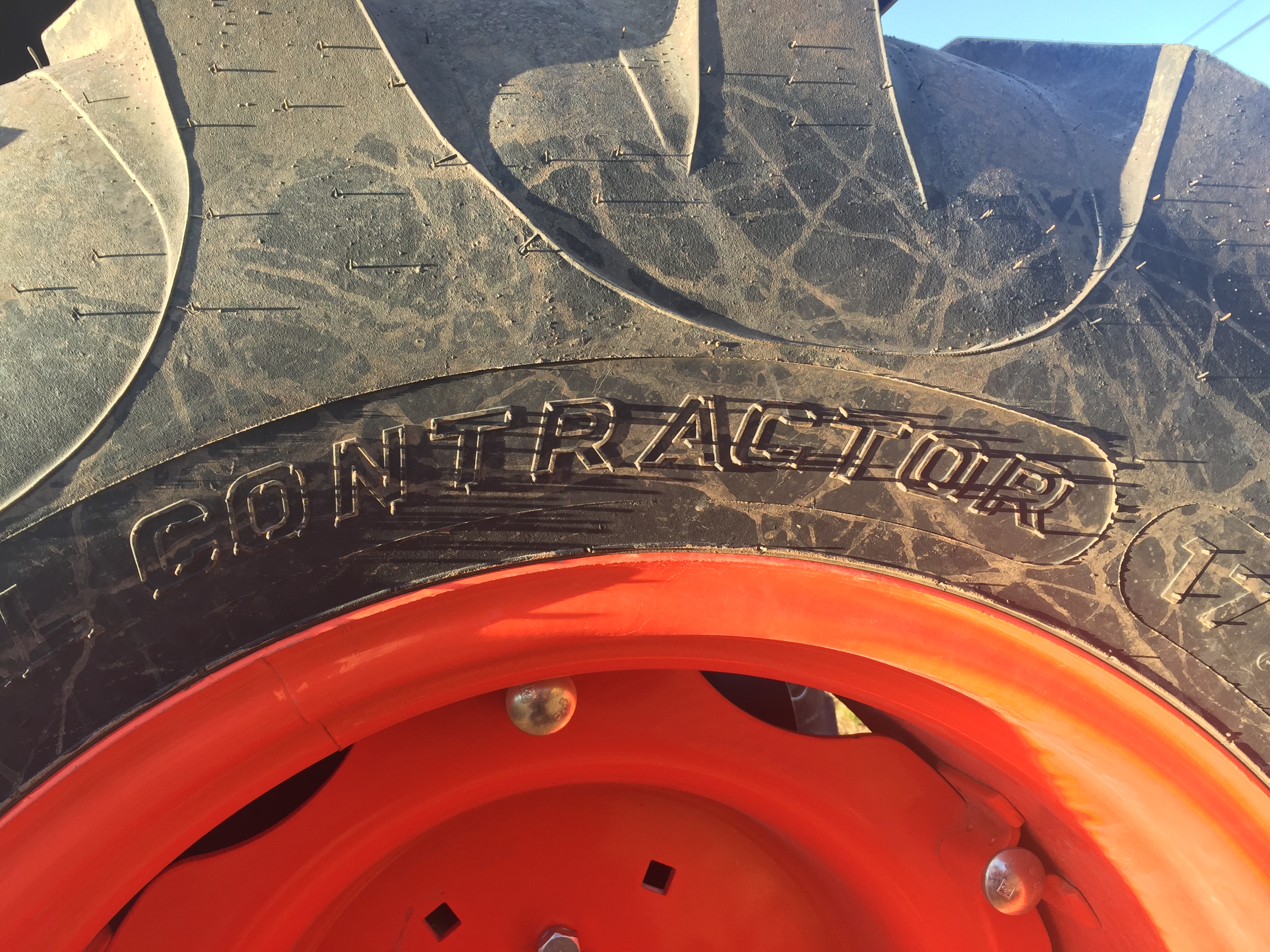

Yes, that's exactly what they are talking about above. In the photo in Post #16, you can see the valve stem. Normal install would have the valve stem on the inside of the wheel, but he's reversed the hub disk, and swapped left to right. It is weird that dealers haven't heard of this, people move the disk to the opposite side of the spacer all the time -- but up until now I hadn't heard of anyone reversing the disk. Good idea.

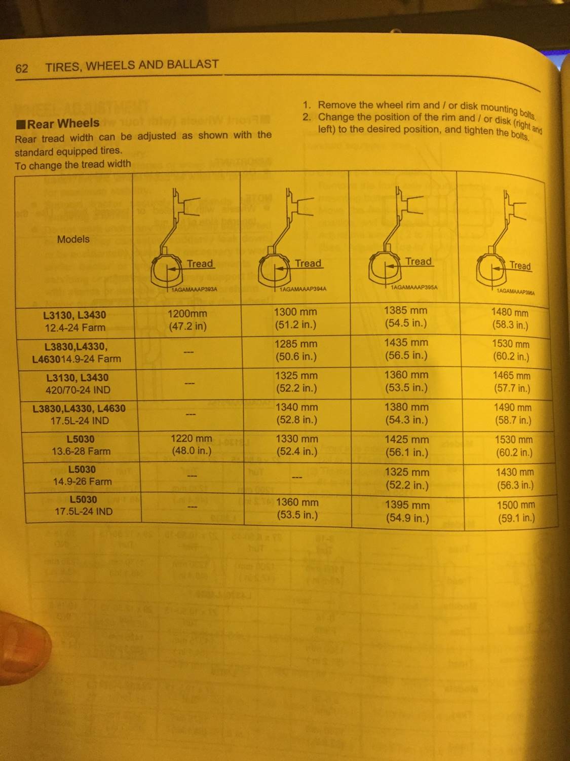

Consulted the L3130 owners manual and found a page describing tread adjustment (see attachment). For the 17.5L-24 industrial tires the data suggests an extra 4.4" of tread or 2.2" per side can be obtained by repositioning the hub disk/rim interface. I realize this data is for a 30 series tractor, but the 40 series shouldn't be all that different. Perhaps someone with a Grand L 40 can confirm.
Never paid any attention to this page before because the turf tires couldn't be adjusted.
Fat Tire, Agree it was weird they didn't know anything about it. One of them is consulting Kubota Technical tomorrow to find out.
Note: 4.4" based on 58.7" - 54.3" tread positions.

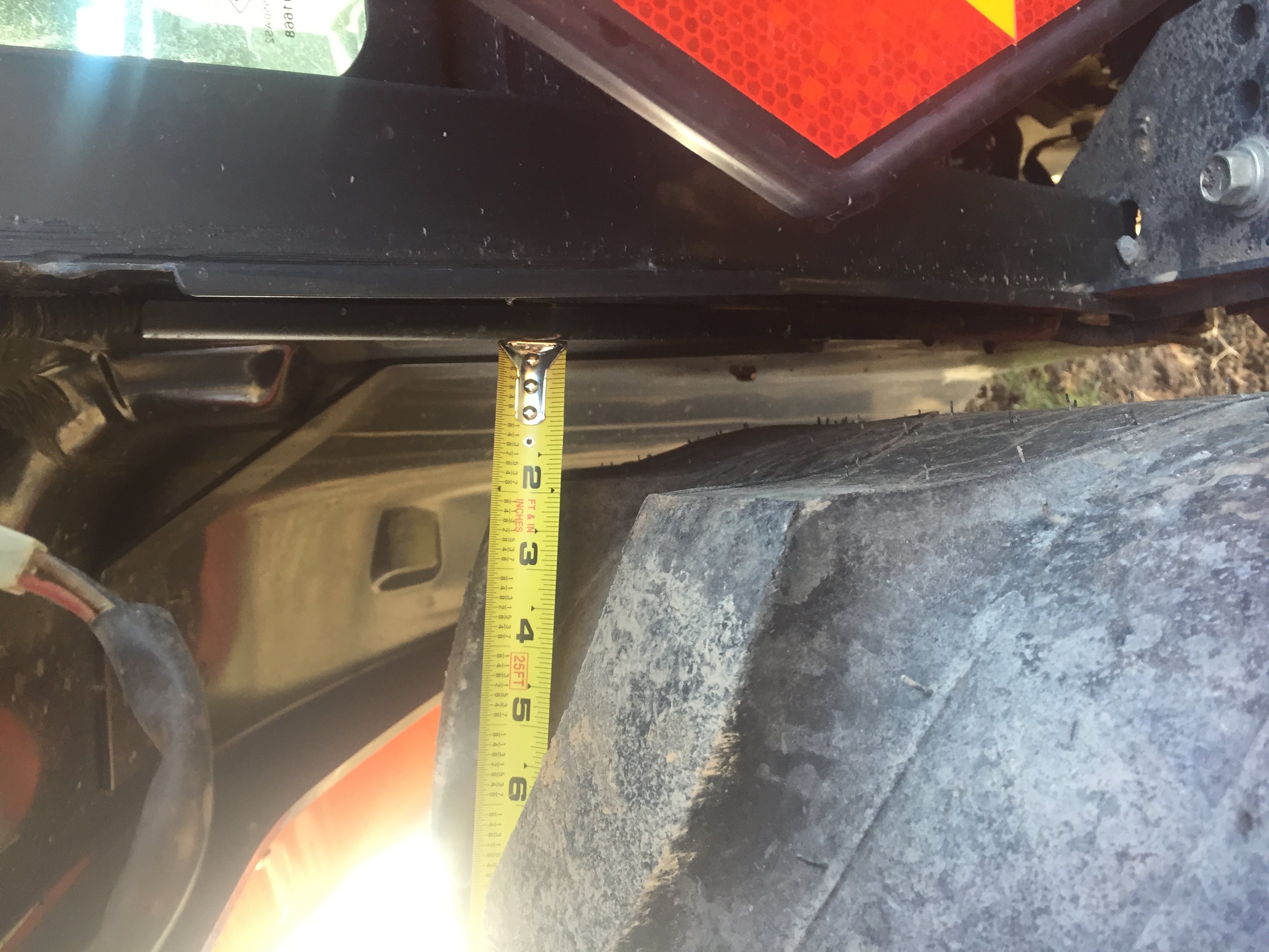

Thought I'd share what the dealer sales person relayed from Kubota Technical concerning repositioning 17L-24 R4's.
They claimed the tires/wheels are already at their widest position and can NOT be made wider. I've included a picture, so you can see first hand what they are "claiming" is the widest setting. I didn't say anything, as I believe others on this forum who present solid evidence their rims/hubs are repositioned for greater clearance.
Picture 1: Measurement of tire/inner fender clearance
Picture 2: Orientation of rim and hub disk. You'll have to zoom in to see the hub disk is positioned outside the rim.

That 2 (or 2 minus) inches you are showing looks like what the dealer sent me for my L5740. In a perfect world it would be enough, but in my world not quite. Funny, Kubota apparently has no idea about TripleR and dstig1's solution. Should have my 5740 by the end of next week, maybe in time to use during the multi-day storm forecast for the last few days of the month.

That ain't enough room for a rubber band. What happens if you put the tire on the other side of tractor, I need chains so I'd see how durables spacers are and how much $, should be cheaper then a AG tire set-up.
