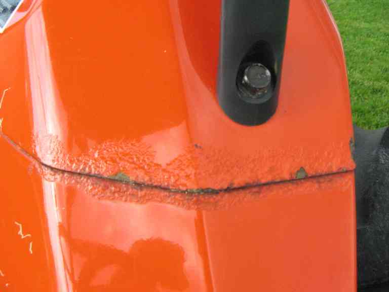

I do have a question about rust on the fenders of my L48. The unit I purchased used is a 2006 model. It only has 280 hours on it. It has obviously been kept outside most of it's life as the paint is faded on the loader and the wheels. The worst part I found out when picking up the tractor was the rust on the fenders. Right where the two halves of the fenders meet, there is rust bubbling up. It hasn't broken through the paint yet, but it obviously will.
Is this a common problem with L48's? Is there an easy fix? (Ya, right) Do most guys just ignore the problem or is it something that will eventually rot the fender apart? Any recommendations/comments are appreciated.

fenders? rear.superficial id say. quick fix would be to sand the bubble area,buy a can of kubota orange spray paint and touch it up.

I bought a couple cans of Kubota Orange from the Dealer and painted my snowblower. The fenders would be a pretty easy job....sand it down, prime it, spray some orange. The paint that comes in the cans from Kubota is enamel and I found that it sprays great, gives you a great shine with just a couple of coats, but don't drag anything across the new paint or set anything on it for a few weeks. The solvents in the enamel is slow to evaporate and therefore, the paint slow to harden. You could probably do the fenders for under $20.00. Dyer, retired

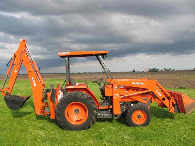

Here's a picture of the new/used L48. I took some rubbing compound and shined it up a little, then put some wax on the parts I could get to. It should help the paint from fading so badly.
The other picture is a close up of the rust on the fender. They must have used this tractor to clear snow off the road and got into the salt.

/ L48 rust #9
Have you decided whether or not you are going to bother with the rust? It is a nice rig and the fenders would be a pretty simple job to paint. Have you seen rust like this on any of the other surfaces? I've spent the week clearing trees killed in an ice storm years ago....I wish I had your
L48 with that backhoe for some badly needed stump work! Have fun. Dyer, retired

That L48 must have been used to load salt!! Mine has no such issues, echoing Larry's comments about using ours up here in NH plowing through salt and everything else. If it where me, I would sand and paint to stop any rust problems from spreading. The rig looks good, get a thumb for sure.

I'll probably just leave it as is right now. Unfortunately, the bubbling is on both sides of the fender and it is right on the line where the two halves meet. Therefore, if I grind it out, I'm going to have a hole since the rust goes all the way through. That would involve getting out the welder and welding a patch on, which is going to be difficult to do without welding the two halves together and having an odd looking patch. I'm in the process of building a house and just don't have time to go through what it's going to take to make it look right.
After reading some of the posts here, I'm finding it hard to conceive what they could have exposed this tractor to in order for it to rust so badly in such a short time. I'm starting to wonder about a manufacturing defect. Especially since the rust is only isolated to a couple of spots on the fenders. If the former owner would have been rolling through salt water, I would think the whole fender would be rusted out not just a few spots.
I highly doubt if Kubota is going to fess up to any defects, but I don't know. What kind of warranties do these tractors carry on rust, if any?
/ L48 rust #14
Go to your local tool rental and rent small sand blaster;the kind you can operate without getting suited-up, and some fine grit blasting sand. A couple of minutes and you'll have both fenders ready to prime/paint.The problem will reappear if you dont take the fenders apart so as to remove all the rust, but it will surely slow it down until you have more time. Be sure to use a good zinc oxide primer to help slow the rust
