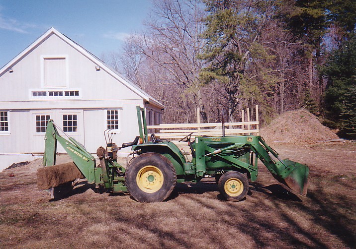

I've used both my backhoe and box blade as counterweights for the FEL. On my steep slopes, the backhoe is too much as the tractor tends to want to get the front wheels off the ground when starting upslope with an empty bucket. The boxblade isn't enough when trying to dump a full load downslope. The tractor stays safe, but the bouncing is disconcerting, at best. Adding weight to the front tires is appealing as I've had things hanging from the backhoe that have lifted the fronts off the ground (see attachment). That's the granit billet that caused me to get the flat. The front tires are just touching as the backhoe had relaxed enough to touch the ground as well. The door I placed it in front of is the one in the photo.
One of the reasons I was looking at filling my tires was for side to side stability on my slopes. CaCL+H2O fill lowers the CG of the whole system because the tops of the tires are filled with air. What I've been finding is that my pucker factor tolerance is far more sensitive than a tiltmeter/w3tcompact/icons/smile.gif. I've been really unhappy in situations in which the tractor was quite stable.
