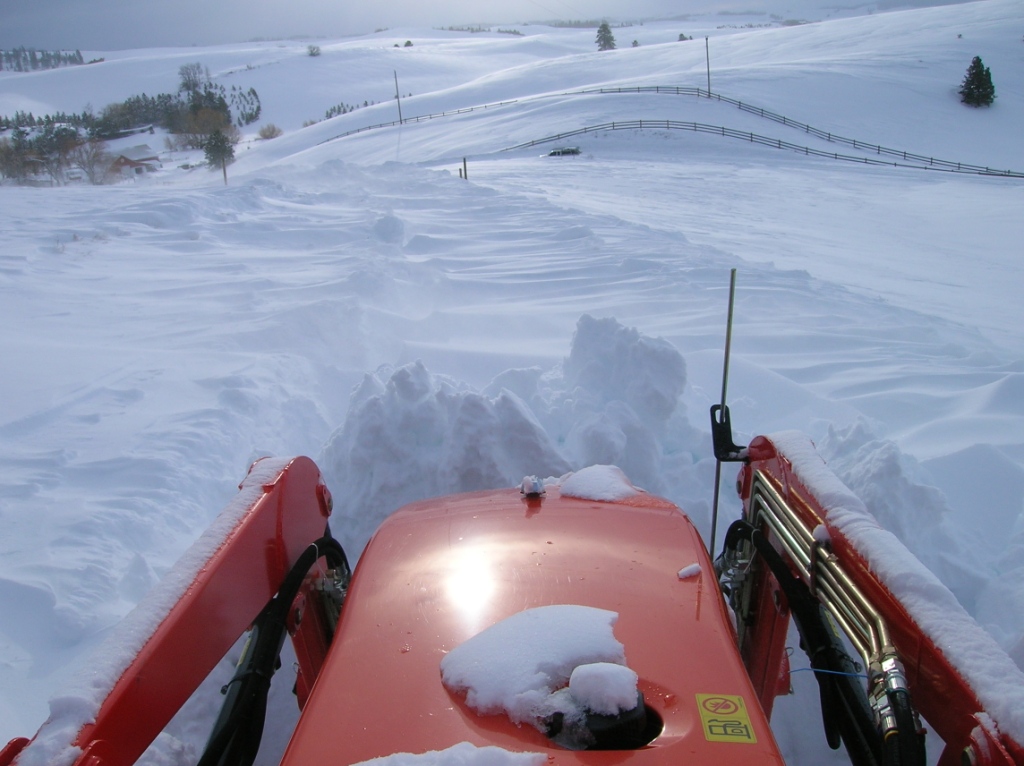

The first picture is the L4400DT and my supervisor.
The second is a shot of a driveway. That section is not too bad ~2-3 feet deep in places. But around the bend it was at least 5-6 feet deep in places. The rear blade was no use. I ended up shoveling out with the bucket.
We are somewhere in the neighborhood of 5-6 feet of actual snowfall this winter, but it has not broken above freezing for any length of time during the last month so it just piles up and then the wind blows it into drifts. In some places the snow is only a few inches thick and then in others it will be many feet thick.

My approach for plowing your driveway/road would be to start pushing with the bucket as far as you can get or until it bogs down with snow piled in front of the bucket. Then carefully bucket the accumulated snow to the side...probably 5 bucketfuls or so, then start back down the drive again until it bogs etc. When you get to the bottom start back up the hill going forward, and when you get to the top, turn around again and start down with the bucket by moving over a few feet left or right and push again.
That's this year.
Next year, three things: put a snow fence on the prevailing side of the drive in the areas that drift the worst a/o plant short evergreen trees as a wind break for the future. two: put some whips every 15 feet or so especially where the drive curves to mark where the drive is. three: get a snow plow mounted on the front of your bucket, either with a quick-connect or other arrangement, to help "cast" the snow to the side. It'll be spring loaded so that if you hit a frozen piece or gravel or some other obstruction the blade will pivot and avoid shock-damaging the loader hydraulics/cylinders etc. From the looks of your excellent pics you need a serious snow plow setup and a simple upgrade from rear chains to front/rear chains is not going to be enough. That pic looks like an 8 or 10 hour chore to clear the snow.

We have had more snow since that picture and more on the way tonight so a set of front chains and stretchers will definitely be key. I suspect the front chains will help significantly with the steering problem I currently have. If I go slow I can get the job done, but it requires some caution and takes a lot of time.
Simonmeridew: All good points. Some bushes and trees to act as a snow fence will definitely help and that is in the works for next year. I am more or less doing what you suggest. My problem is where to put it all and the fact that I have steep ditches on both sides and a narrow road. So pushing the snow to the side is a problem. Also I have to be careful not to get a wheel off into the deep snow that is hiding the ditches.
That is why I think a rear mount blower will be very helpful. But a front blade may be a good investment as well. The good news is that this loader has a quick attach bucket that is bobcat compatible so attaching a front plow should be easy. I had a similar setup on a much large tractor that I use to run and loved it. Pull two levers and the attachmemt pops right off.
