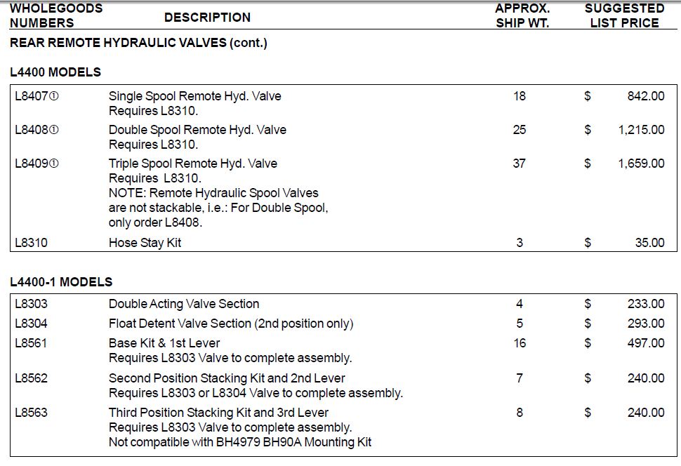

I have a l4400 I would like to add a rear remote dealer wants 900+ parts and labor seems high to me does anyone know about what the parts run and also is it hard to install :D have worked with hydros before on tow trucks
/ L4400 rear remote #2
I too just purchased a new L4400HST and would like to add a rear remote. Does anyone know of a kit so I can install it myself. Want to add a hydralic downforce kit to the PHD.
/ L4400 rear remote #4
My search lead me to the post above and many others and could not find the "factory kit" part numbers. I called around and have been given (2) different kit numbers.
The more confident dealer thought it would be a L8561 base kit and L8303 valve.
I should have gone more indebt to say I am looking for the factory part numbers for a single rear remote to add on to the L4400HST. And any insight on a good online source for the kit parts.

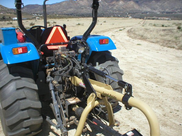

Keep in mind that a hydraulic down force kit for a PHD is a single acting cylinder and you will need a separate return line to your tank. One hose from your rear remote and one hose directly returns to your tank. ;)
/ L4400 rear remote #8
Using a single action cyl, you only use one hose, and plug the B port. The other option is to add a hose to the B port on the valve and run it to tank.

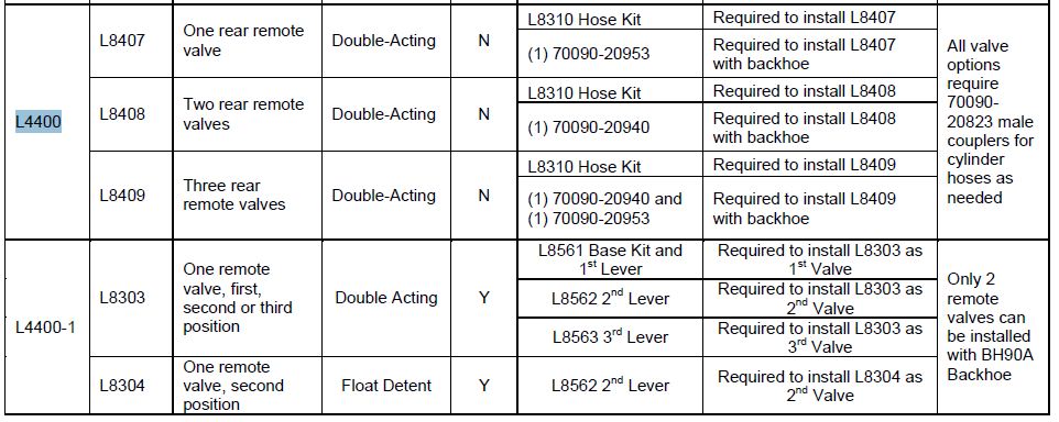

Make sure you are looking at the right parts. From the whole goods list. The Y/N column is labeled stackable.

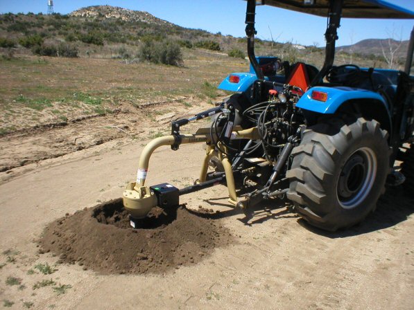

JJ, on a hydraulic down pressure kit for a post hole digger there are 2 hoses. One for the pressure side of the hydraulic and one for the return of the constant flow of hydraulic fluid that can be constantly flowing to the pressure side so as to have a constant even pressure on the auger while digging. I have no doubt that this is actually some sort of safety feature, but none the less it is what the factory down pressure kits have for a PHD. ;) Scroll down to section 4 and diagram 4-6 shows the pressure line and the return line. Sorry for my poor pictures, but when I took those I was not trying to get the hoses for any specific reason.

Thanks, I understand now. They are using the relief valve to allow down pressure of 500 psi on the cyl rod , and any thing over that is relieved to tank. They don't even need down pressure if the ground is soft.

Correct, no need to always use the down pressure, but when you need it it's there and boy does it work great. :thumbsup: One of these days I'm going to hook up the PHD to our crane and weight scale and see how much actual down pressure there actually is.
The PDF files are for the L4400HST-1 series and are stackable to a maximum of 3.
