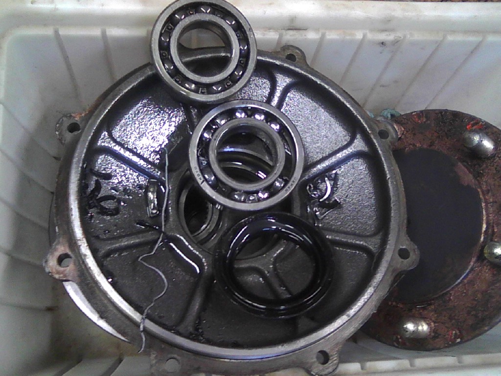

<img src="http://www.tractorbynet.com/forums/files/kubota-owning-operating/387200-l4400-front-axle-leaking-grrrrr-140819_0001-jpg"/>
Well, I'd say it was the bearing!! It took the seal with it, and scratched the heck out of the axle too! I only worked about 2 hours after I noticed the leak. But I must say, it was pretty easy to replace.
Looks like my L3830 failure. I think my seal failed which caused the bearing to fail....

That would be my guess, but we will never know which failed first. I'm just glad the damage was contained between the ring gear and the housing. Otherwise the debris could have made it's way to many more bearings...
   / L4400 front axle leaking. GRRRRR! #15
Good doing Dave - failures like this are pretty uncommon and usually start with a metallurgical defect in the bearing from new. A defective ball starts to break, damaging the race, eventually jamming and shattering, then another fails because the race is rough, the spreader breaks, and on and on until it runs loose enough to make the seal leak. With the bad parts replaced, you could go right back to doing whatever you were doing and it would almost certainly never fail again. Bearings are made in huge numbers and defects are so rare they probably don't even inspect them. Just bad luck to get a bad one.
Unless the seal allowed a contaminet into the bearing, it was probably the other way around. Typically, seals fail (leak) for two reasons. Old age, or a wobble effect due to another part failure.

The metal retaining spring in the seal failed... Separated and ended up getting into the ball bearings causing them to wear out.
