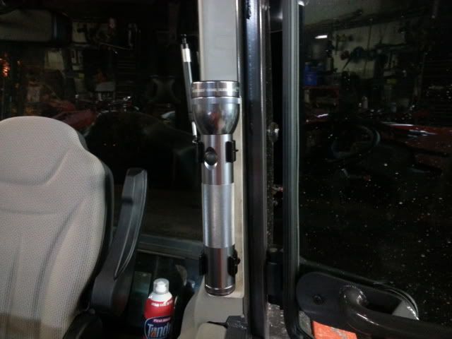

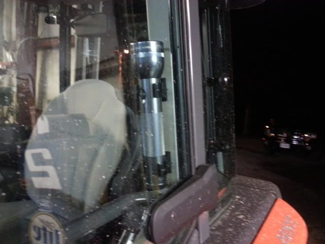

I made a mag lite mount. I mounted the Mag lite mounts to a piece of aluminum. I used 2 exiting holes in the tractor with tread sets and bolted the mount to the tractor. I still may paint the mount.

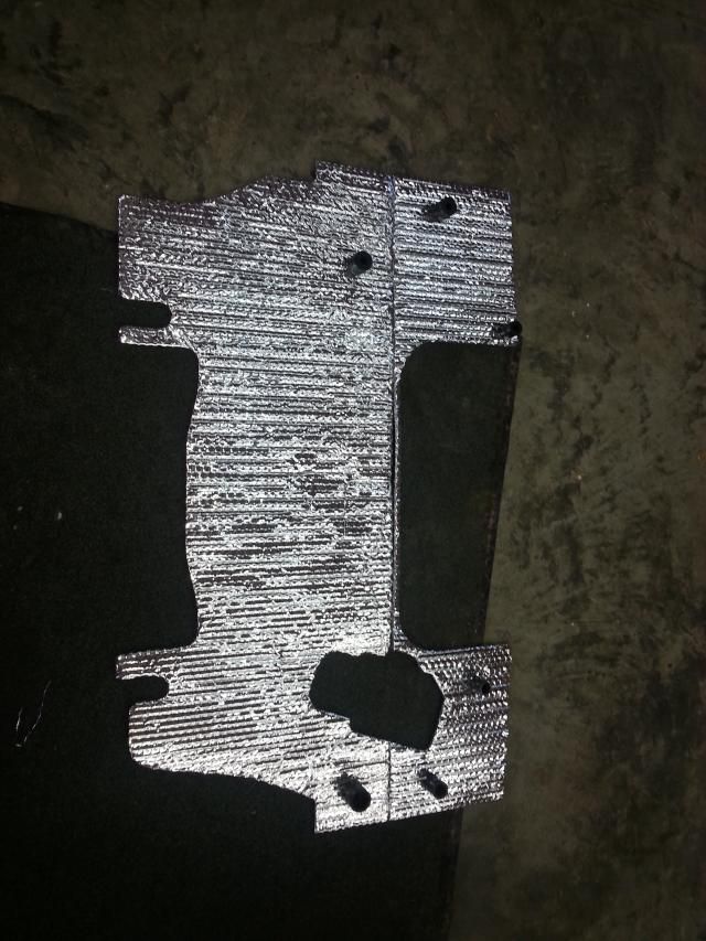

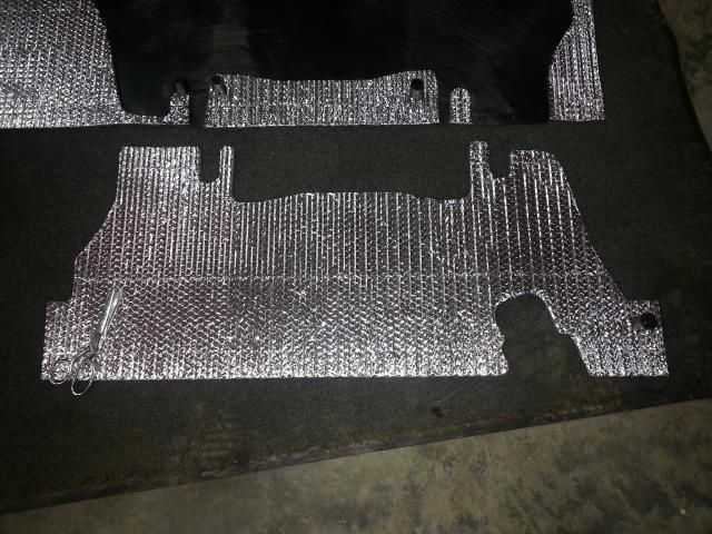

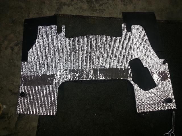

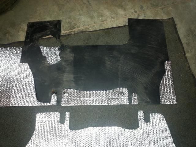

I was telling Scooby074 that I wanted to insulated the tractor. He suggested using foil insulation. I did some research and found that people had been using it on their car when they upgrade the stereo. I got some Reflectix double reflective insulation. It is available at Lowes. So far I have only added Reflectix to the floor and roof. I am hoping it will help keep some heat out. So far it seems like it has helped but I need to use the tractor some more to be sure.
First half cut out. I laid the scraps agianst the rubber mat to see how good the fit was.
Cutting out second half.
Second half cut out, getting ready to tape together.

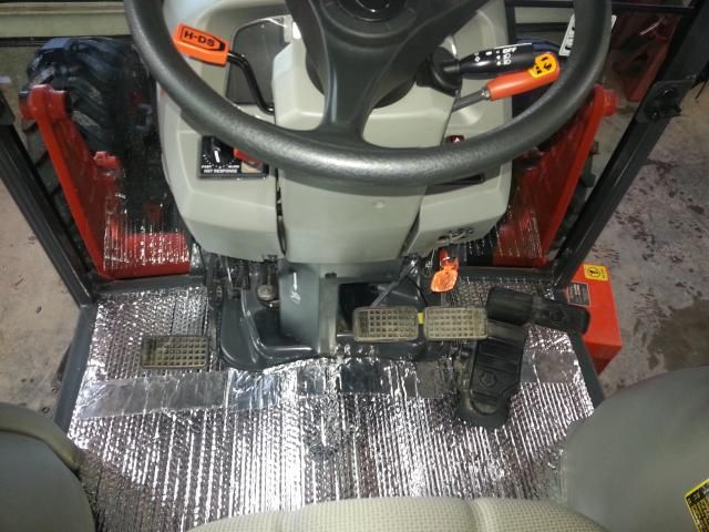

Taped together.

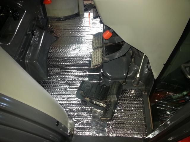

Installed in tractor.
The cab top.

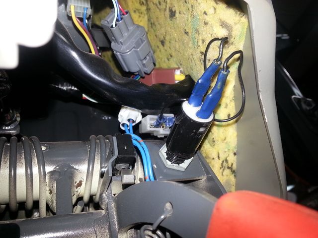

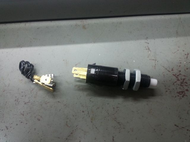

The Kubota L40 tractors (maybe all Kubotas) sold in North America do not have brake lights. They are wired for brake lights and have double filament bulbs, they just do not have a stop light switch under the dash. I got a stop light switch for a 1978 Ford F-150. It fits right in place where the switch should be.
Here is the switch, it came with the wiring.
Here it is installed.
Now I have the first Kubota L40 tractor in North America with brake lights:cool:
