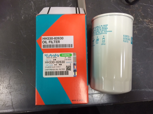

Kubota dealer says that the 36330-82630 and HH330-86230 are the same just an updated sku.
They may be the same, or it may be an error (I show the HH330-86230 to be for a different tractor - mainly M Series). I will look into it a little bit more and get back to you. Maybe my parts guy knows something.
   / L3750 Hydraulic Filter. Need expert help! #14

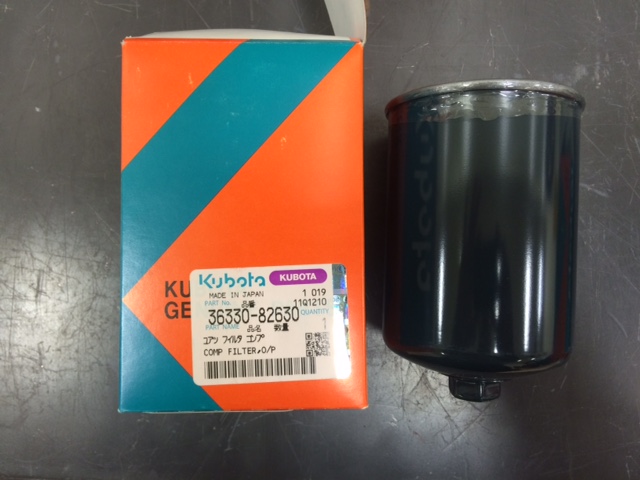

These are different filters. The "HH" filter is larger with a larger diameter thread on it. There must be an issue with the suppression in Kubota parts program. Have the dealer order the exact 36330-82630. IMG_1223 (2).jpgIMG_1224 (1).jpgIMG_1225 (2).jpg

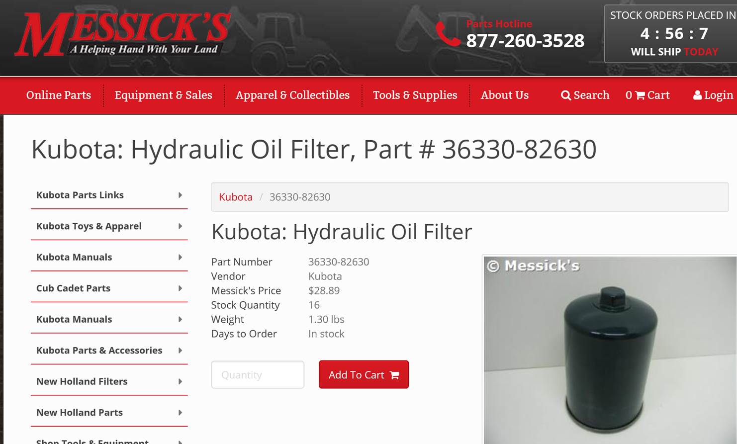

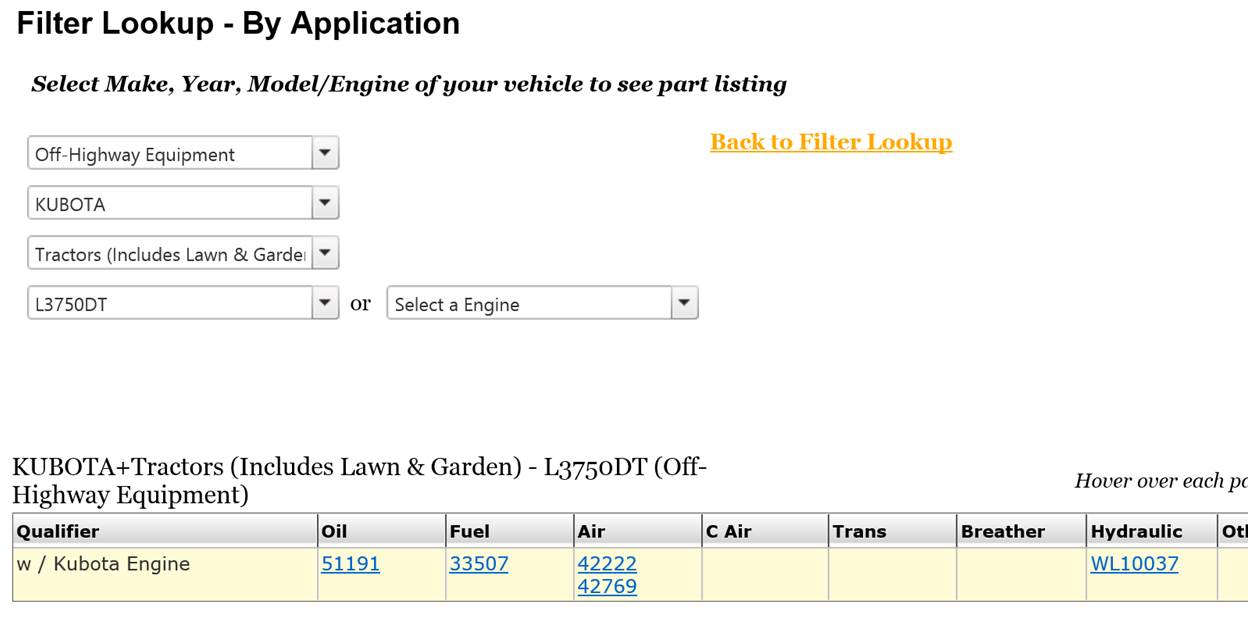

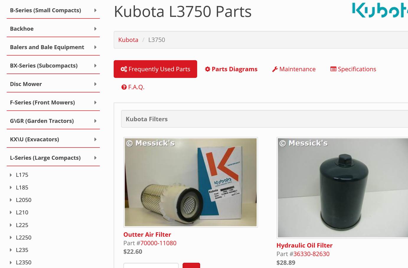

Using Messick's it is fairly easy to check part numbers. Please keep in mind I'm not certain if this is a L3750, L3750DT or L3750F. Using the "frequently used parts" L3750DT the following appear. It indicates 36330-82630 is the correct part number.

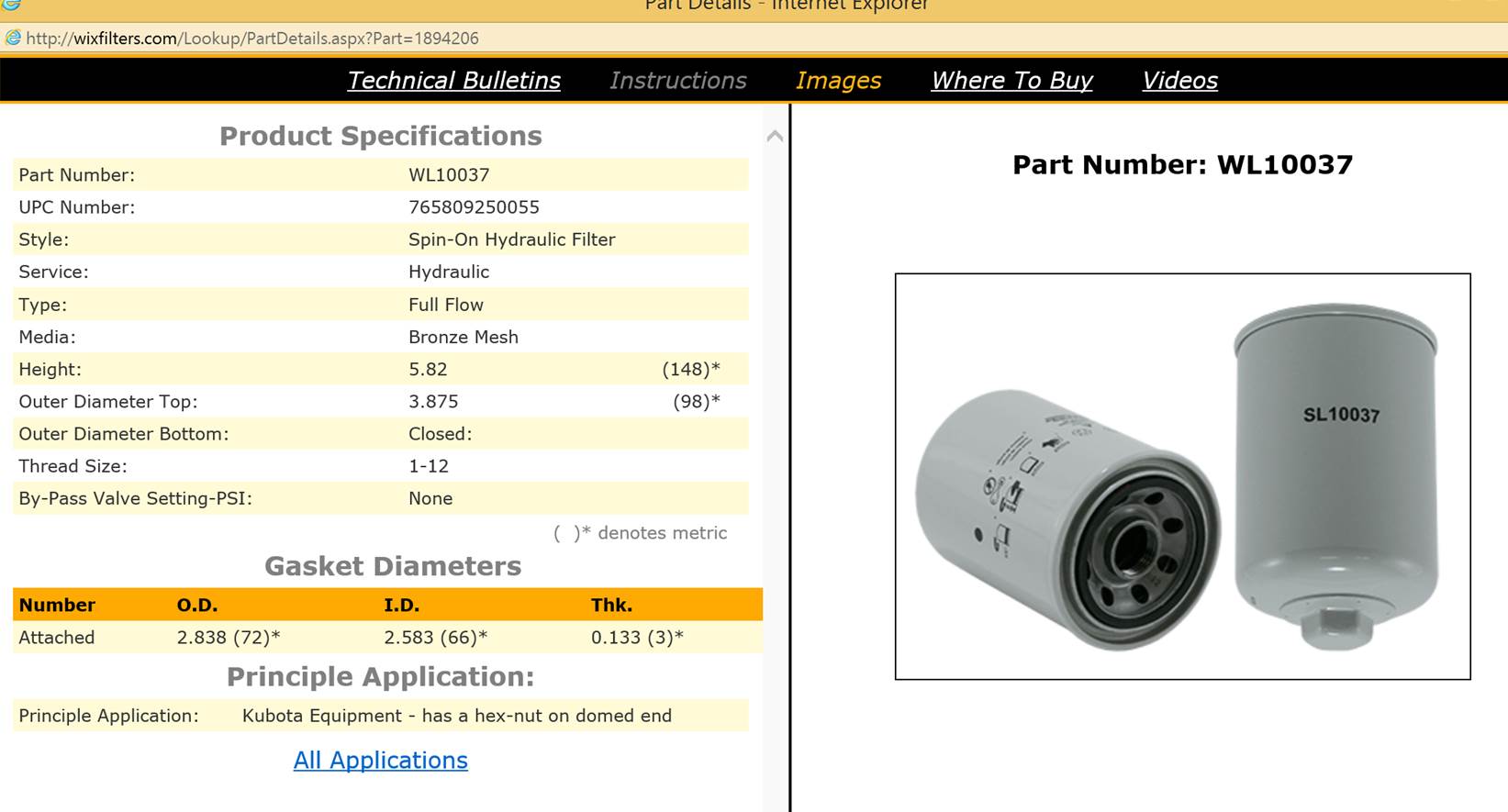

If you're interested in the WIX equivalents...
Details of the hydraulic filter:
View attachment 458334 and View attachment 458338
Thanks Moship and Texas Fella and all of you guys that helped. My manual and the Kubota website all said the filter was 36330-82630. 2 different dealers said that the SKU was changed to HH330-82630 which is of course the wrong filter. I went to dealer number 3 and got the 36330-82630 in today and it works great. Imagine that. Striking it up to uneducated parts guys and me not knowing any better. Thanks for all you help! you guys are great!
