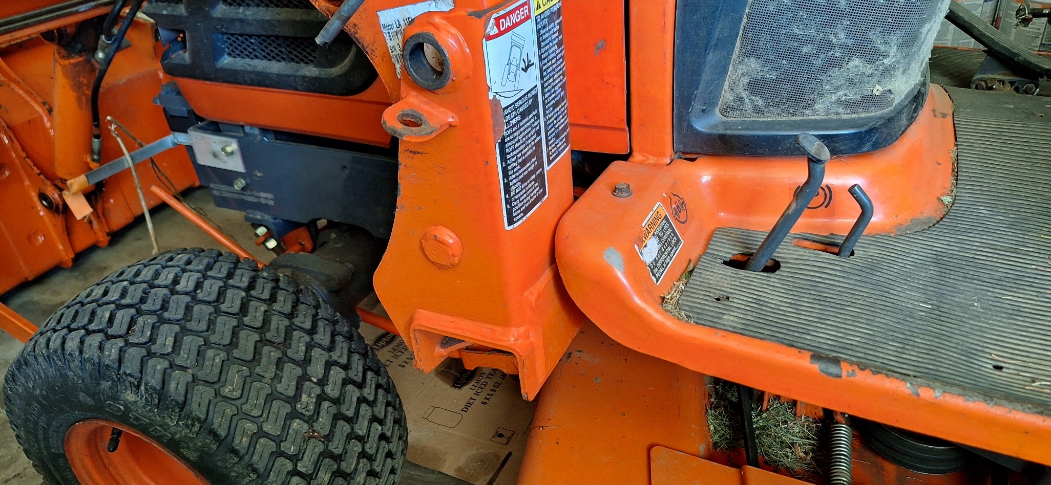

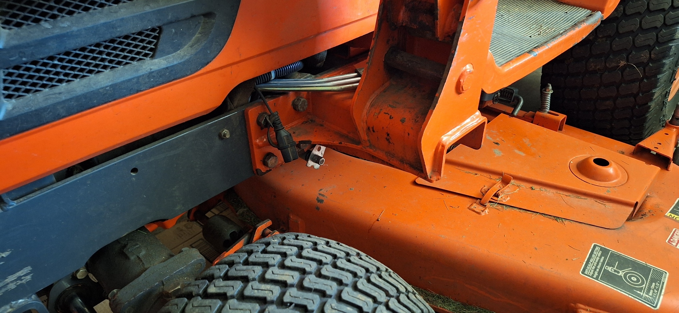

This is what I did when I owned a BX, it’s a Racor filter. It’s about the only place to mount it. It takes the place of the small filter at the back of the tractor, I left the small filter in place by the engine. So to keep it before the lift pump I ran a line all the way up to where the Racor is located then all the way back to where the lift pump is. Not quite as complicated as it sounds.

I’m a little confused on the lines you are talking about. Return lines should have nothing to do with it. Imagine if you could take the rear filter out and just put the new one in. There is a line going in to the new filter and one going out. Nothing else needed. You obviously can’t do this because there isn’t room for a bigger filter in the original location.
Trust me, the best place is where I show it my picture above. I tried some other places there just isn’t a better one. There have been several other people that have done this if you do a search.

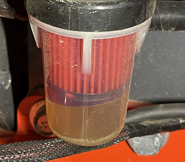

I prefer the clear bowl with the red plastic ring that floats on water that accumulates.

On edit... in response to TSHEP's question.....I found this picture online - both my JD 790 and L4790 came with this type of filter. The filter itself presses on to a stub on the top of the housing and is held in place by friction. The bowl is removed by the pot metal threaded collar. The file photo above shows the bottom of the bowl full of water and the plastic float ring pushing against the bottom of the filter cartridge.
I've had good luck treating diesel with Stanadyne Performance Plus treatment; it disperses water into suspension and is consumed with the diesel. I never have any water to drain from pickup (7.3 IDI) or the two tractors. Water droplets in the fuel rather than accumulating in bowls causes no injector or fuel system damage.

I don’t think there is a vent on the Racor but I’m not sure. BX’s are self bleeding so if it is a vent I never used it. The Racor is setup so you can plumb it in different ways so there are more openings than you need, the extras are just plugged.
