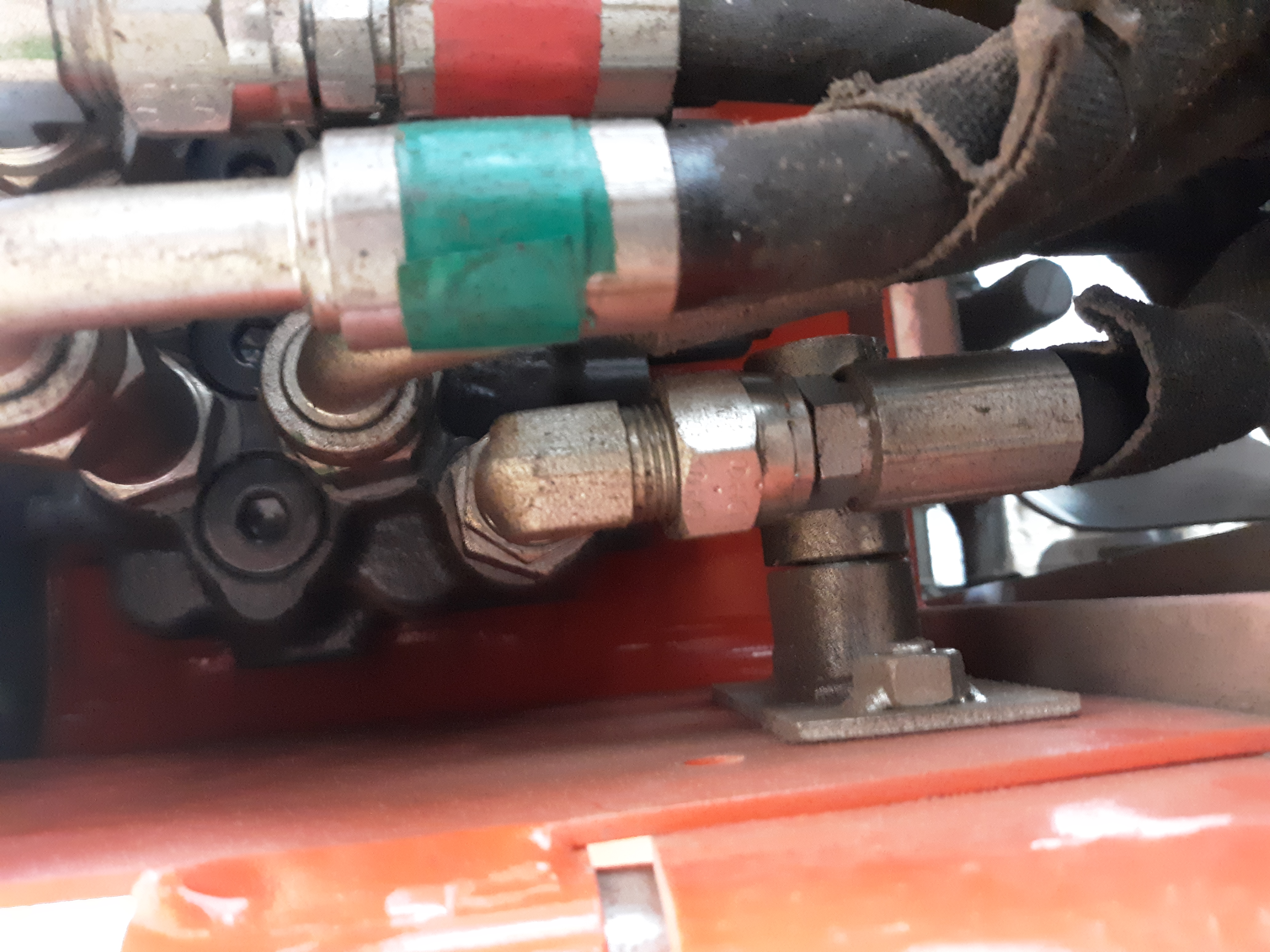

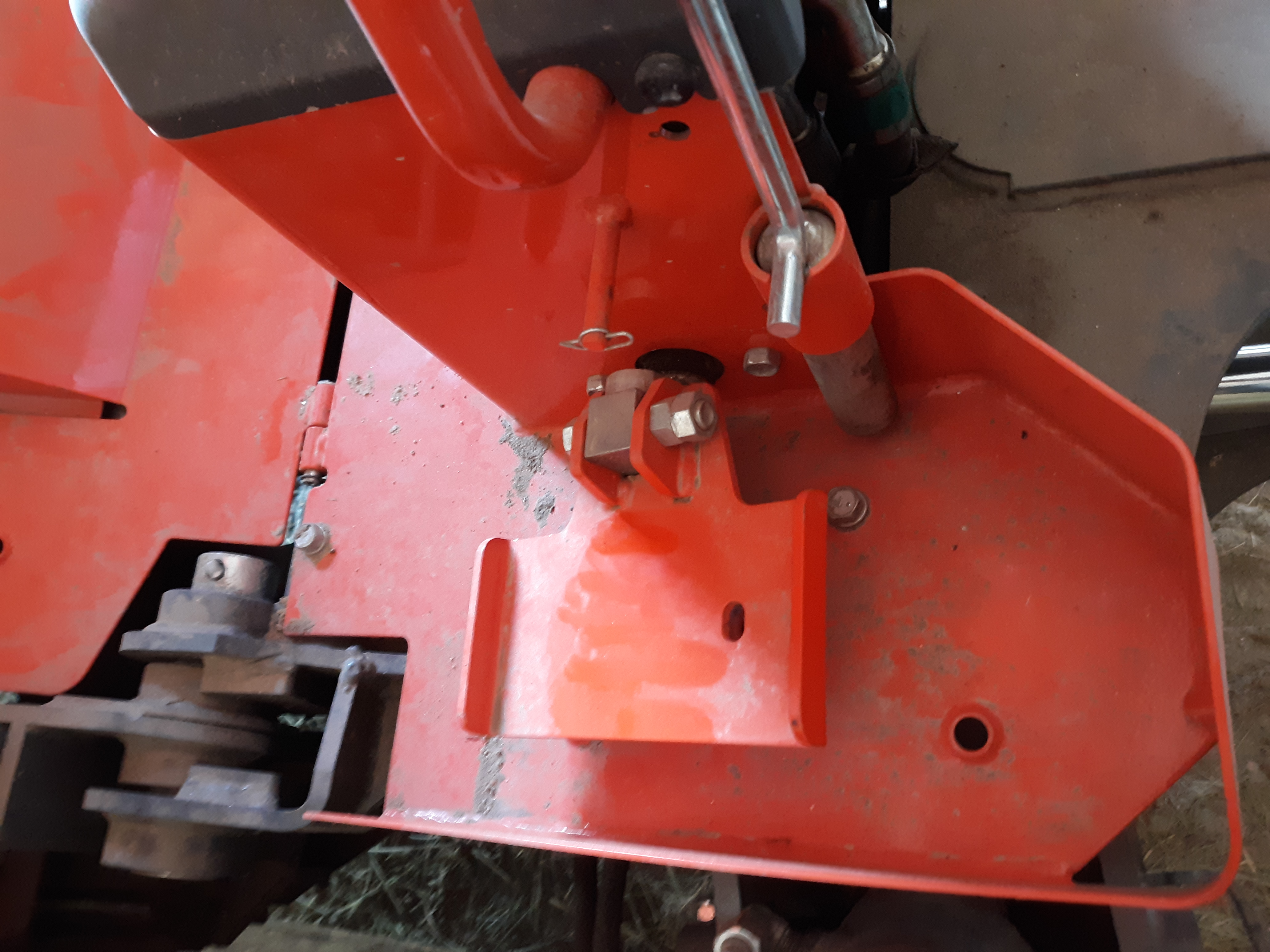

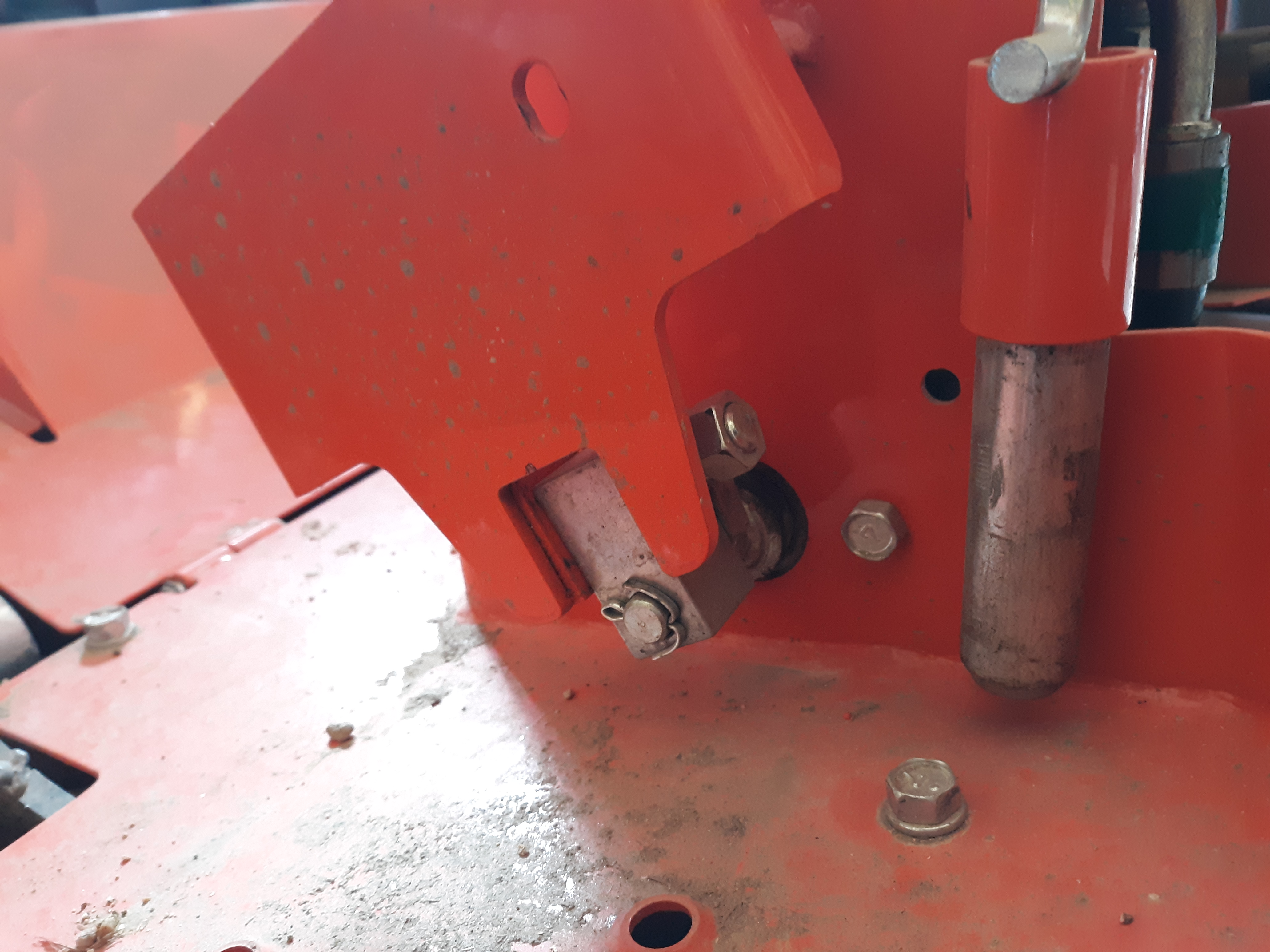

Looking to add a thumb to my L3710. Prefer hydraulic, but a manual one is fine. I've got a Hobart 180 220v welder on mixed gas, so I'm fine with welding.
The Woods9000 backhoe runs off its own hydraulics from the rear PTO. Where would I be tying into to get the thumb going? I'm going to have to get another lever, correct? I understand about 10% of hydraulics. I did setup the 3rd function on the front to angle the snow plow from EA and that's about it. There a kit or anything that I could get to tie into the hydraulics? I'm thinking I'm going to have to go with a manual kit.

Kubota uses a foot lever to activate the valve for the thumb ,Yes you need a valve and tie it in with the rest of them..........

Thanks for the pics. That off your L3800?
It almost looks like I'll have to go with a manual though. Unless there's a kit of some sort which I'm not finding.
