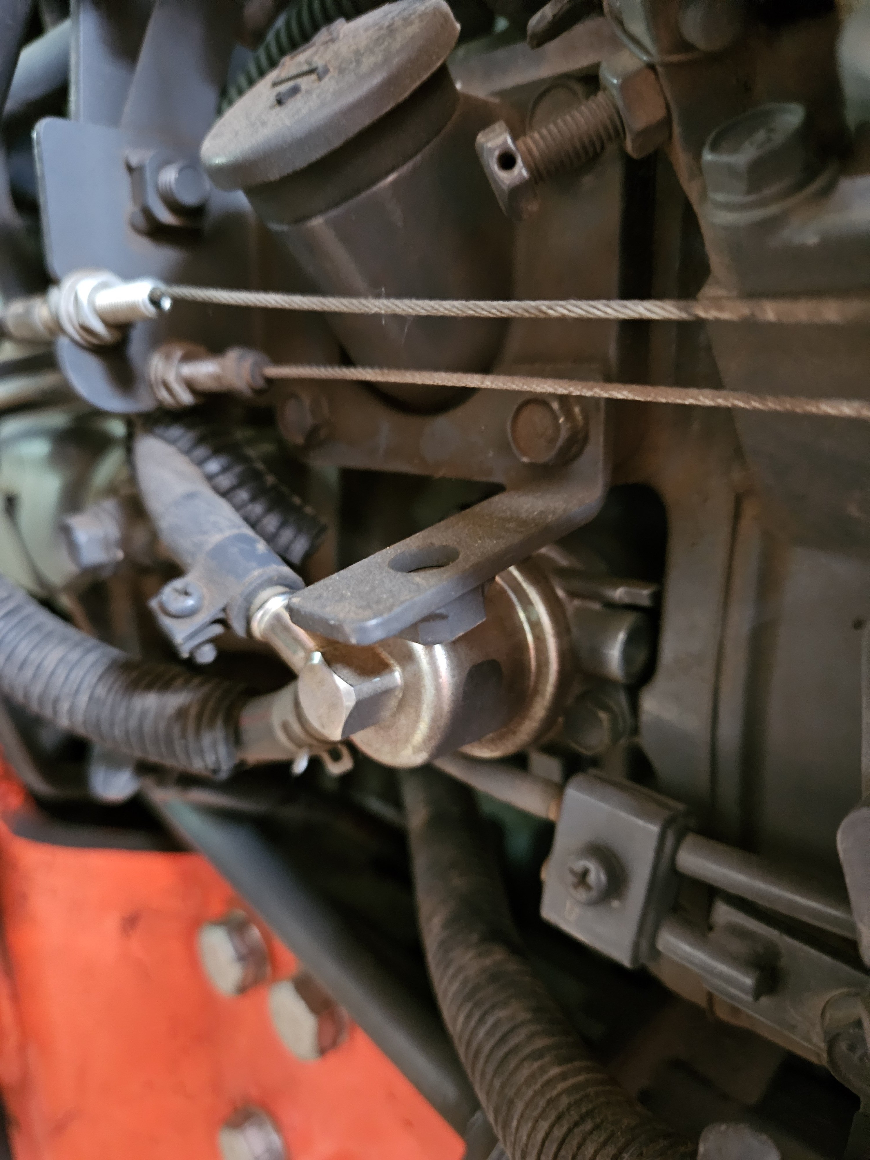

This is what my mechanic changed when my L3540HSTC-3 wouldn't start a few years ago. My friend found one on the
internet for $35 or so, but I was in a hurry and had already ordered one from Messick's, maybe a $100 or so.

Thats mounted directly to the engine?

I stand corrected, sorry for spreading mis-information about the 40 series on the forum. we do indeed have a lift pump. I was not expecting to see a mechanical pump on the injection pump. that pump is now 210$ CAD. so about 145 USD

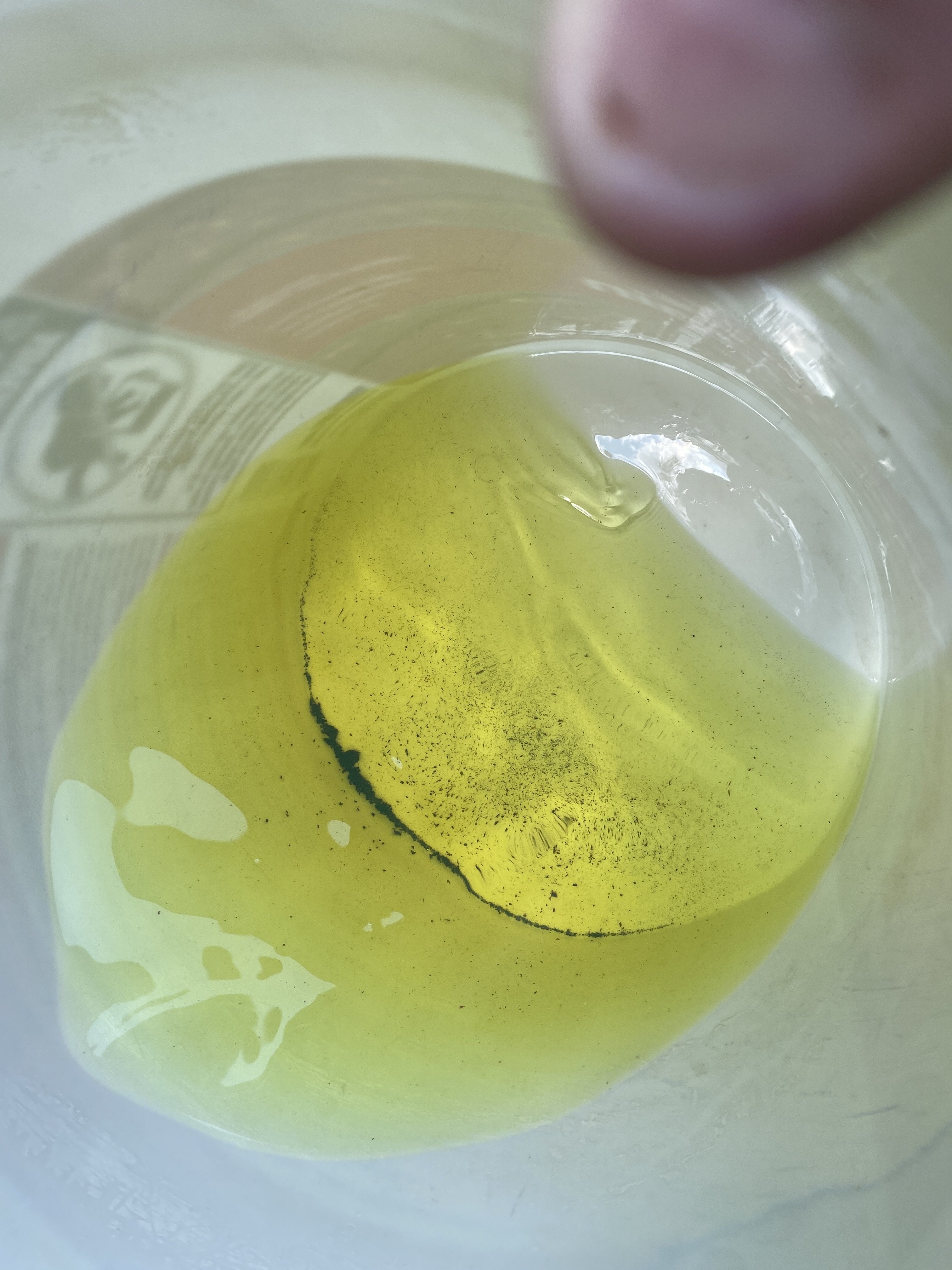

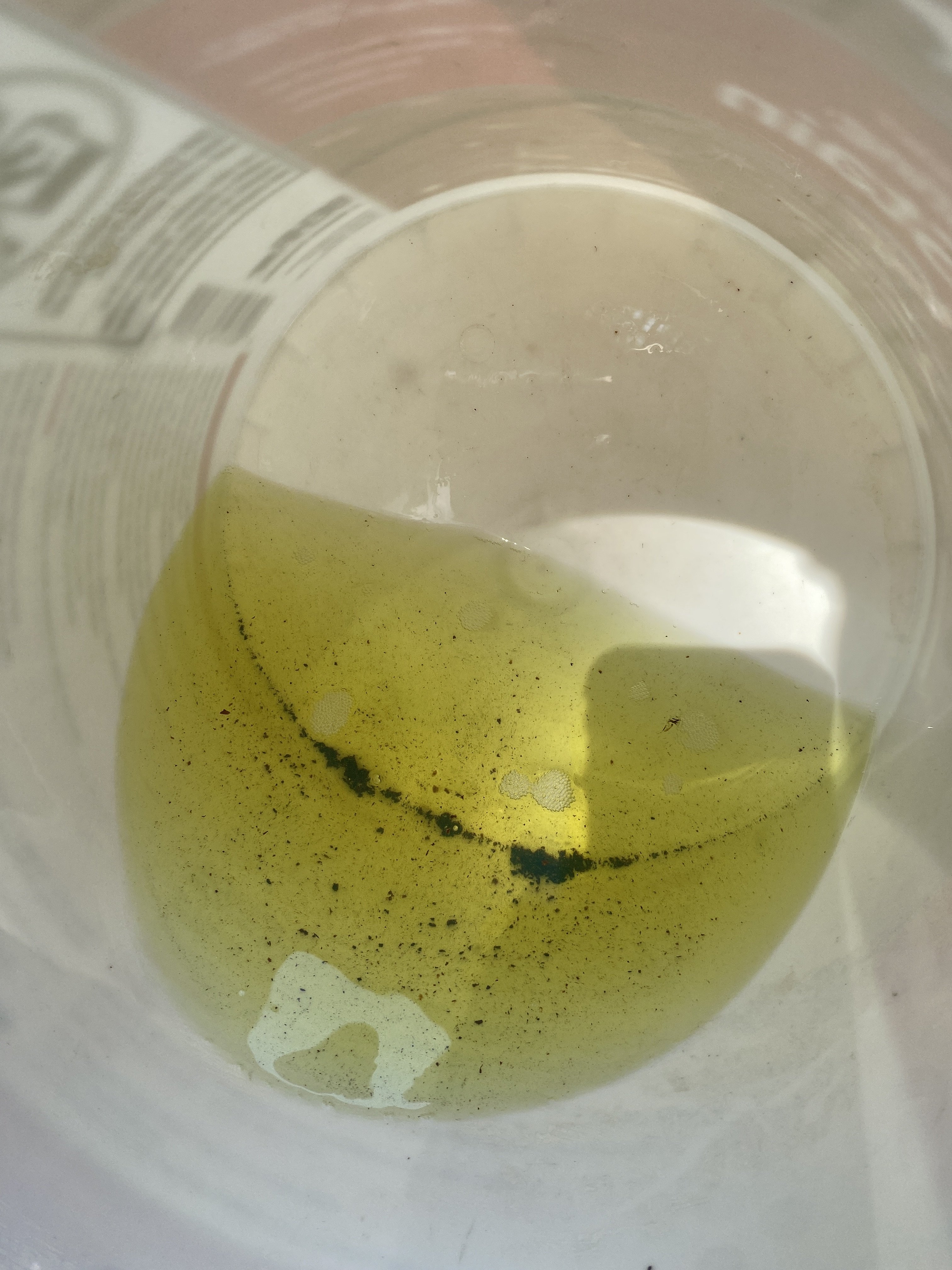

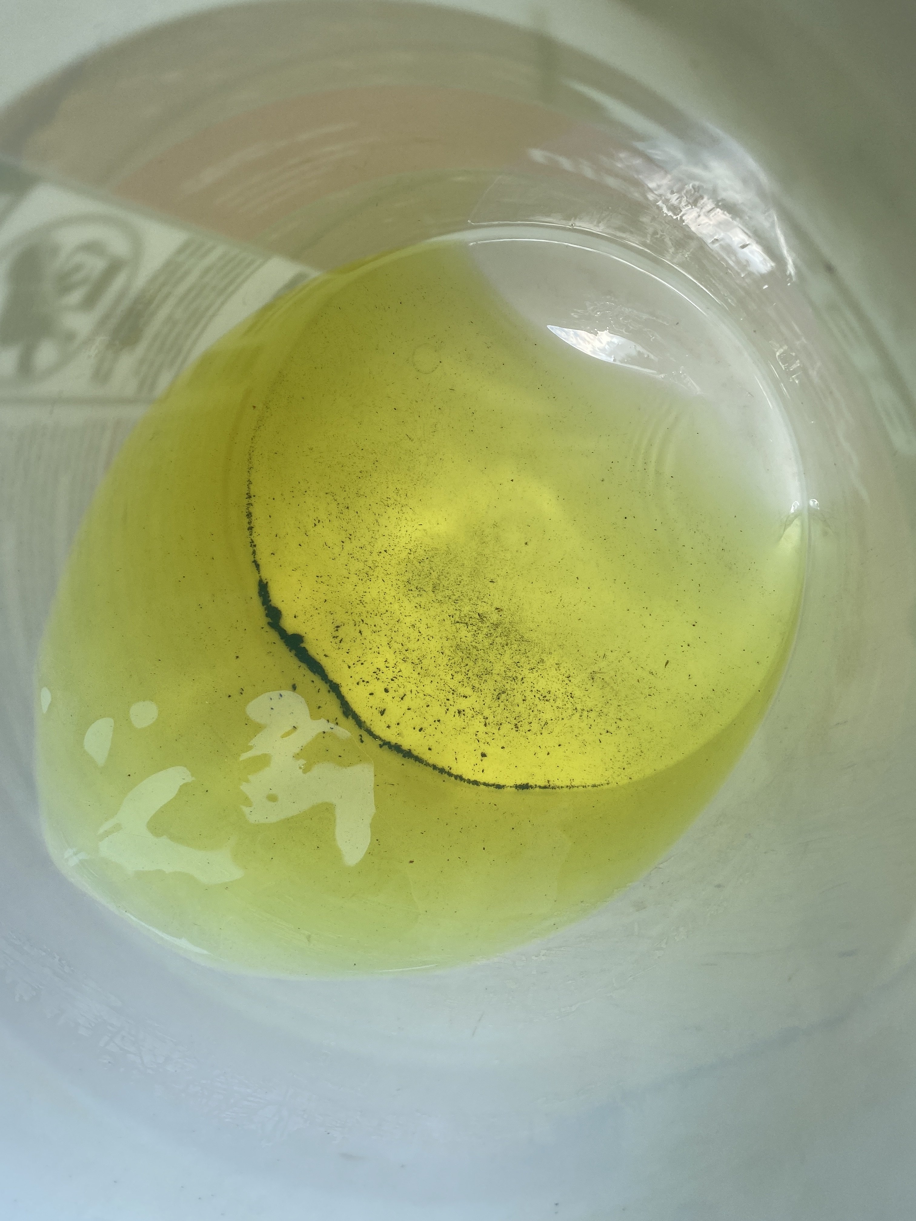

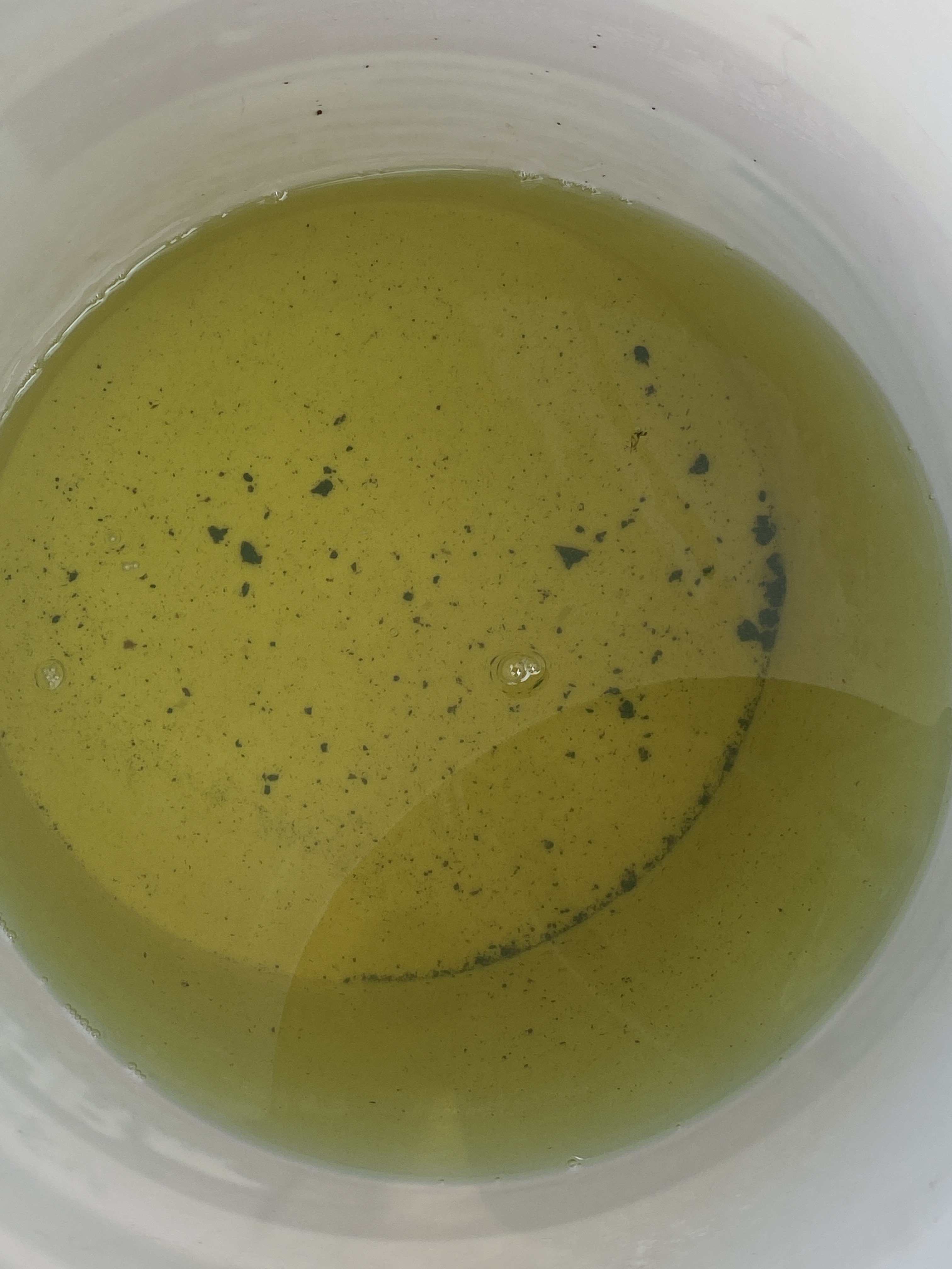

So an update on this:
I bought a diesel transfer pump/kit from amazon. Worked great getting stuff out of my tank (see pics) BUT, still doing the same thing, flat level land or downhill motor just cooks right along, as soon as I turn uphill the rpms just drop off! Of I’m running 540-550 it will drop off to maybe 500 rpms or so!!!
