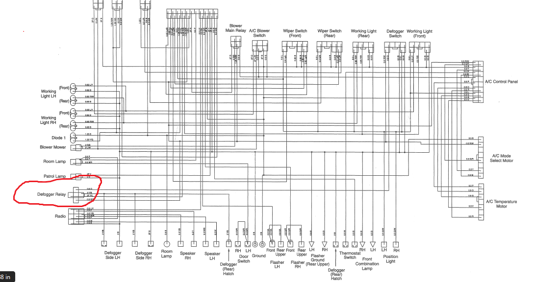

I have a L3540 Cab tractor with the electric defrost in the rear and corner glass. The tractor is used for snowblowing, and often times the snow is blowing back on you so the heated glass is a must to keep the snow melted and keep it for fogging up inside. The problem is that the power switch has a built in timer, so about every ten minutes it shuts off automatically, and I don't notice it until it starts fogging up on the inside. I suspect a regular switch could be used that would keep it on until it was shut off. Any problem with doing this, and what amp rating would I need on the switch?

BTW there is a defogger relay which may have the timer in it instead of the switch. It wasn't noted in the schematic that there even was a timer, though there obviously is somewhere. Not sure, but I agree it would be nice to have it at least run a longer cycle, as it is too short.

I am in the tractor for six to eight hours after a storm doing residential driveways, and sometimes the snow has to be blown into the wind, and that is when the glass gets covered with a lot of snow. The fogging may not be as bad in warmer weather, but when it is quite cold out the defrost is a must for me. I have a B3030HSDC and the defrost stays on until it is shut off. (Just thinking to myself, I should check to see if it has the same profile as the L3540.....that switch may work in the L3540.....) I asked the service manager at my dealer and he said the timer is built into the switch on the L3540. I thought maybe it could be unplugged but that isn't an option.

3540 fog relay.pngI would assume the timer is built into the relay not the switch as with most Japanese designed automotive electrical systems from the 80s-90s. The relay part number is 3F740-75030. Chances are if you pull the roof off and trace the wiring from the defogger switch you will find the relay right near the switch itself. I can't find a picture of the relay but there are 4 wires going to it and chances are it can be replaced with a simple relay of the correct amperage that would stay on with the switch operation. If I had a picture of the connector I could recommend one that would work for you.

View attachment 362008I would assume the timer is built into the relay not the switch as with most Japanese designed automotive electrical systems from the 80s-90s. The relay part number is 3F740-75030. Chances are if you pull the roof off and trace the wiring from the defogger switch you will find the relay right near the switch itself. I can't find a picture of the relay but there are 4 wires going to it and chances are it can be replaced with a simple relay of the correct amperage that would stay on with the switch operation. If I had a picture of the connector I could recommend one that would work for you.
