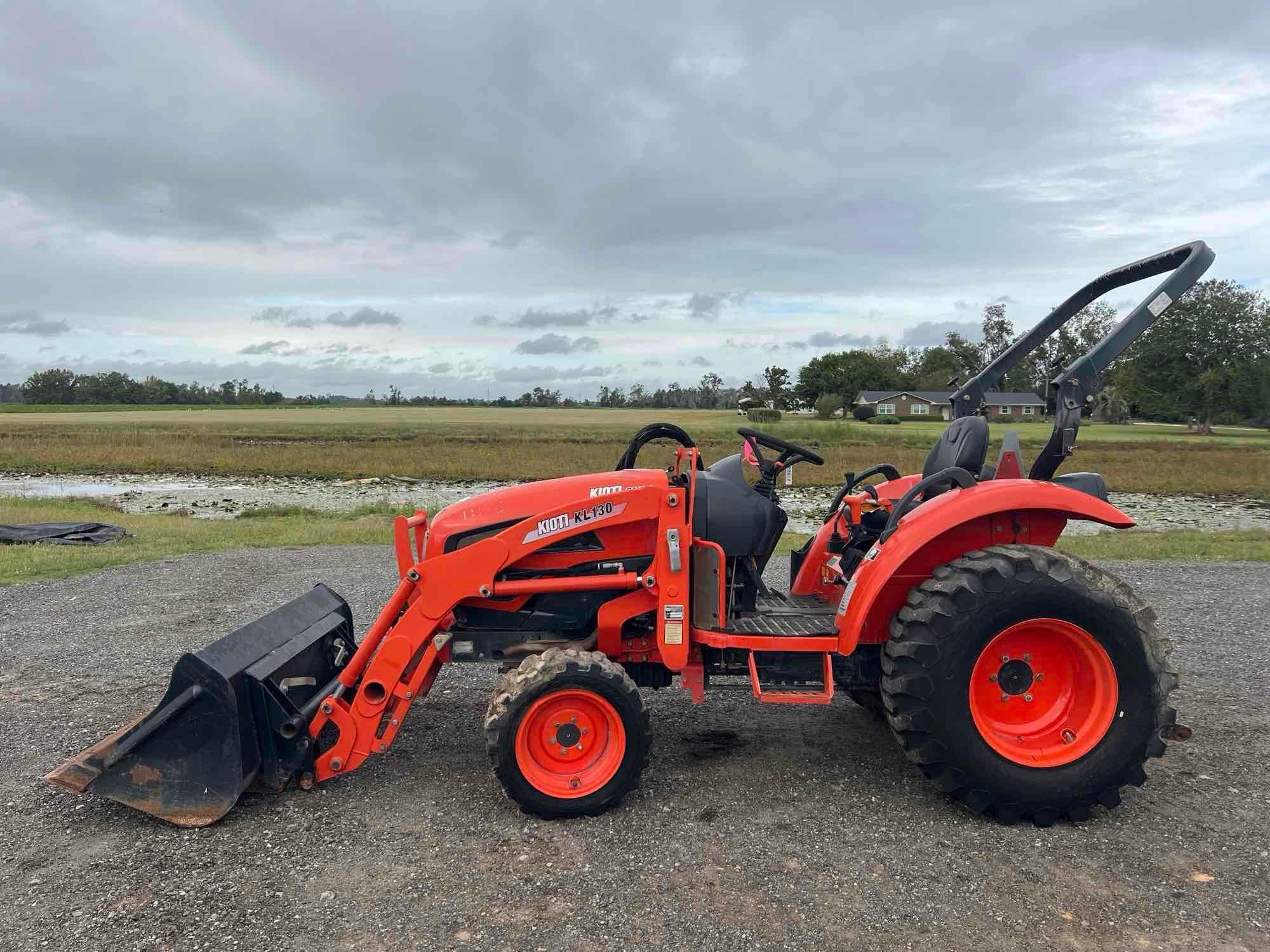

Found a pic of her online.

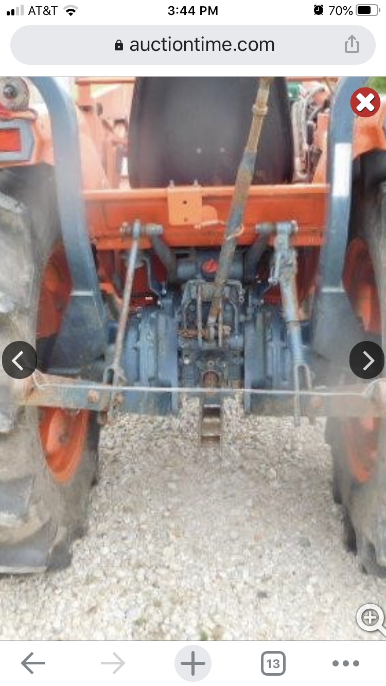

I found this photo of what is called an L3250. It is an open station model, but...
From this photo, can you mark what tab you are referring to?
Take a screen shot and then mark it if you can ID it in this!
You are a legend..have been looking for a shot of the rear for a while now, i would imagine the rear is the same on open station..it looks it from my memory, just remember thinking its a shame the tab was not on the brake casing as it would be a cheap easy fix. Thanks ever so much for the help. IMG_76059.jpg

You can get the part and replace it with a tear down of the rear axle assy but this is not cheap nor easy fix. It sounds like they have fabbed something up already into the hitch plate that may be OK.
I would look at welding the cast iron, then making a U shaped plate between the left and right lower lift arm points, and installing longer pins. If you are set on buying this - maybe run it like it is and see what happens.
The hours are high, but if it runs well, its got a 1000 hours or more left, at the price of a lawnmower.
/ L3250 snapped lift arm tab #13
I guess I learned to cheat on finding photos a long time ago. When looking for display type photos, I go to auction sites. The cheat is years ago, my das was an auctioneer and even them in big items that he would we would take photos and send photocopies out to people who expressed an interest.
When I found that photo, that part is what I feared was broken in looking. While it could be replaced, my guess is that this is not an unbolt and install a new part. (I could not see that much detail in the photo.) My guess is that it is a portion of the cast of the housing. Normally, I would suggest a welder (he needs to know his stuff as there are processes to adhere to for welding cast) but I fear that the broken off piece may be history. And this area will receive a lot of pressure from normal hitch use.
If it is part of the cast of the housing, between expense of the housing, even if you found one scrape from a scrape tractor and feel comfortable changing everything out yourself, you will still be into the tractor for more than you could buy an open station of the same HP in my opinion. Lots of work and seals bearings and such that I would want to replace as I switched axles from one housing to a different housing.
