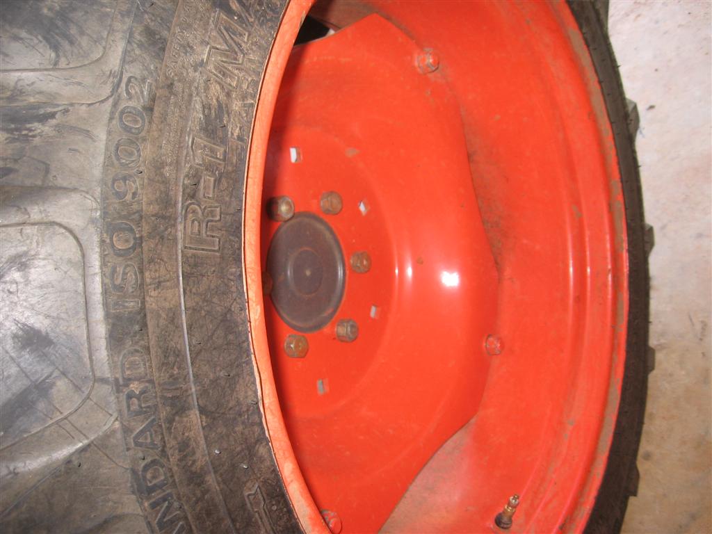

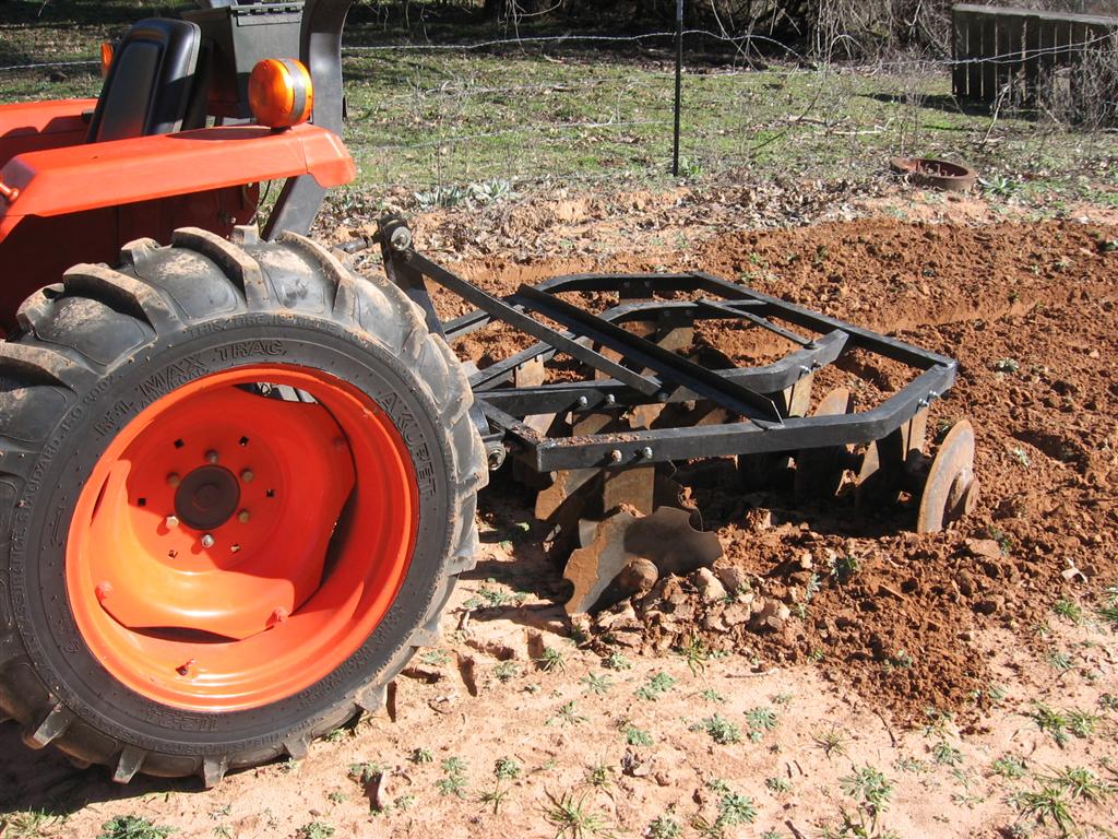

/ L2800 Adjust Tire Width #11
It's really not that bad. There are 4 position/combos you have. 2 positions involve flipping the inner rim or disk. The other 2 are to bolt the tire rim to the disk on the inside or the outside. My L2500 manual doesn't clearly show the flipping of the disk in the pictures.
The tires are not that hard to move around, just keep them upright and balanced.
You will need some 1/2" drive tools to remove the nuts and bolts. The rears get tightened to 160ftlbs. Get a buddy to help you.
Good Luck,
Rob
PS, if you look at this picture, you can see my disk is flipped out, but the tire rim is bolted to the INSIDE of the disk. I could actually gain a little more width if I moved the tire rim to the outside of the disk. I would not have to swap the tires to do this. It's on my to do list. :D

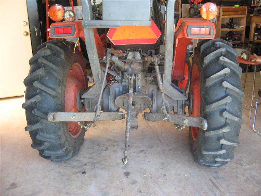

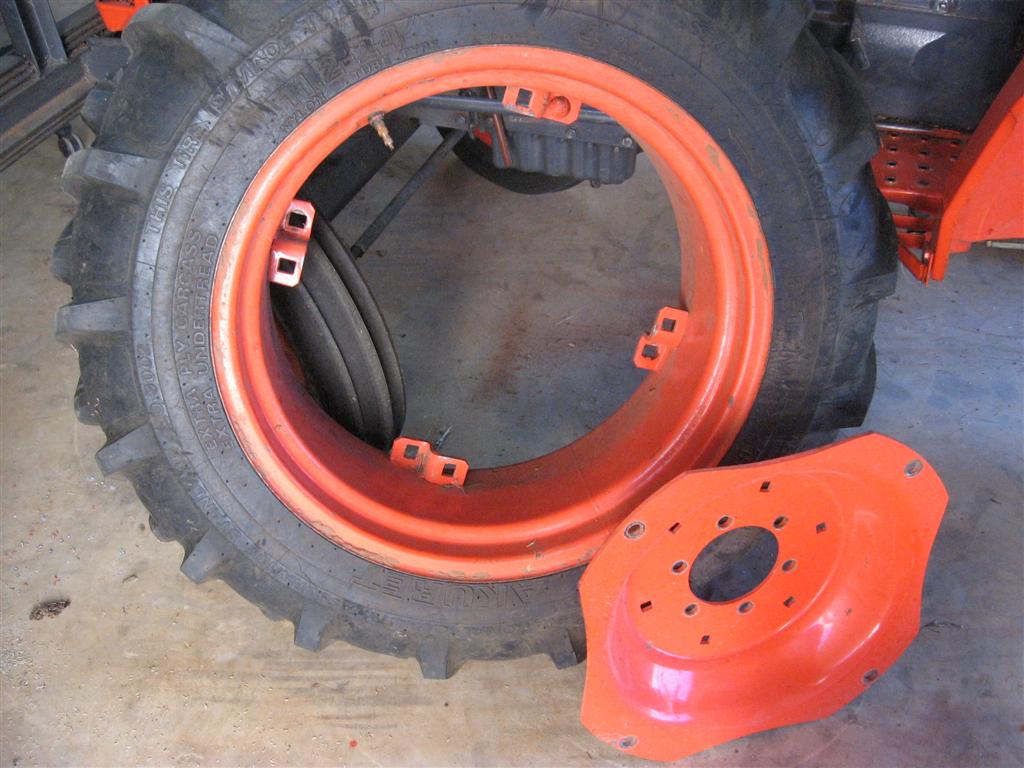

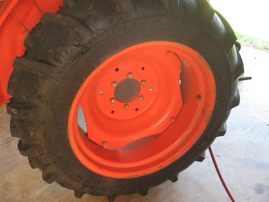

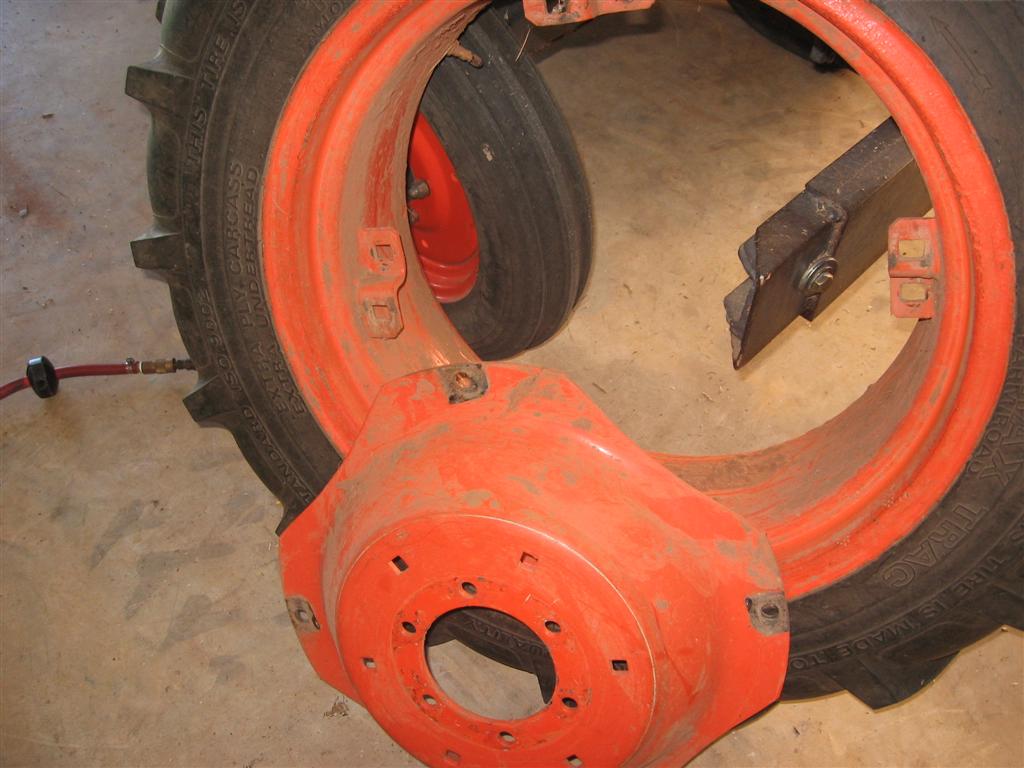

/ L2800 Adjust Tire Width #16
Since nylla brought up the tire width and I needed to carry mine out all the way, here are some pics. I think you can see what is going on withmoving the disk in more and moving to the new position.
Pretty easy, impact wrench makes it easier.
BTW, it seems a whole lot wider, but it's only 3", 1.5" per side. And a quick check with the tape and I'm right at spec....about 50" to the center.
