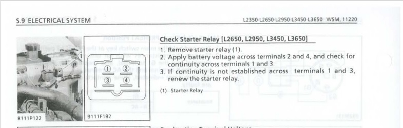

Jan 16, 2022 / L2650 start relay #5 D Dave M7040 Elite Member Joined Dec 10, 2012 Messages 2,757 Location Williamstown Ontario Canada Tractor Kubota M7040 Nuffield 465 Here is the WSM method for checking the start relay. Dave M7040
