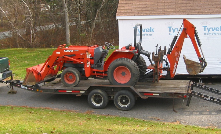

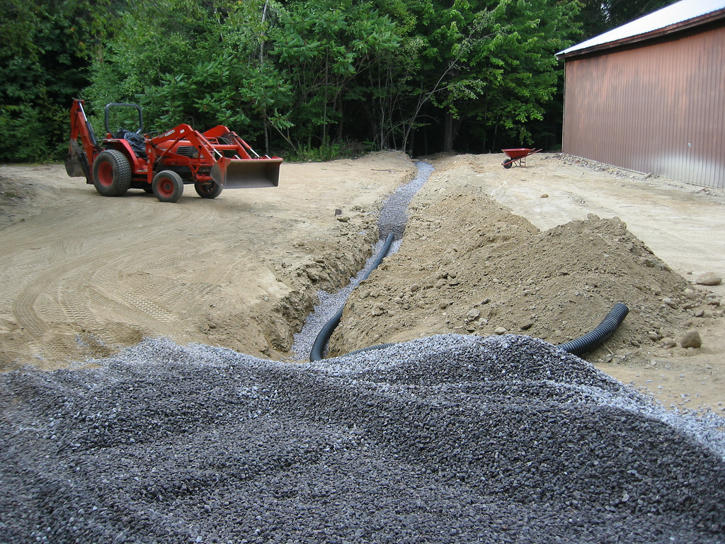

Yes. Find your nearest BX and run it over. L's rule. My L4200 had 2000 hours on it when I got it. Now it has 2700 hours - I had to replace the starter, and that's all I've had to do for it in the 10 years I've owned it. In the meantime, I've done no less than $50,000 worth of work on my own properties with it.
