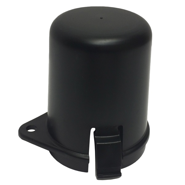

So here we go, after 12-15 years of owning this tractor since new, I've never removed the cap covering the rear pto. Now I need to, and..... what the devil holds this thing on? Besides factory paint. Is there a clip, does it need to be twisted, if so, which way, or does it "just" pull off?
I'd like to know what I'm trying to loosen before I break something in the process of learning. (Been there, done that, many times) I've looked through both the owners and service manual, and, nothing. Just says keep the cap on when pto isn't being used, but what holds it on? It's an open, unanswered question.

It should have a 37410-63112 cap on the rear PTO. There might be a bolt holding it on although the parts diagram does not show one. You will need to depress the two clips on the sides to get the cap to release.

Well that was embarrassing to say the least.
With a visual in mind, I saw the tab for the first time, depressed it with my thumb, and it fell off in my hand. While I did do the manual lookup thing, it never occurred to me do a part number lookup for a picture, something I've done many times in the past, both for myself and an aid for others. Thus, doubly embarrassed.
All those years on the farm, with all those tractors, all those decades ago, didn't prepare me for so many "safety" features. And good gosh, that thing is SHORT. Nothing like I remember.
