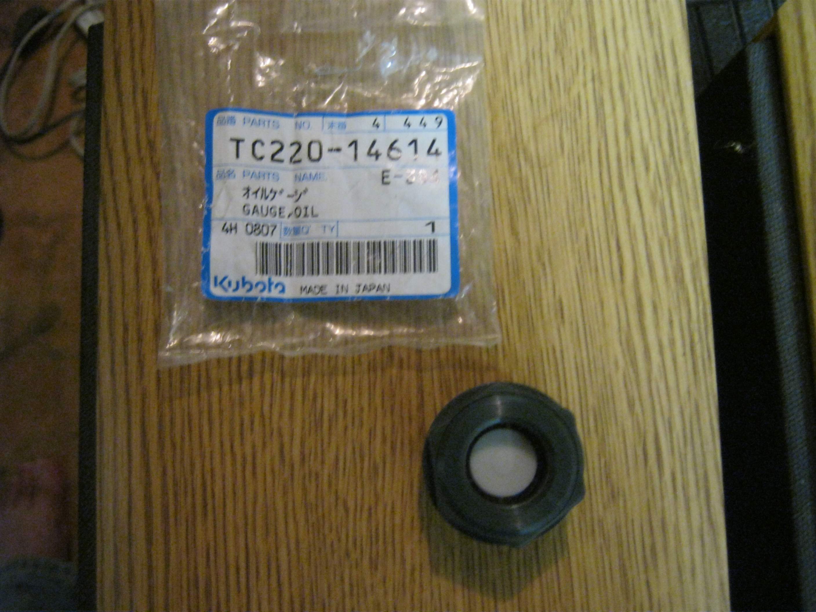

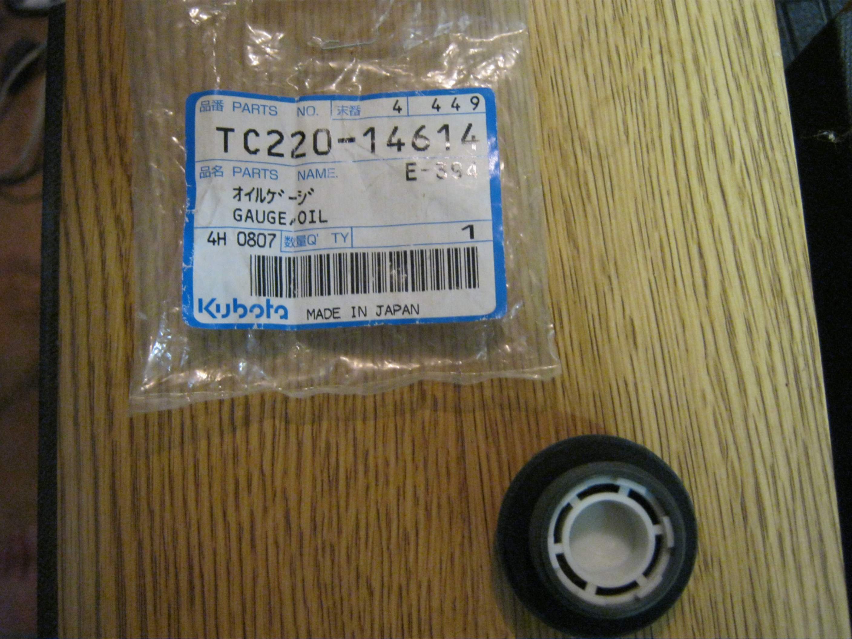

On the L3400 never had to replace mine yet but do keep a spare one (site glass).
