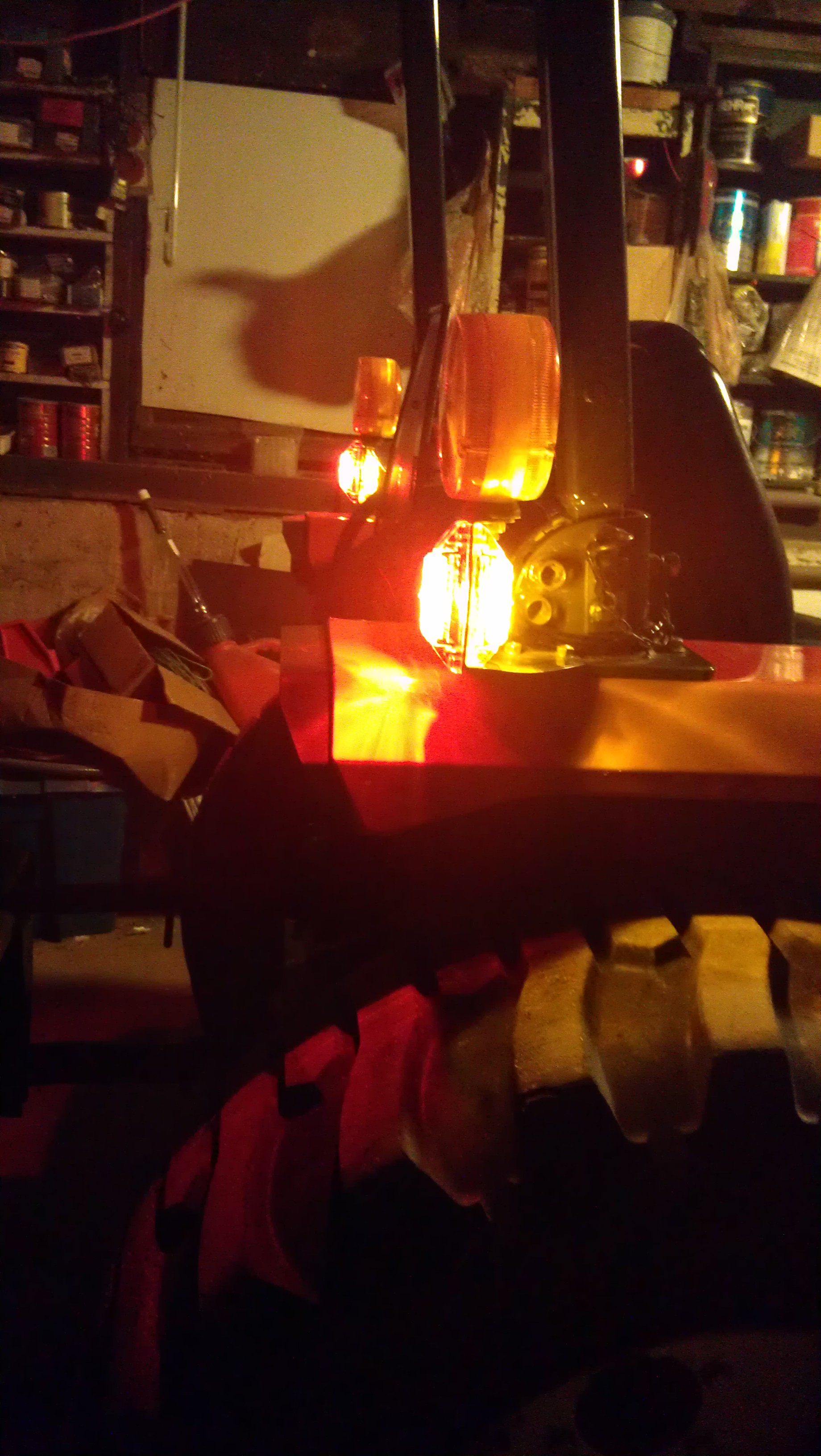

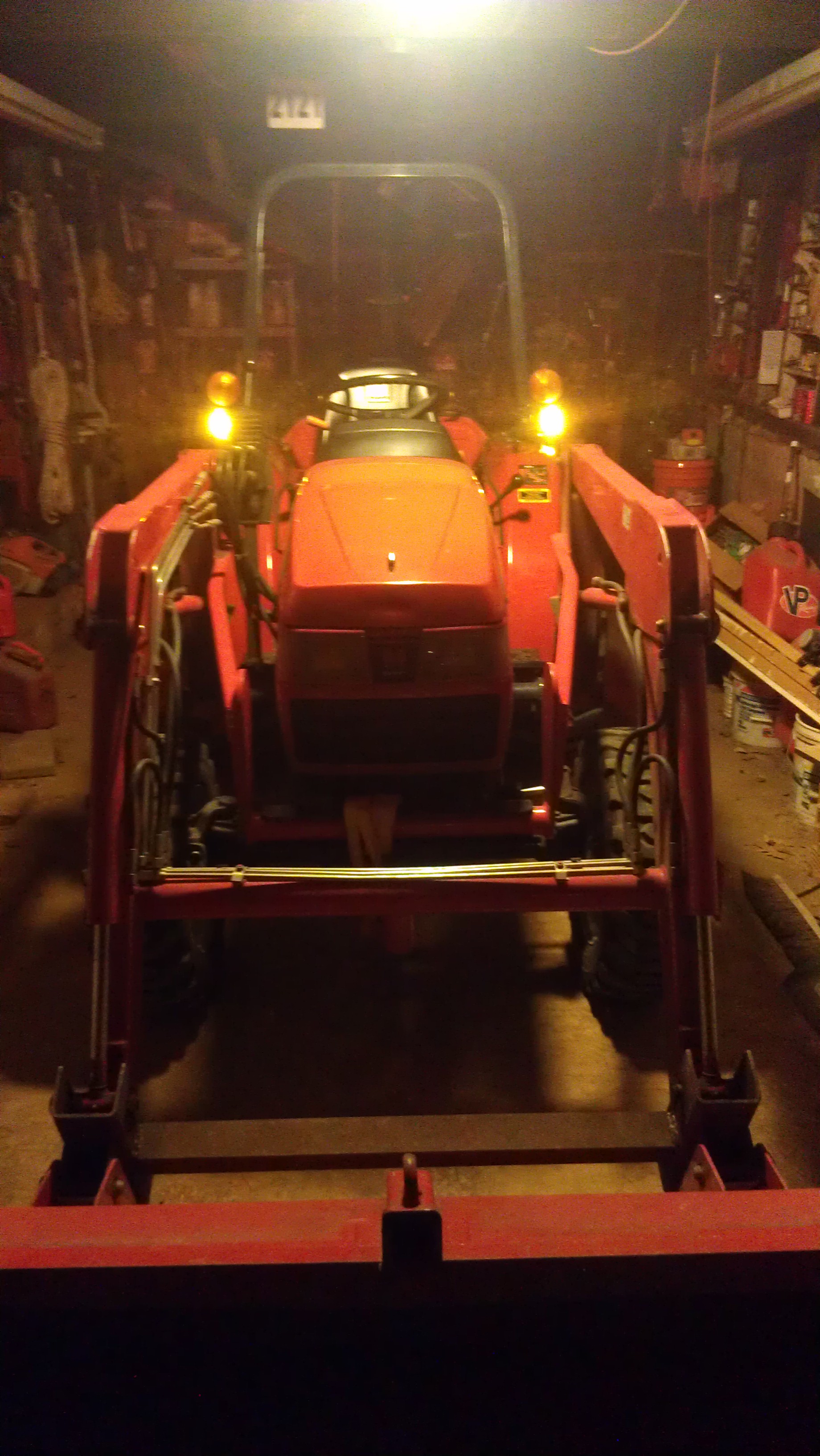

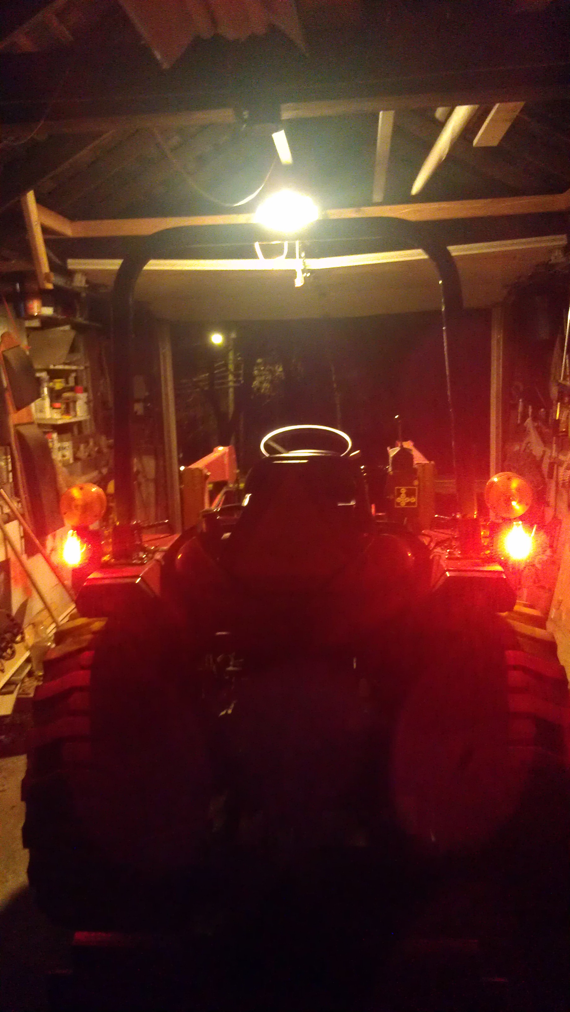

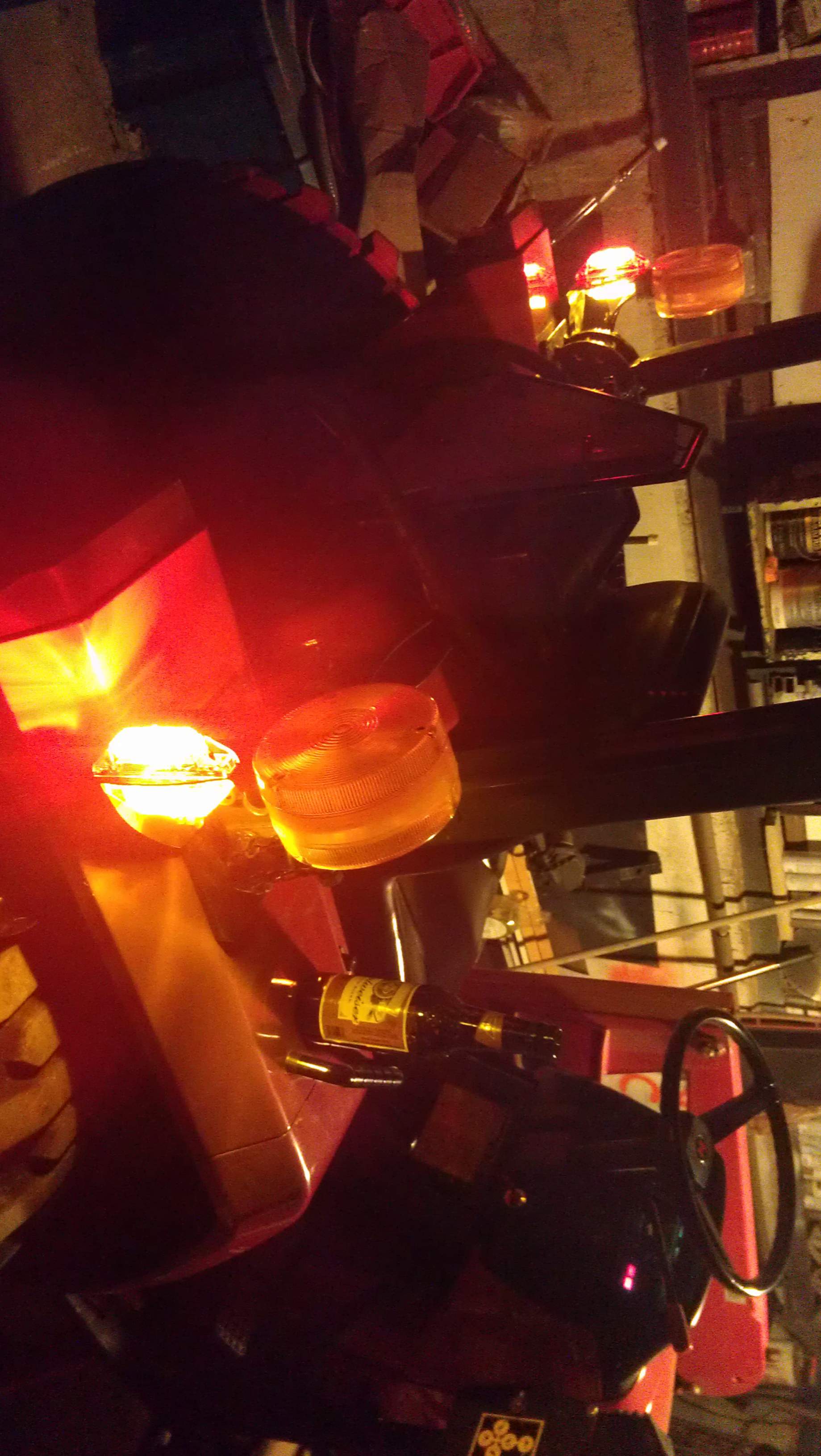

IMAG0479.jpgIMAG0478.jpgTonight I replaced my factory hazard/turn light bulbs with new 1156 l.e.d. bulbs from eBay. I also replaced the single red rear light with 2 new red l.e.d. truck-lite 35375r lights facing rear, and installed 2 new amber l.e.d truck-lite 35375y lights facing forward.IMAG0480.jpg

Looks like they are bright. Did you check how much amperage the 1156 replacements draw? How many LEDs does each one have?

Nice job. Can practically read the fine print on the beer bottle, :)

These are bright, there are 18 leds on each bulb, they were $7.99 with free shipping from Washington state at yitamotor on ebay. They are definitely a faster and more white light than incandescent. I am curious how the amber version of this led bulb would look. This video has the hazards flashing with led on left, incandescent on right.

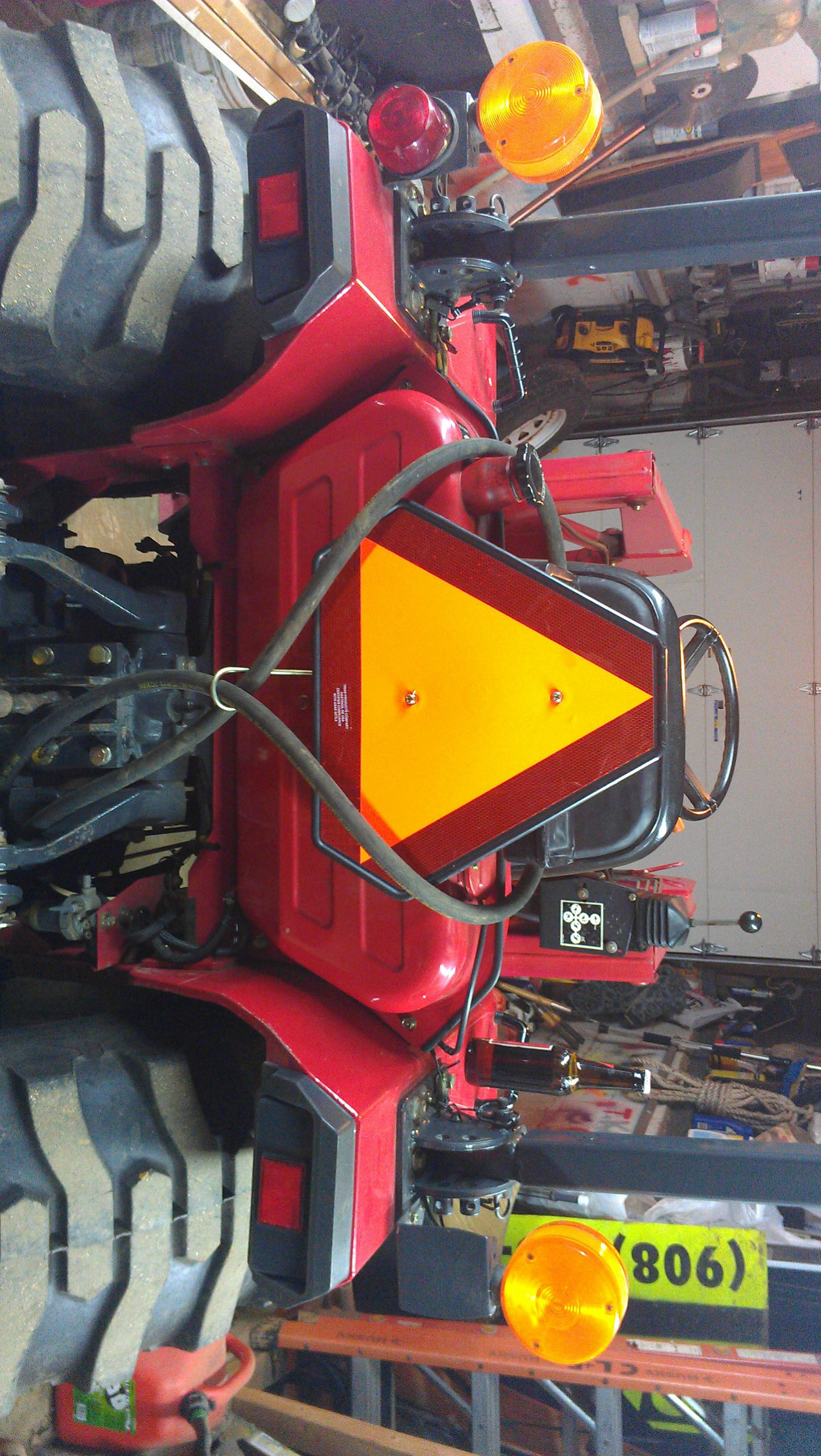

Just added 2 new flashing led lights on the rops, amber and blue, for snow plowing.
