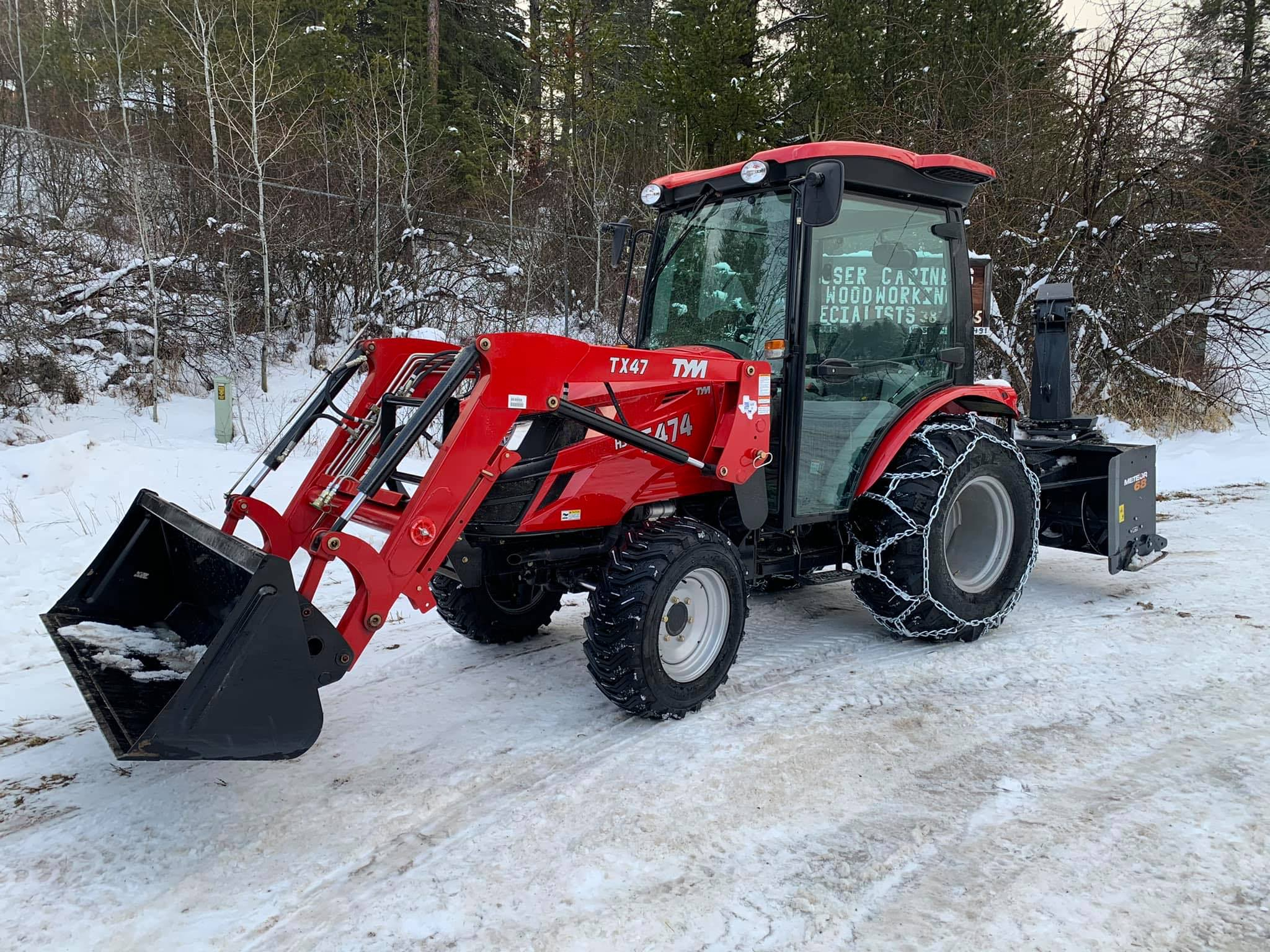

I struggled with the same dimension on my TYM's fenders, wanted to install some Trygg or other studded chains. But they would hit my fenders, so I installed DUO 239 H-pattern chains Duo Tractor Tire Chains | Free US Shipping

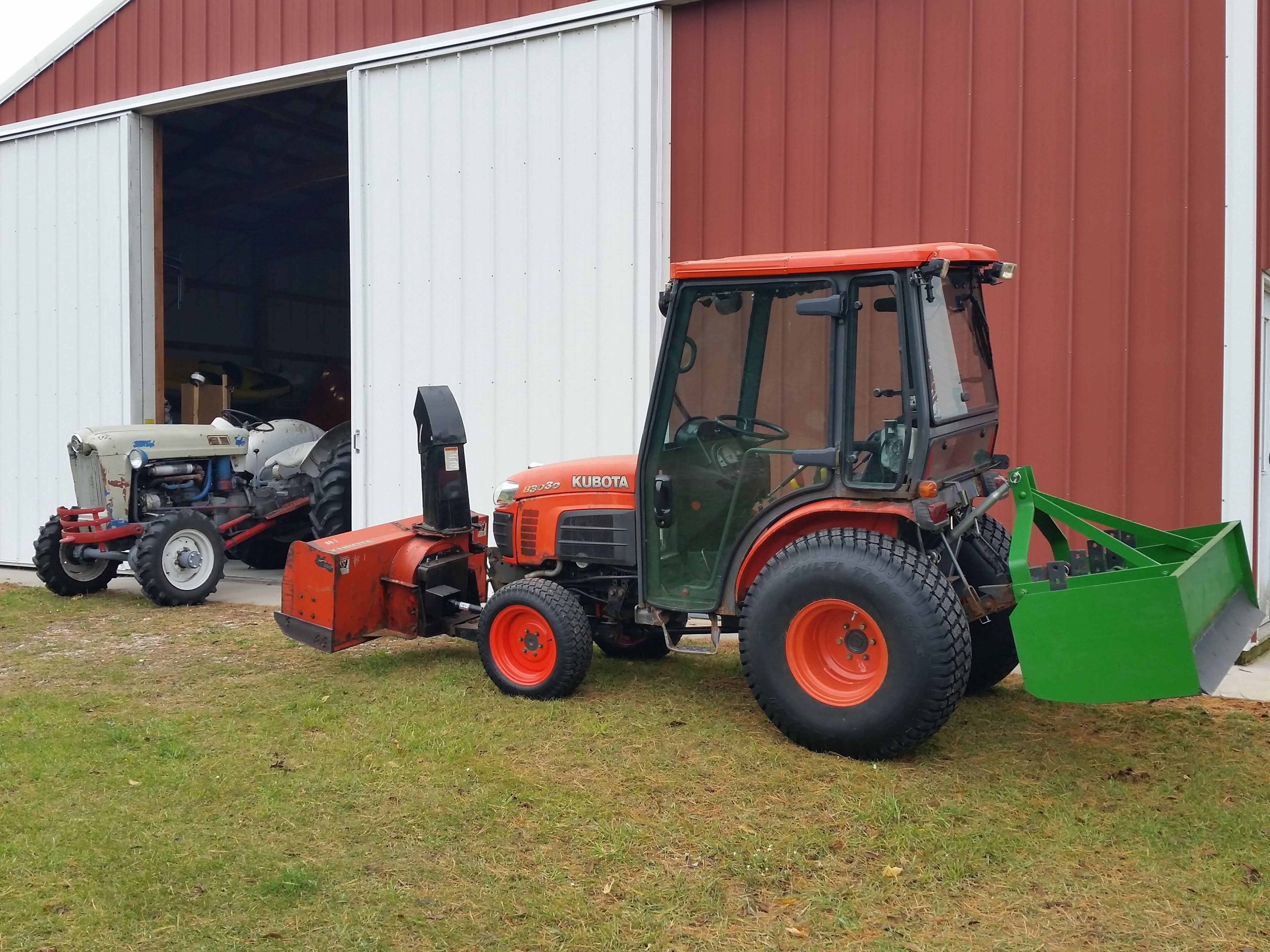

I have turf tires on my B3030HSDC and am very impressed with the snow traction. They are a deep S shape tread and work very well. I also have Rim Guard beet juice in the rear tires and carry a five foot wide box blade to drag snow away from garage doors and scrape concrete driveway.
