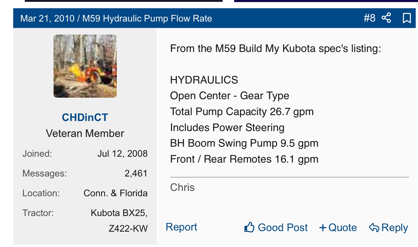

Does anyone know the flow specs for the M59's auxiliary hydraulic Flow Rate and Pressure?
If so, are the 3rd function or rear remote rated for continuous flow? Any limits?
I can't seem to find any of those specs in the operator & shop manuals.
Maybe someone knows about using auxiliary flow to run a continuous hyraulic motor.

The problem I see is not the flow, but the heat. How efficient is the hydraulic radiator and coolant system at keeping a constant flow for a hydraulic motor at a reasonable temperature? None of the Kubota literature has specs for any of that. ...but it isn't just Kubota, nobody else does either. John Deere doesn't even publish the flow/pressure/temperature for the auxiliary hydraulics on their commercial backhoes. And we know that they and their skidsteers sometimes run hydraulic motors on and off all day.
We can make some M59 guesses - but all they are is guesses. If we start at 16gpm and system operatingpressure, the auxilary flow should be in the region of 12 to 16 gpm at system pressure minus a few hundred psi....call it 2600 psi.
(13 x 2600)/1714 = 20 hp.
So you should be able to run any 20 hp hydraulic motor at its rated rpm. Surely - guessing now - an M59 system looks like it should be able to do that for several minutes with some period of cool off in-between consecutive uses. Probably we should put a hydraulic temp gauge in the system for making sure,
That is all pretty conservative guessing. I wonder why nobody publishes hydraulic specs?
