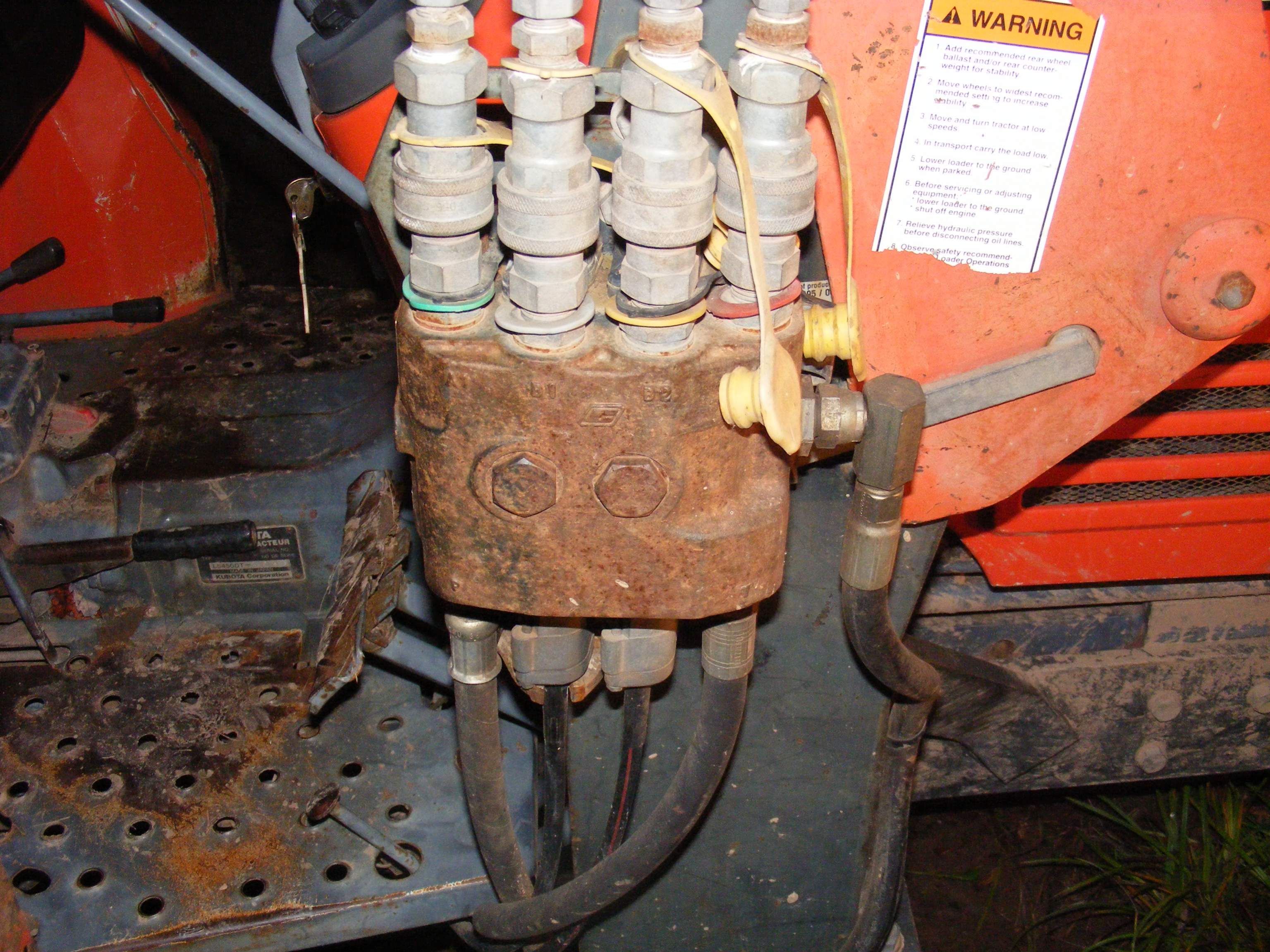

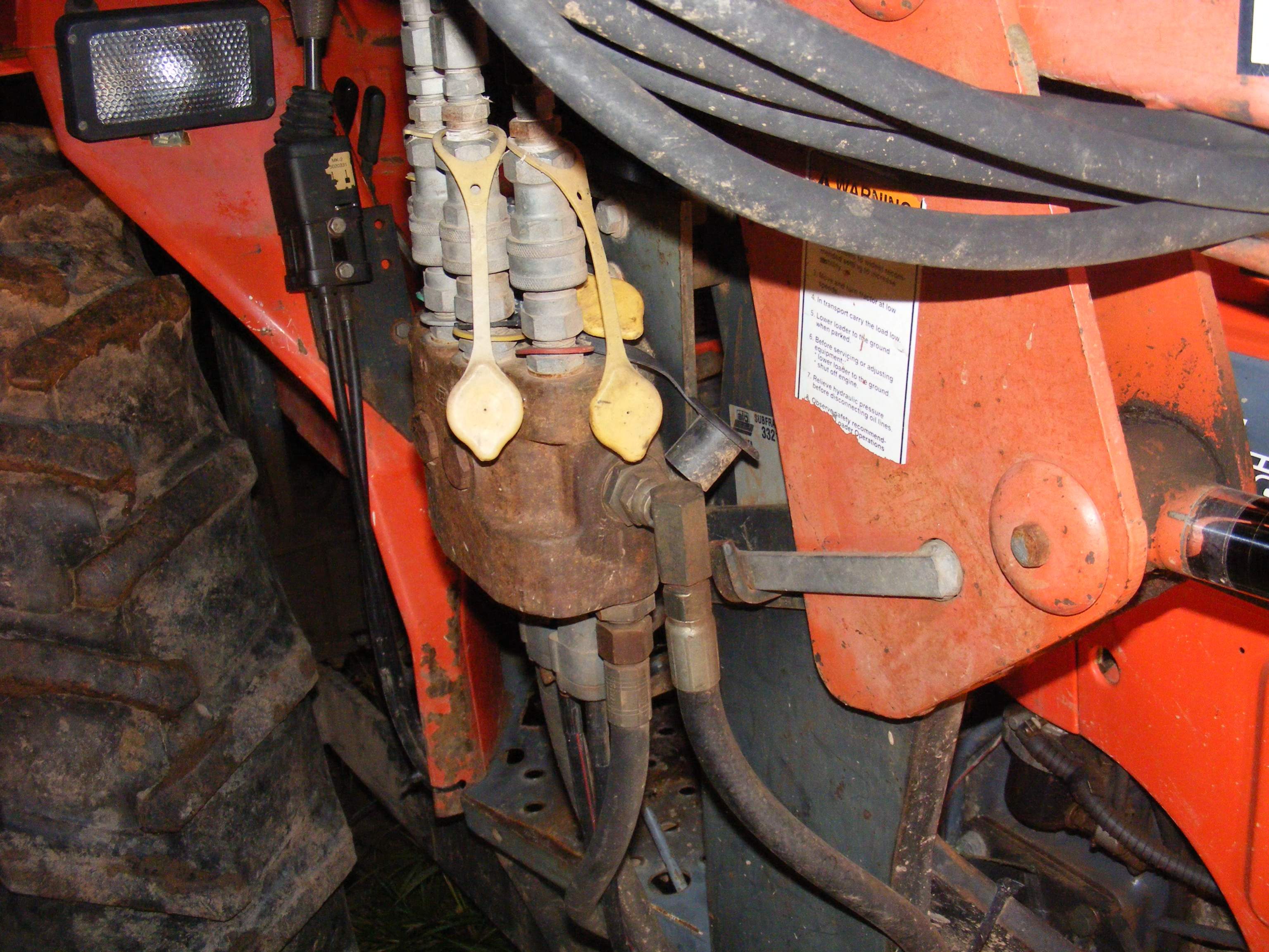

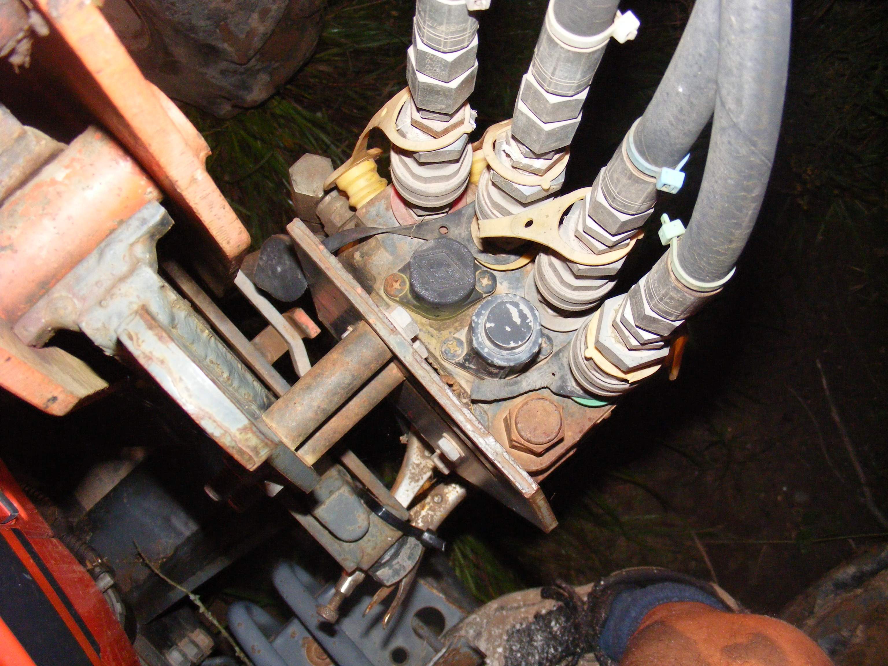

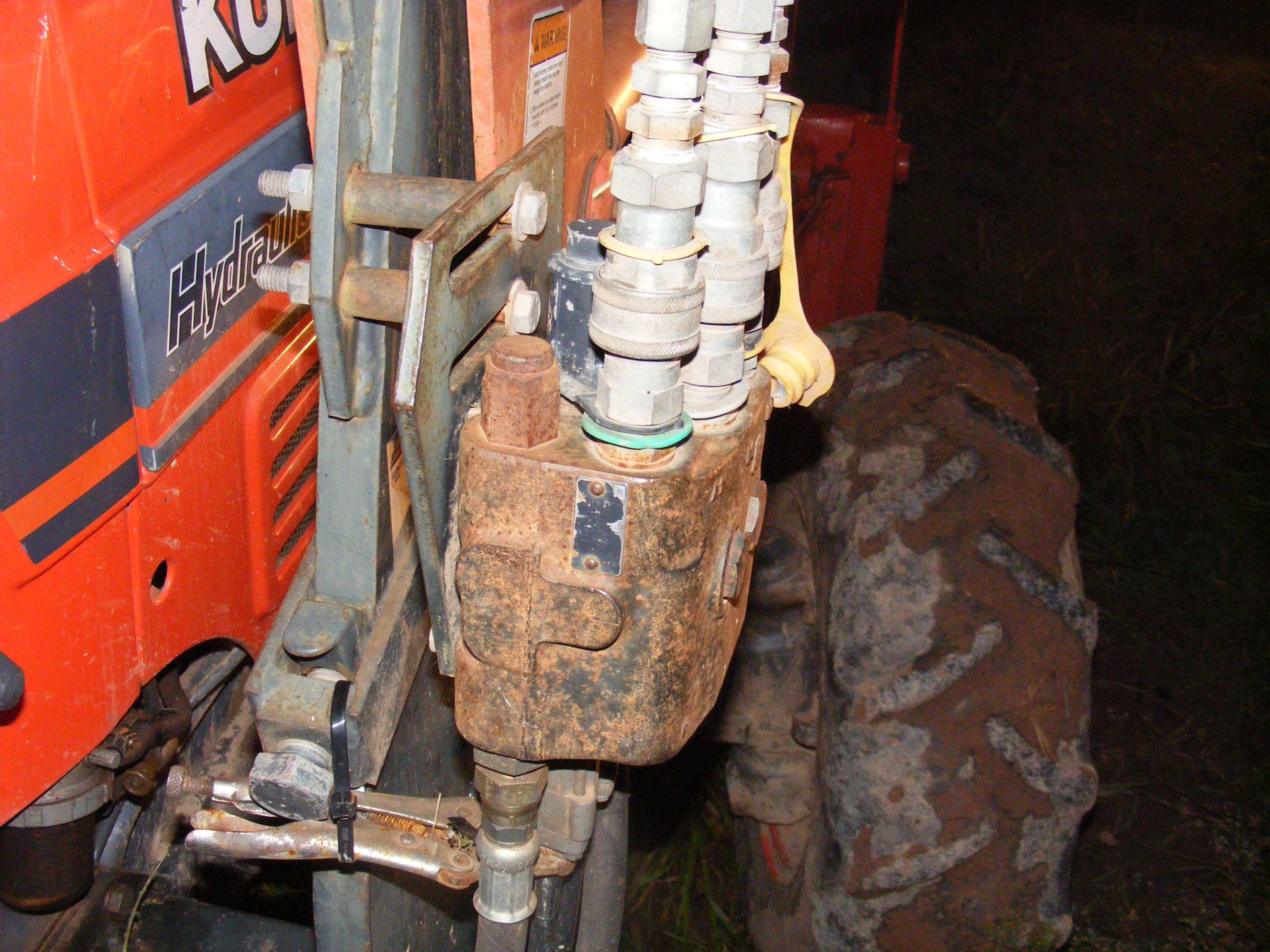

OK, here are a couple of pics. I hope this will shed a little light on things.

Great-you have 7 hoses total.
One of the ports should be marked with a P or PB-it is the "power beyond" port. That port can be plumbed to the IN of a new valve, and the PB port of the new valve would get hooked to where the old PB line went.
If you search threads here in the hydraulics forum for the term "remote" and "power beyond" you will learn lots...this is a very frequently discussed topic.
