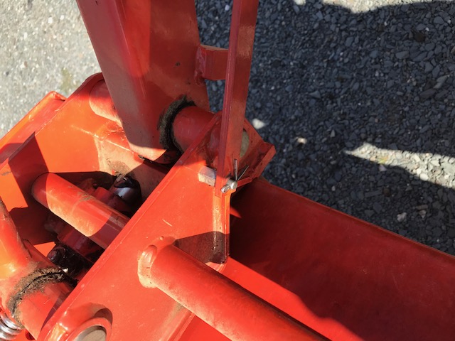

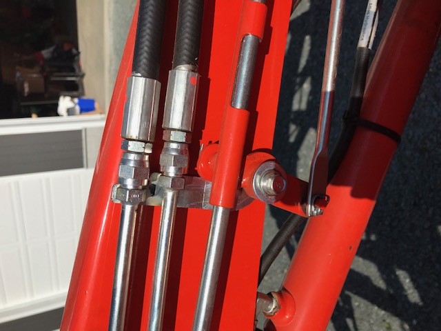

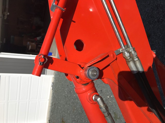

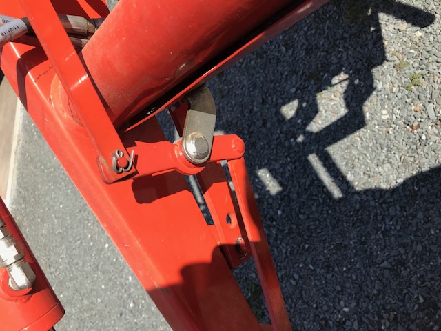

Good to know, thanks! My next question - is there any options in any of the hookup parts at the bucket end that are different for ssqa vs pin attach? And maybe incorrectly got the bucket part? All I know is the mount pin bends because of a rod binding near the bucket at full extention.
   / Kubota LA534 loader ... bucket level indicator...Kubota B2650 #16
Are all connections free to rotate? if so I don't see how the rod could bend.
I will take a picture of the connection later this morning for you.
