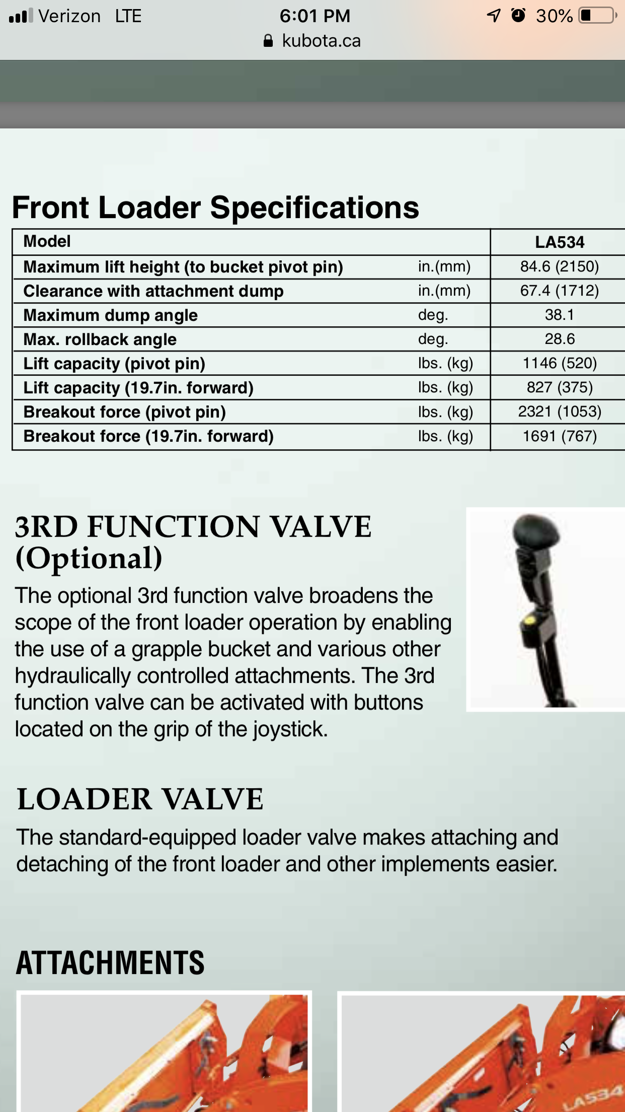

Not sure if this is what you are looking for but it says lift at 19 inches forward is 827 lbs. If you weren’t trying to double stack the pallets and put alittle less on there it would be fine. If you’re dead set on the b series I would just go alittle lighter on the wood to start out with and keep the pallet low and have the dealer load the rear tires if they load the rear tires with water, make sure to have them put antifreeze in the tire if you live where it gets below freezing. Also have something on the back for extra weight. I bought my L2501 because it was about the same price or alittle cheaper than the b2601 or b2650 they had and it was alittle wider frame. I like the wider stance using it on a hill side in the woods to get firewood and still have clearance.

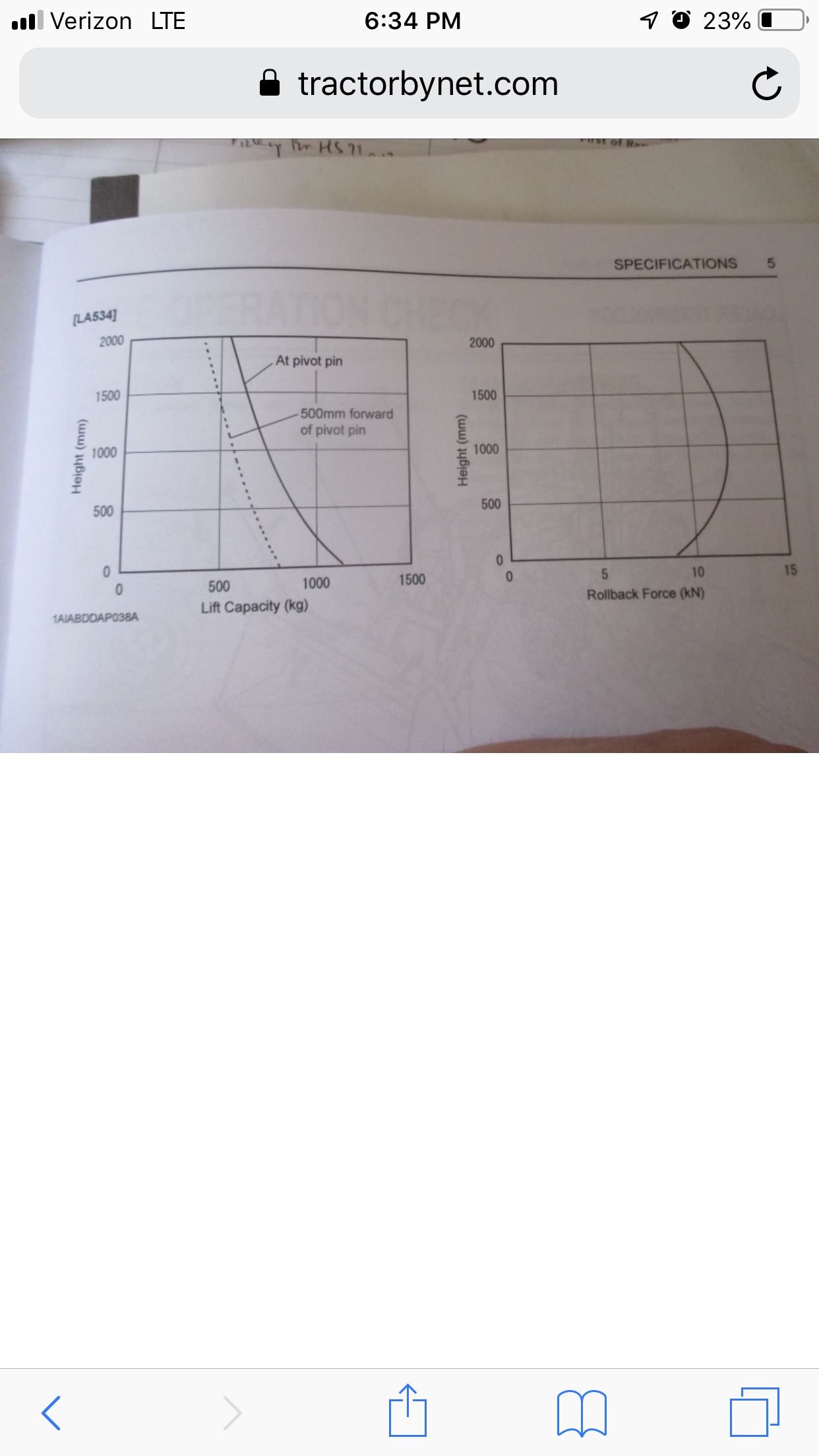

I found the loader curve on this forum. It’s under b2650 and la534 loader on this forum dated 5-2-18. I hope this helps

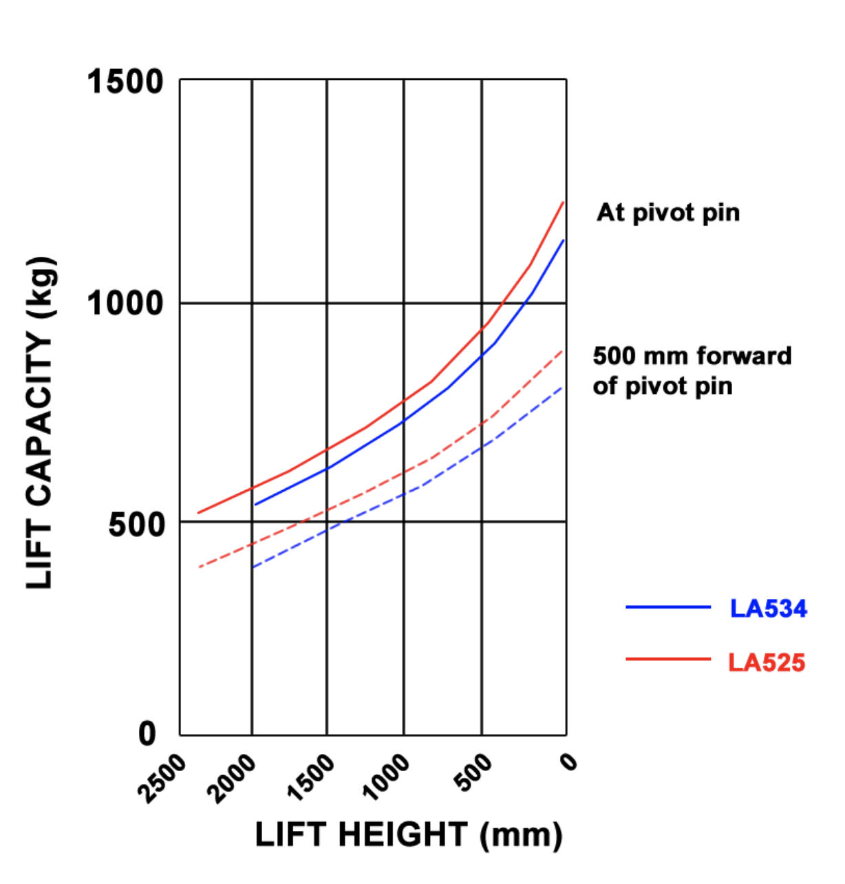

Here's the B and L loaders compared:
