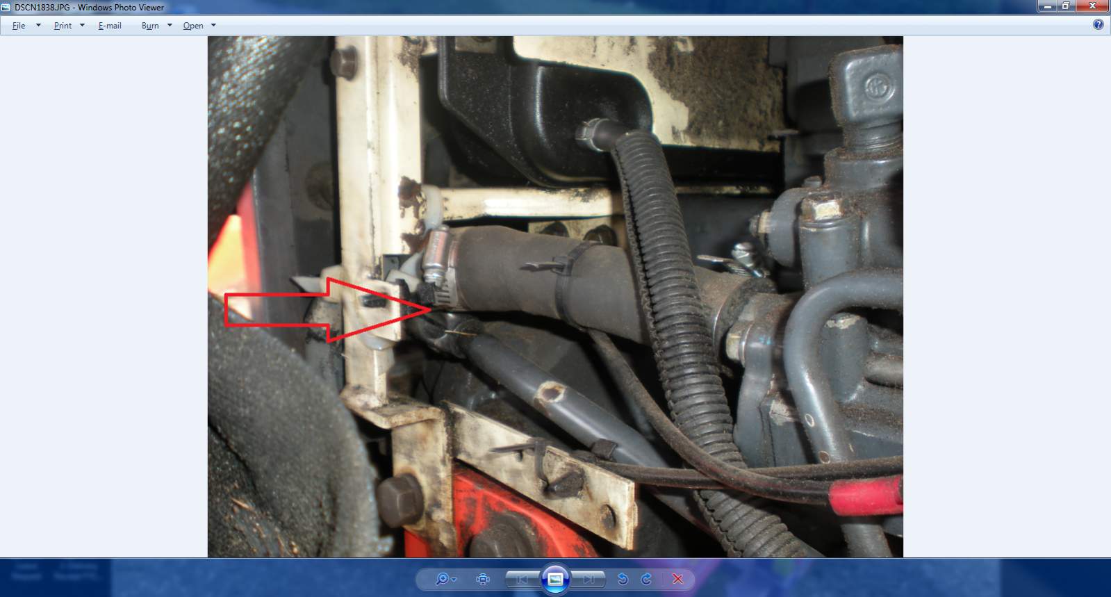

Update: I finally got around to looking at this tractor. Found a small pinhole in one of the metal lines.
This was sucking air and made the pump lose prime. Line is repaired and everything is good now.
Thanks for all the feedback. Sorry it took so long to post the fix.

Do you think it is something all Grand L30 owners should check for to prevent a similar issue? Is it possible to photo the general location of failure point?
   / Kubota L5030 (no Hyd functions)
#20
here is the pic you asked for.
