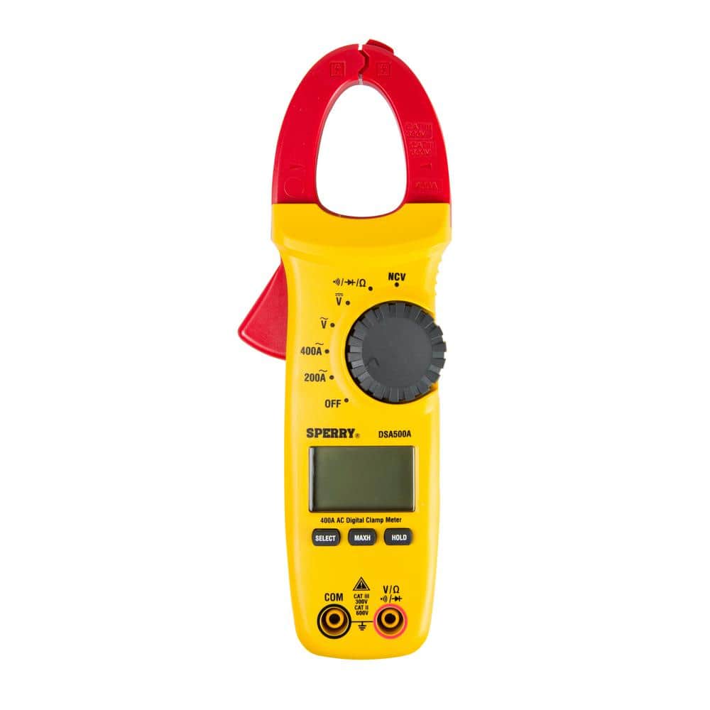

I have several meters form high$$$ fluke to very affordable quality Sperry that is actually clamp on amp meter to sevarl freebie cheap HF ones. I have really never had any problem with HF as I mainly check 12 volt and continuity with them In every car we own, every tractor and 4 wheeler I have a HF meter and if I should run over it and bust it then I would not lose sleep over. Below is the link for a sensible meter that I have had for more 15 years and never failed me.
