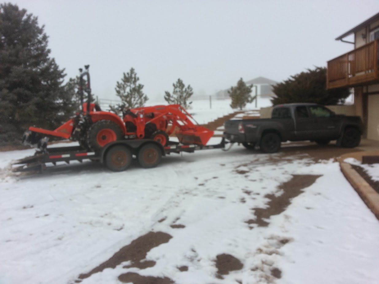

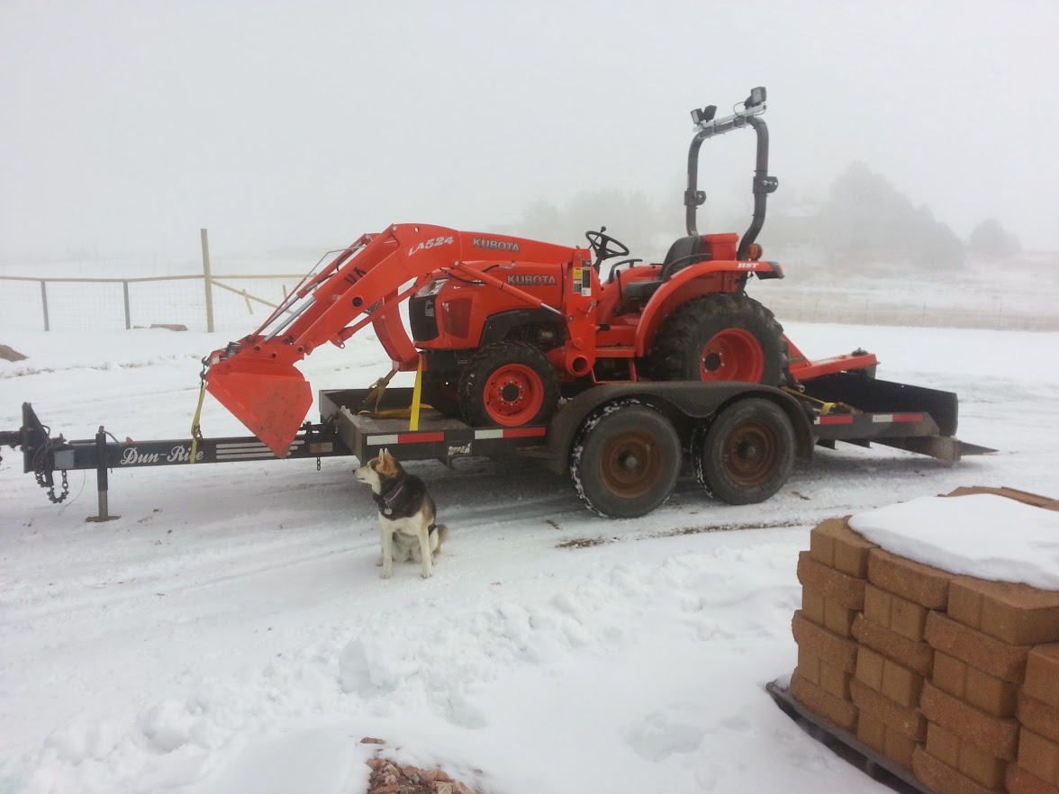

Here are some photos of the first test load I did with my tractor. As you can see, the relatively short back blade is almost hanging off the trailer, my rotary cutter definitely does.
I LOVE my tilting deck trailer, but they are noticeably more expensive (If you don't get a killer deal at an auction like I did). I have to drive up a 4-5 degree slope as opposed to 15-20 degree ramps. As the pivot for the deck is perfectly between the axles I just have to drive forward until the deck tilts forward, then go forward a couple more inches to get my 10-15% & I have a perfect balance without weighing tongue weight.
Trailers pretty much come with 3.5 or 7k lbs rated axles. My 14k trailer rides like a tank behind my Tacoma, better behind the F250. Figure 2k lbs for the trailer itself would leave you with about 5k for payload. My L3200 with loaded R4s & a loader clocks in at a little over 3.5k lbs, so you should be fine for tractor + a couple impliments on a lighter cheaper 7k lbs rated trailer.

My Tacoma & the setup in the photo meets all those requirements, but is at the limit where I'm comfortable & I don't like beating up my equipment pushing it to the limit (Hence the beater F250). Brakes & brake controller worked, but they were working hard to stop things, back end of the Tacoma was dragging a bit & I had to flog the engine to get up to speed. The 6.5k lbs rating is pretty much spot on for my Tacoma.
A F150 is a beefier truck than my Taco, so you should be fine. I only have the V8 in the 2005 F250 too & it does fine here in Colorado where we have no oxygen. It's not a speed demon, but it gets the job done.

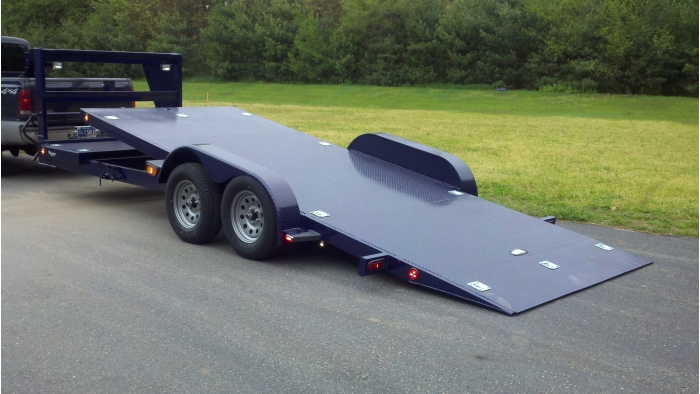

This is what I bought, and I am very happy with it. Tilt bed makes loading easy. Steel bed is very strong. Got it for about $4K (demo unit, few years ago) directly from manufacturer in Elkhart, IN, no middle man. LED lights, whole trailer is powder coated, spare and tool storage under deck, super, super nice. I got gravity tilt, for extra money they have power tilt with remote.
Open Car Trailers - Towable Car Haulers - JB Enterprises
Looks like a nice trailer & $4k for a nearly new tilting deck is great. How long is the deck?

18 feet. I'm never going back to non tilting trailer, or wooden deck.

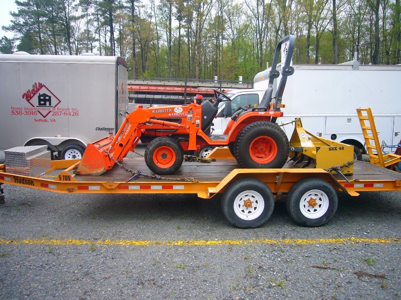

My trailer/tractor combo was ridiculous when I bought it in 2009.
A 12k GVW trailer for a 2k tractor.
467336d1462331786-kubota-l3800-trailer-tractor-015small-jpg
But when I need to haul my M4700 (bought 4 years later in 2013) from DC to Mississippi it came in right handy, just a little narrow.
467337d1462331827-kubota-l3800-trailer-20140427_103025-jpg
The tires barely fit in the 78" between the wheel wells.
