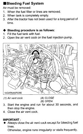

/ Kubota L3700 won't start #5
This is what the manual says.:

First step of bleeding procedure as written in manual is:
1. Fill up fuel tank!!!!!!!!!!!!!!!!!!!!!!!!!!
I read the bleeding procedure 10 times, but for some reason never registered this until k0ua reminded me.
Long story short, fuel tank was at about 1/4 and the bleeding was not working, no matter what I tried.
Filled the tank today to FULL (above return line) and bleeding was a breeze. Worked like a charm!!!
Thanks guys for all the help, without you I would have taken apart the whole engine by now. :(
