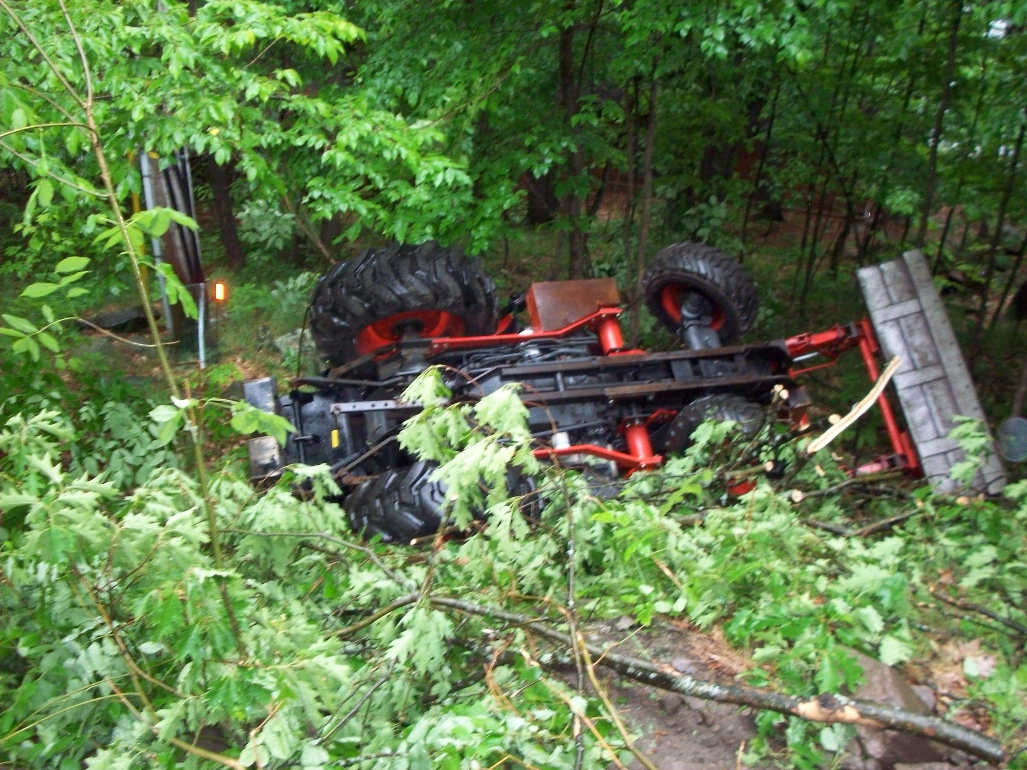

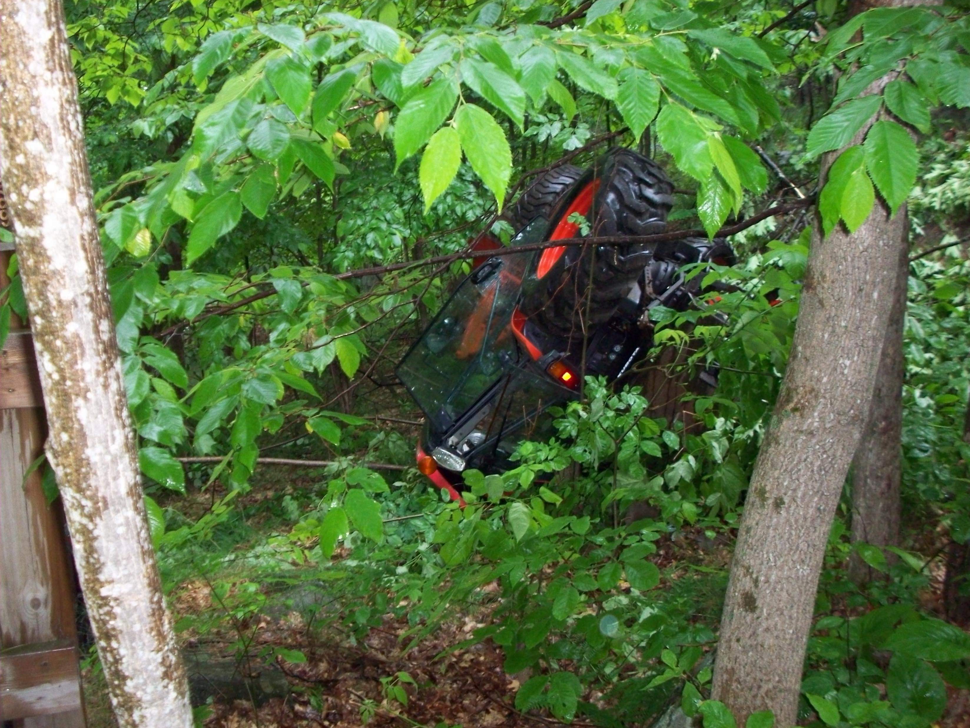

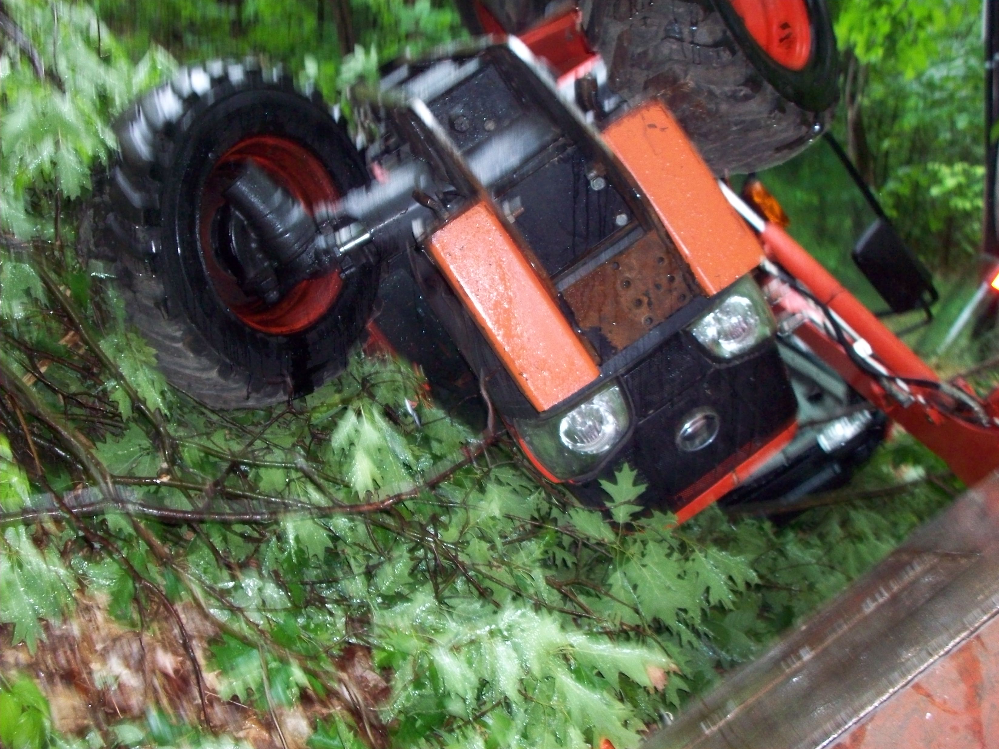

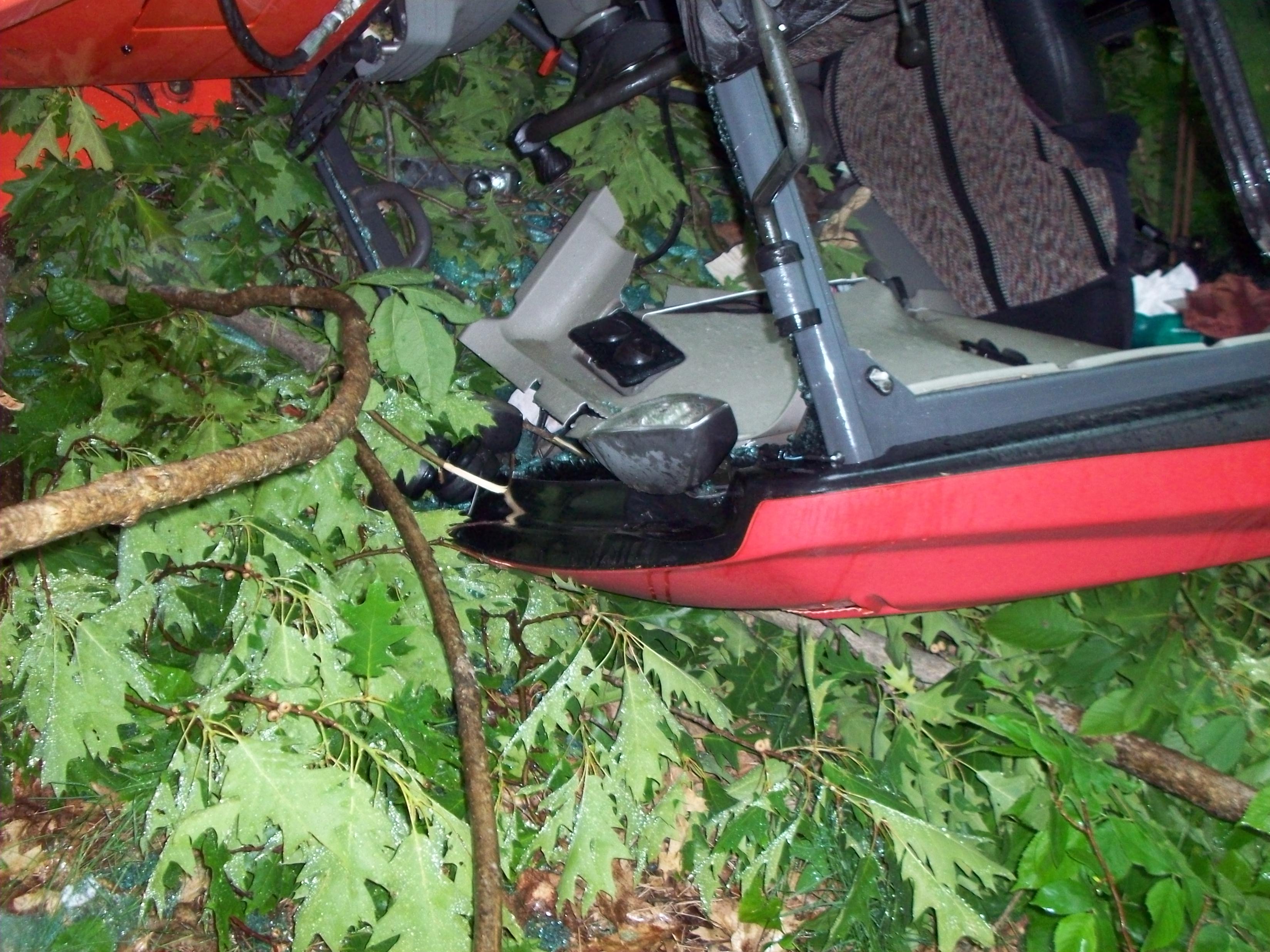

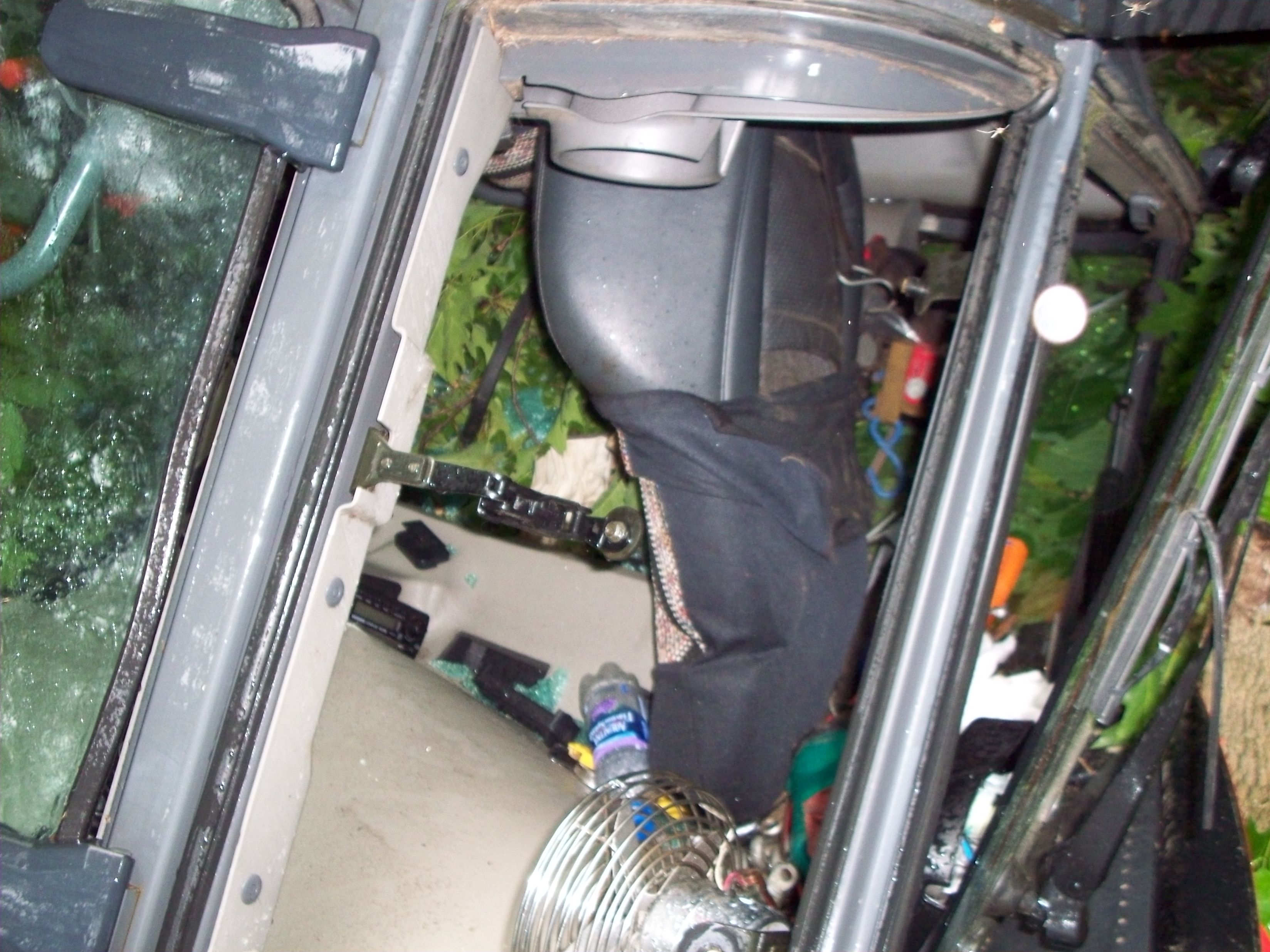

I have attached photos below. I have not gotten it out yet or started it. 89m & 90 were put on in error. Please just ignore them. Thanks

Yes, the cab can be removed/replaced, the WSM gives details on this as it must be removed and the tractor split to replace seals etc., I have no idea of the cost, but I'm sure it's pretty high.

no insurance rops are bent and I got whiplash plus hurt my back but nothing broken it was a 20 ft fall I think, been told the highback seat saved me

Glad you weren't hurt even worse as that looks bad even in pictures. Were you wearing your seatbelt?

Glad you didn't get hurt too bad. Once you get it back on it's feet on solid ground don't try to start it. It'll most likely have oil that leaked past the piston rings and into the cylinder head. My suggestion would be check with your dealer and/ or to start a new thread to get an idea so you know what to check and do. No reason to any more damage. As for the cab, I would wait until you get it upright and can take a good inventory of just what damaged. Depending just how hard it is to get it out of there you might do some more damage.

Good that you only had minor injuries- that could easily have been much worse, from the looks of it. Something you will never forget, I am sure! Keep us informed as you repair it, this is a pretty unusual job...
