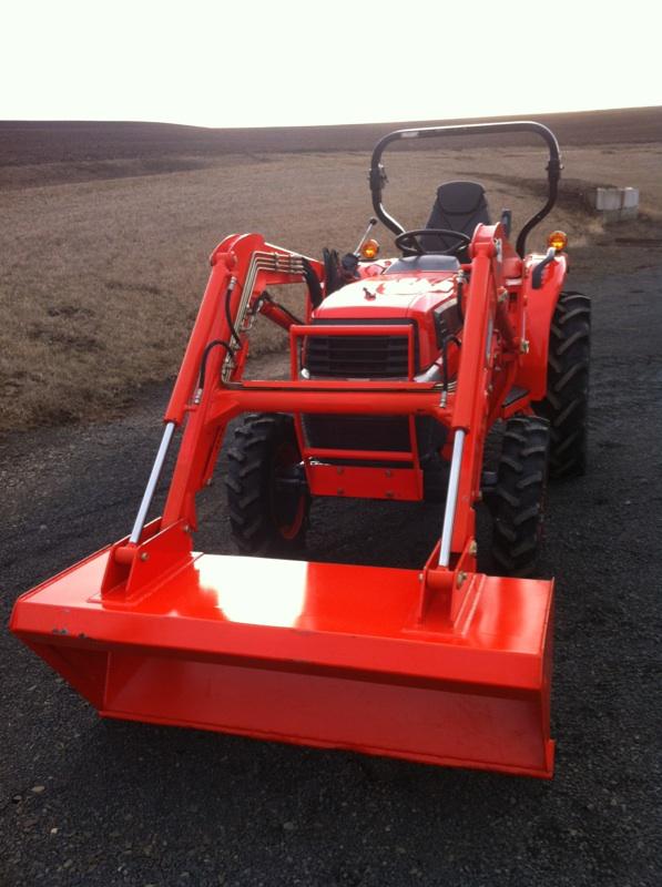

Looks like the ROPS had been shortened a good bit. I'm guessing this was for clearance going in and out of the mine. Not sure I'd want something that's been altered like that.
Great catch! I agree I don't like this. Should be replaced with stock ROPS.
