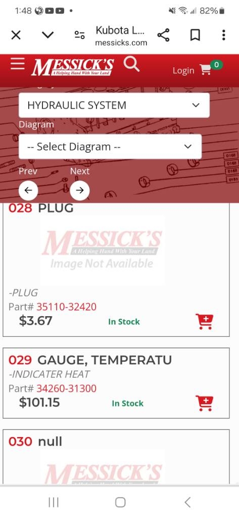

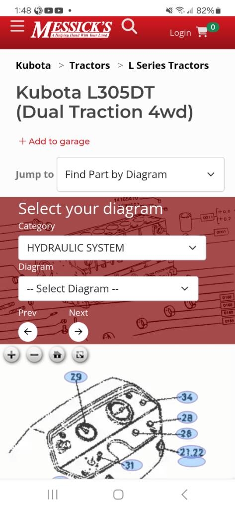

I just bought this thing and after about 5 min of brush hogging I have a red idiot light on. I am not sure what it is. It is on the left side of the rpm gauge. Oil light maybe? Low oil pressure, temp or level? Oil level was fine. Any help would be appreciated. I cant find an online shop pdf manual for it.

Based on what your saying; should be item #29; engine temp. Check coolant level, condition, and radiator and radiator screen. From there, if those all good, could be thermostat, or water pump. My assumption is, radiator is nasty dirty
/ Kubota L305D #3
...and most likely loaded with brush hog chaff as well You do have to perform maintainance on any unit especially when running a shredder and if you kept on running it with the light on chances are you'll be into a lot more serious issues than a cruddy or blocked radiator.
