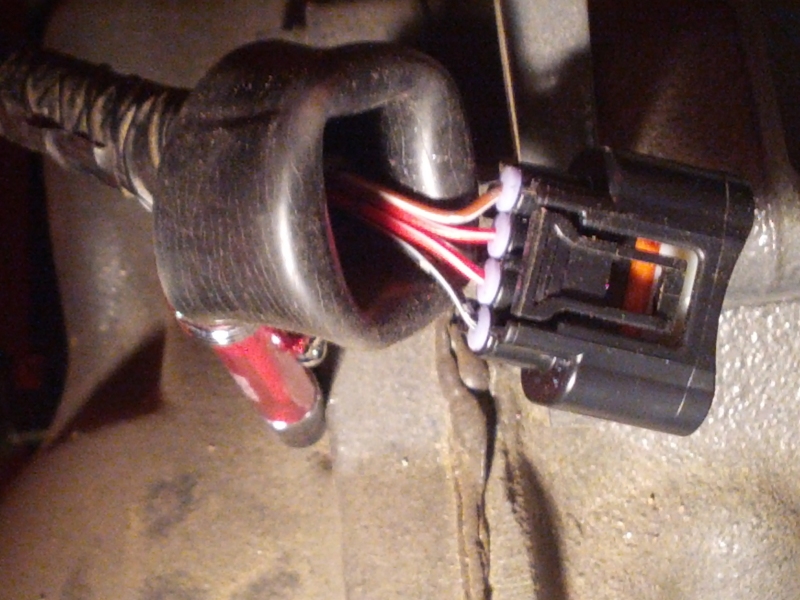

Here's a picture of the connector. Top to bottom is brown, orange, red, black.

Well it works !!! No error message on start up and the cruise works good. My tractor had two red w/white wires instead of one red and one orange. The pic you sent got the odds down to 50/50 and I was feeling lucky. Thanks again
No problem. They could be both red but one looked slightly orange. With the dust boot that covers the connector it's hard to get a good look. If they are both red then they probably are identical and don't matter which way they go in. Either way glad to hear it works fine.
