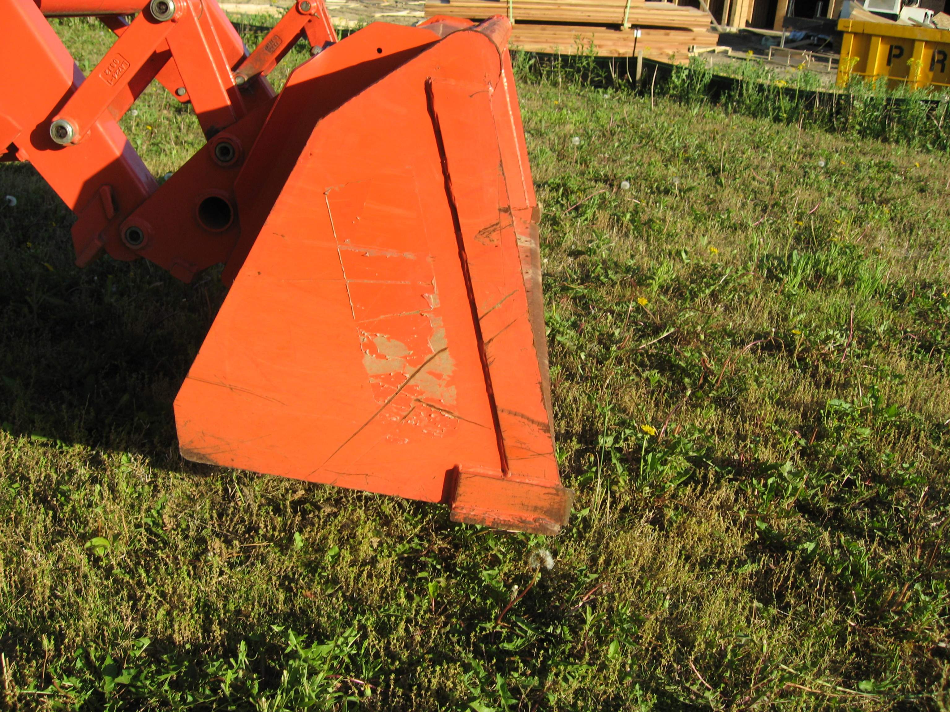

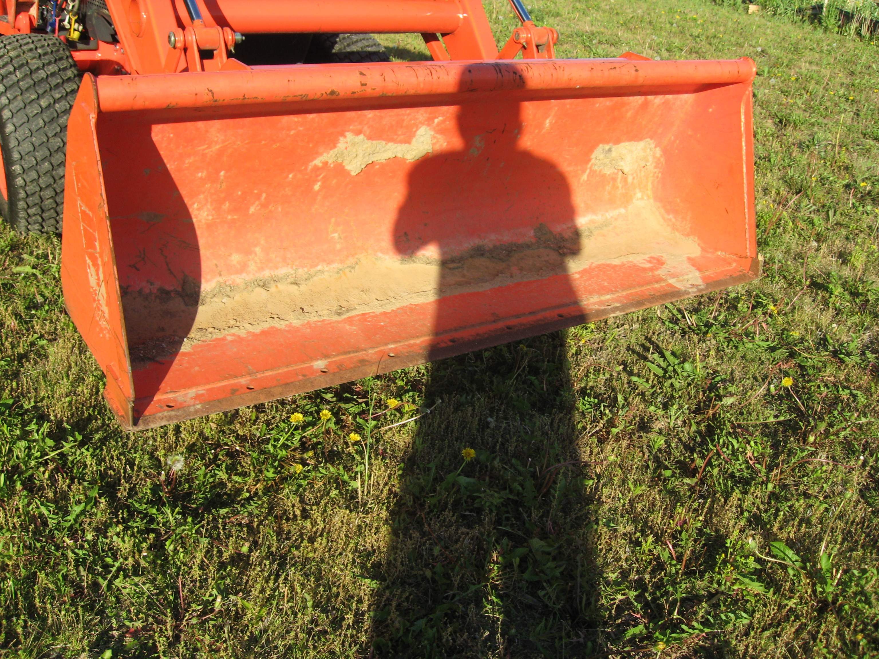

I could have gotten the HD bucket on our M8540 if I had ordered the tractor, but they didn't have any in stock. They said it would take four to six weeks to get one and since our CX80 had gone toes up, we couldn't wait that long.
Here are the best pictures of our buckets I have.

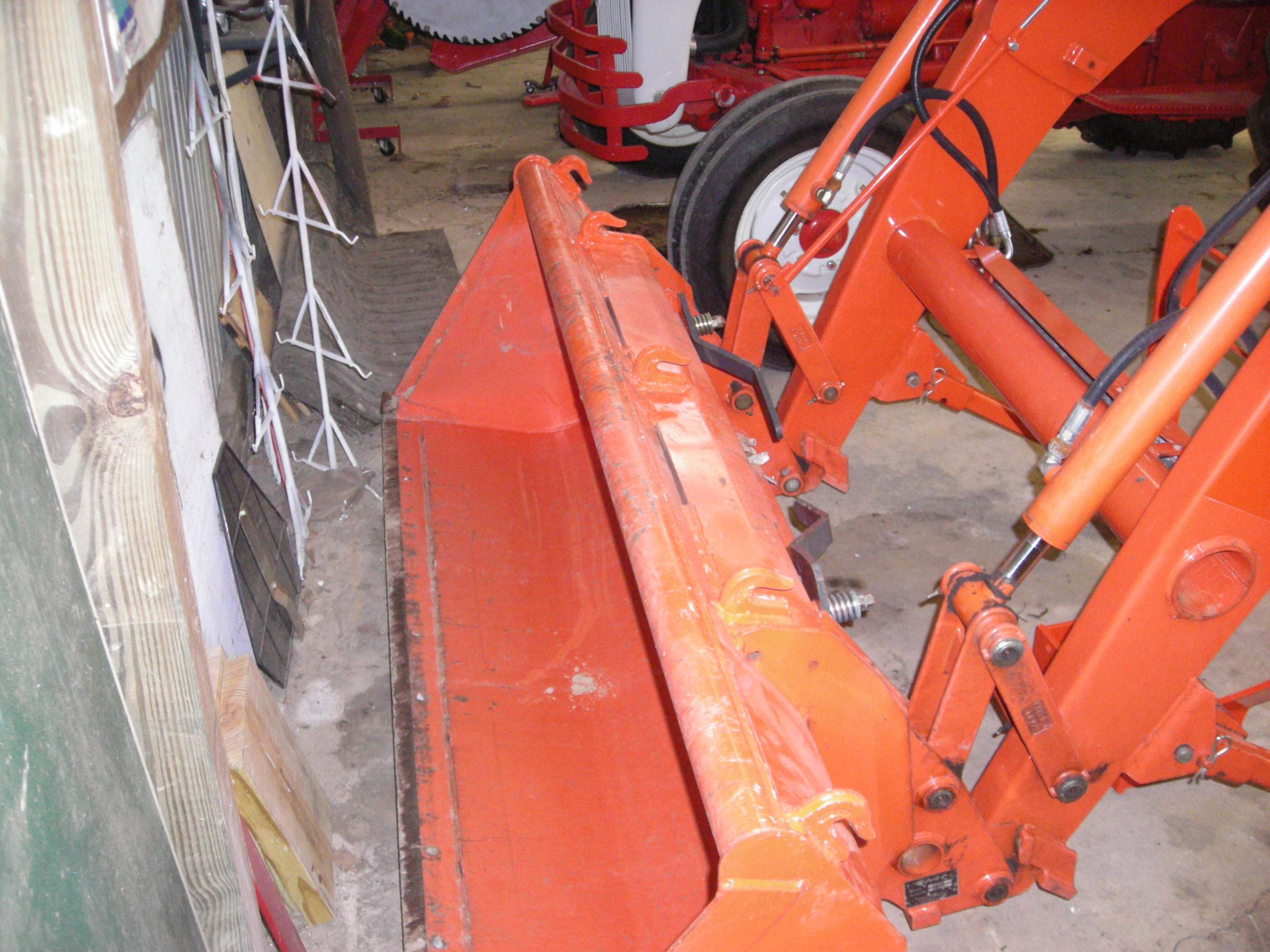

I have a 72" roundback bucket on my LA703 loader that is on an L4400 Kubota. The bucket is a SSQD with a bolt on cuting edge. There is a round pipe that runs across the top of the bucket. The bucket is square backed on the outside and round on the inside. This indicates that the bucket is double walled. The bucket seems to be strong.
/ Kubota HD 72" round back bucket #12
Here's a picture of the 72" round-back..sorry only one I have on my computer.

Those pics are interesting. Those HD round backs do look more HD than my bucket. My bucket model number is M1811. The funny thing is it looks like Kubota has "L" part numbers and "M" part numbers on their buckets for L and M tractors. With both having the QA, I figured they would be the same buckets... unless there are different "dutys" in both standard and HD models. Who knows.
I was not aware there were more heavy duty versions since I did not see it in the "build your own" section of the site.
Haven't bent mine yet so I will just have to see how it goes. I have been digging out a bunch of trees and it has held up pretty good so far.
