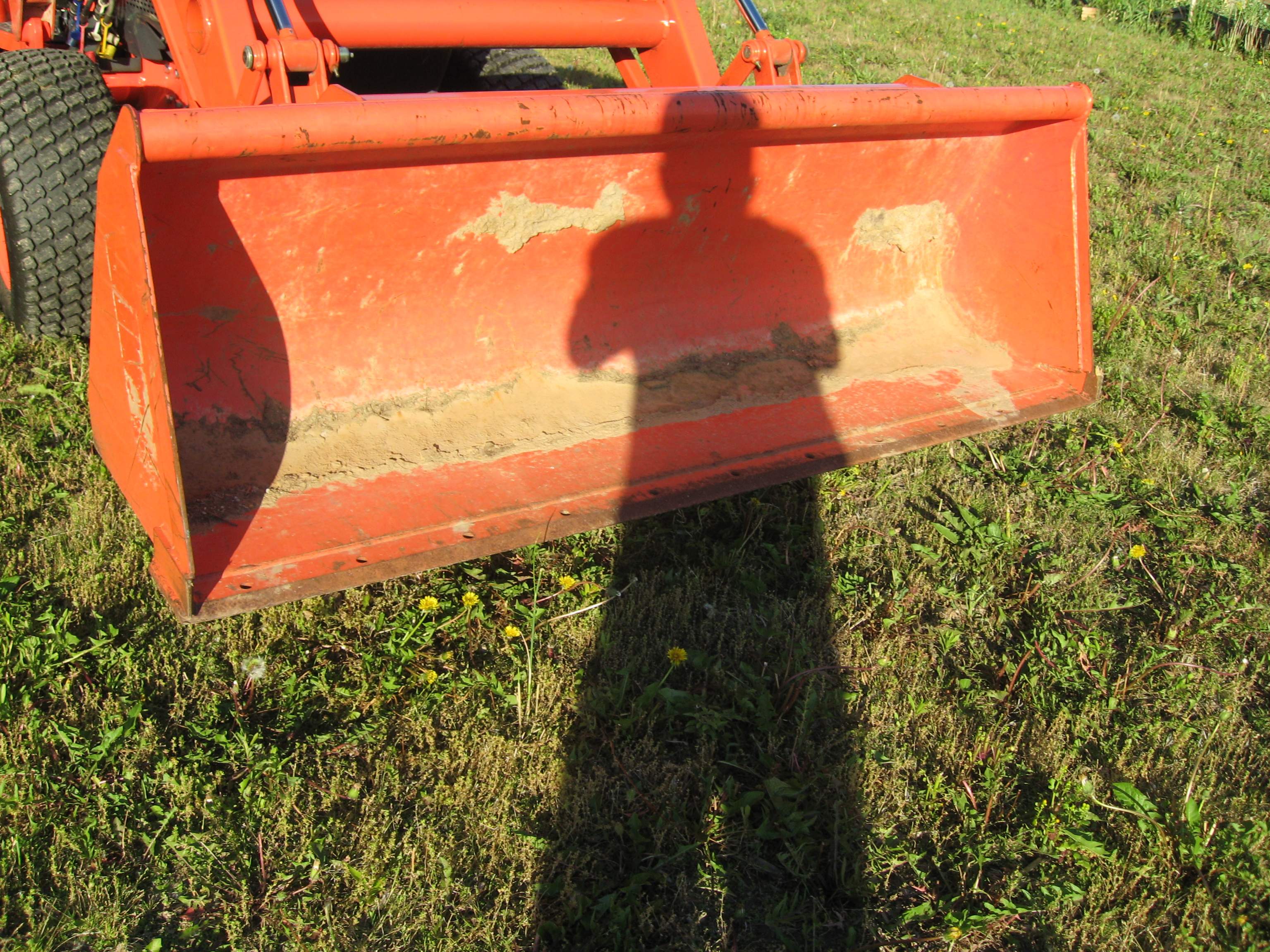

I have a 72" roundback bucket on my LA703 loader that is on an L4400 Kubota. The bucket is a SSQD with a bolt on cuting edge. There is a round pipe that runs across the top of the bucket. The bucket is square backed on the outside and round on the inside. This indicates that the bucket is double walled. The bucket seems to be strong.

Here's a picture of the 72" round-back..sorry only one I have on my computer.

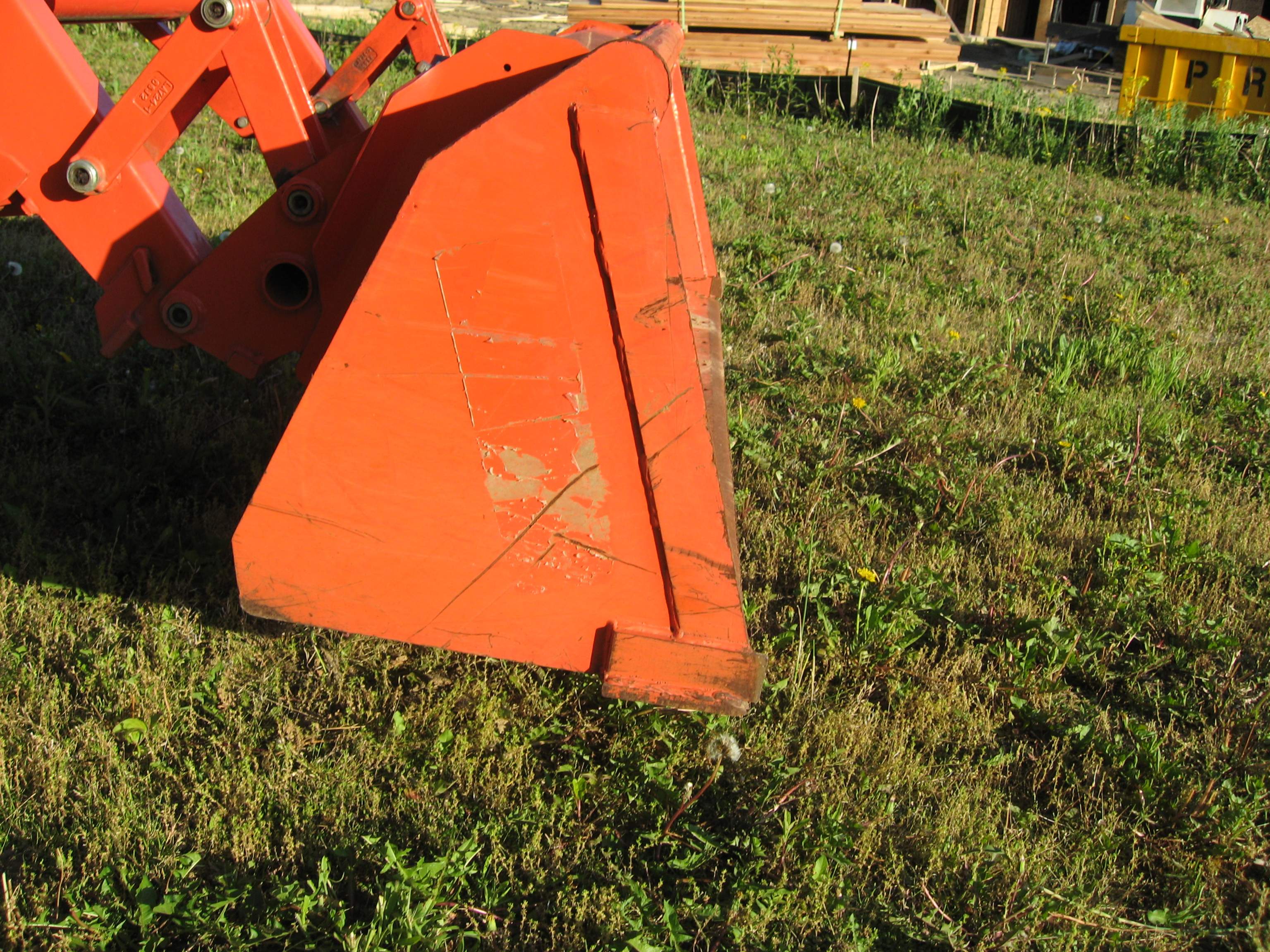

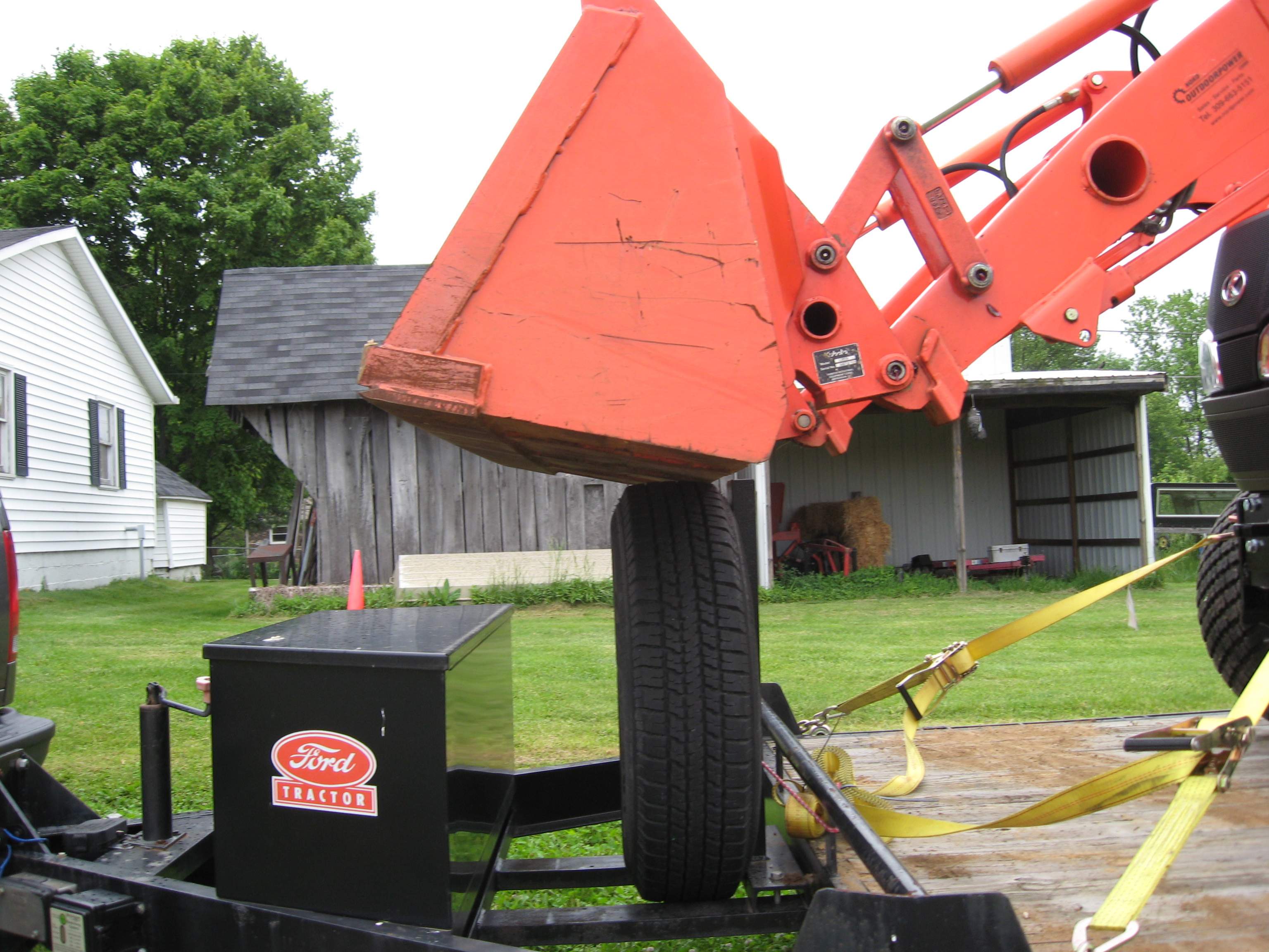

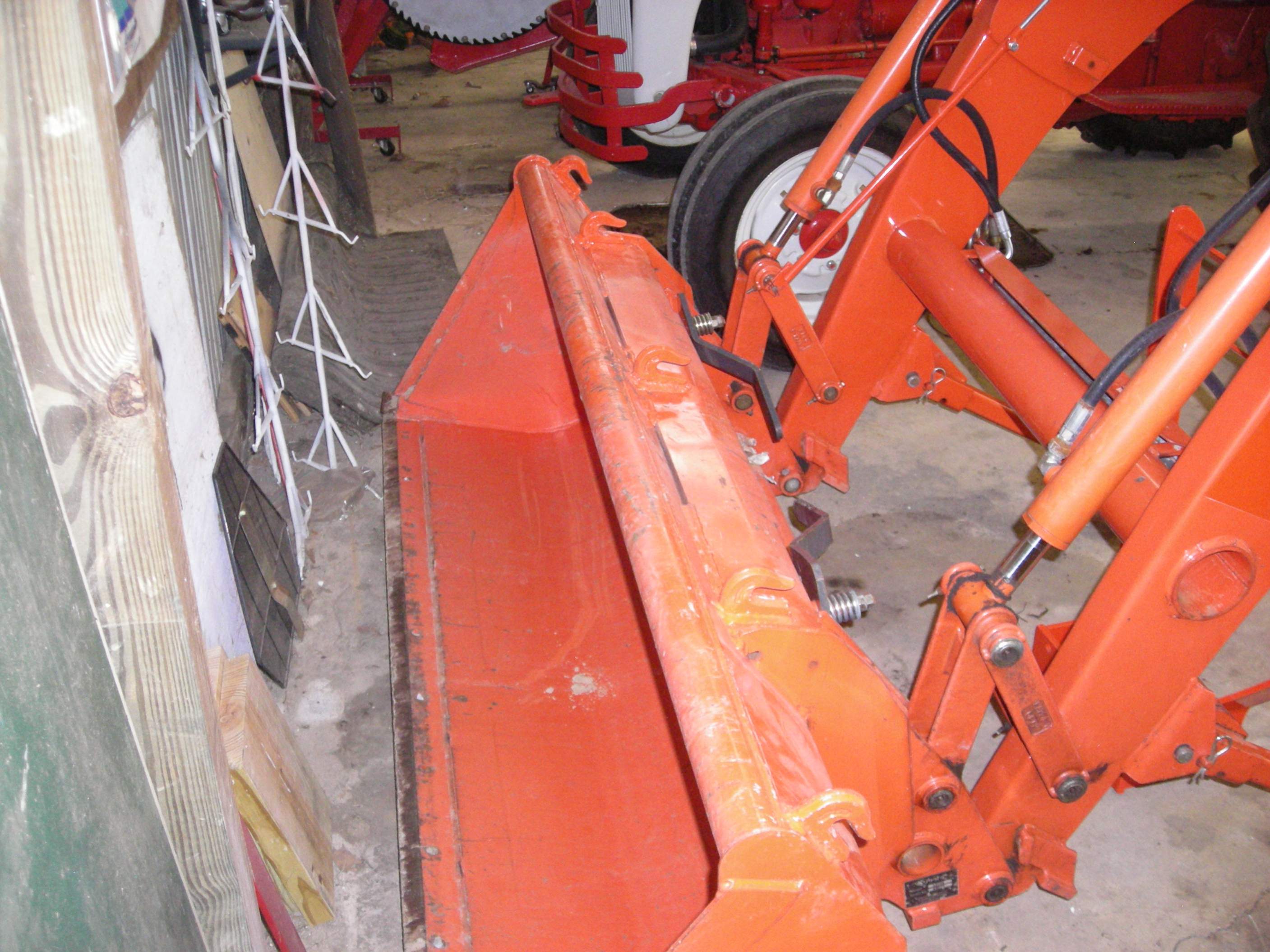

Here are more pics of the 72" heavy duty round back bucket on a LA724. Philip.
When you bought yours did you get a chance to look at any of the other 72" buckets to compare?
   / Kubota HD 72" round back bucket #15
No, I bought loader used from Barlow's. This HD square back has a strong piece of pipe at the top for support and strength. Other buckets I have seen are weaker in this area. Philip.
