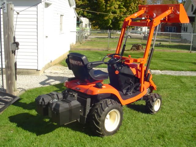

Get yourself one of those nice,cushy B series seats thru a dealer or ebay.They're made to accept the armrest kit too.Nice upgrade.I like mine on the GR2000.It's a direct bolt on fit.I also ran 1/2" angle iron back on each side and pinned the seat down solid to eliminate the sloppy rocking motion caused by the flimsy single front pivot/hinge.

Assume you're tallking to me. Seats have no suspension.Seats are comprised of a pan,padding,and cover.Seat suspension on the original GR series like mine is nothing more than a block of rubber sandwiched between a double-hinge mechanism.The newer 2110/2010 series is much improved using an adjustable spring suspension.The seat on mine came from an online Kubota dealer out east.This seat was the "good will" seat available to Kubota dealers for a very low cost to give away or sell cheaply to customers that complained of the nasty slide-off seat that came standard on the BX series tractors.I paid around 80 for it,and another 60-80 for the armrest kit.It's thicker,so it sets up a little higher.I already said the bolt pattern is a direct fit.Huge improvement in comfort.
Messicks may still have some,don't know;
Kubota PN#B1013
