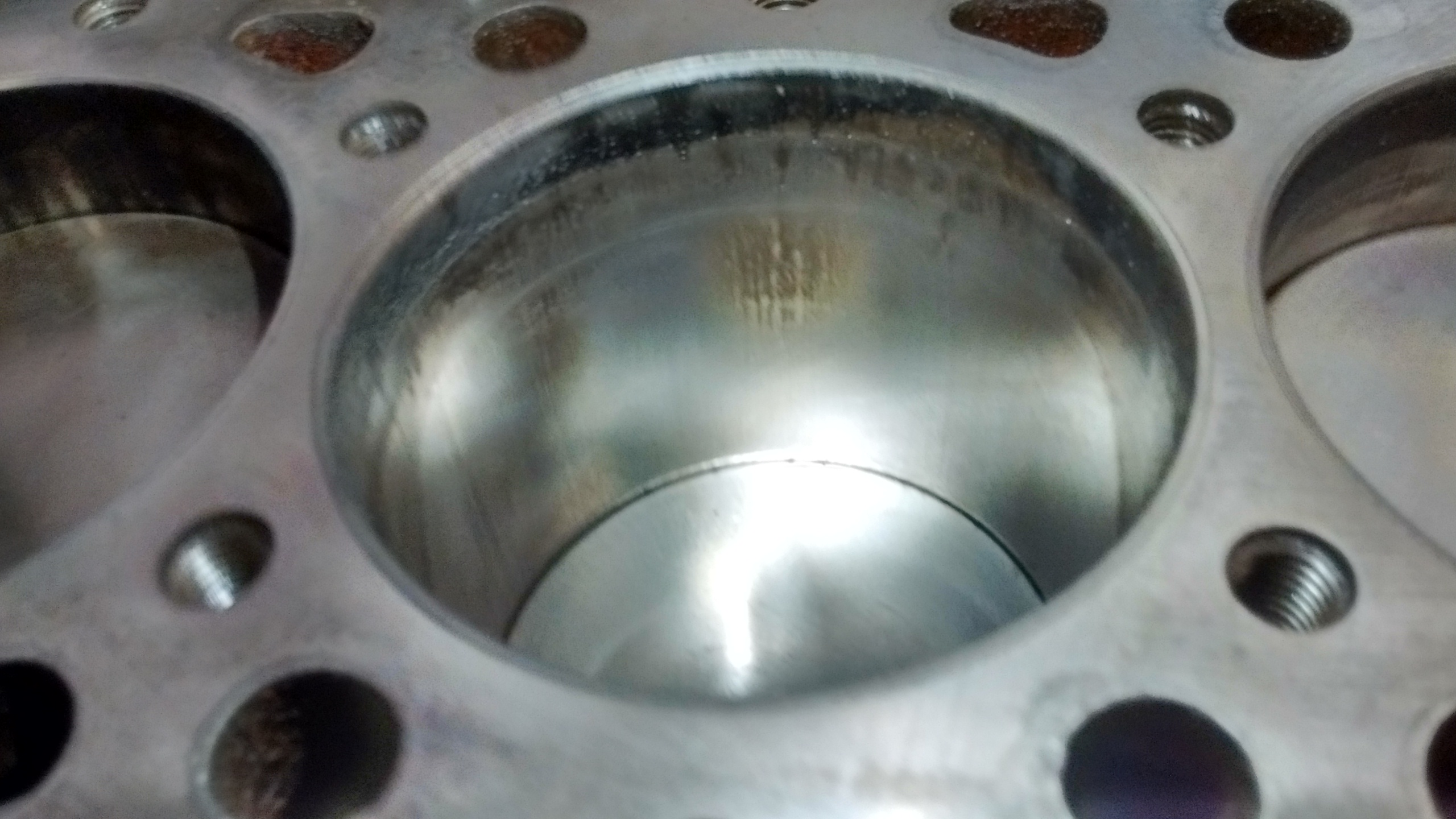

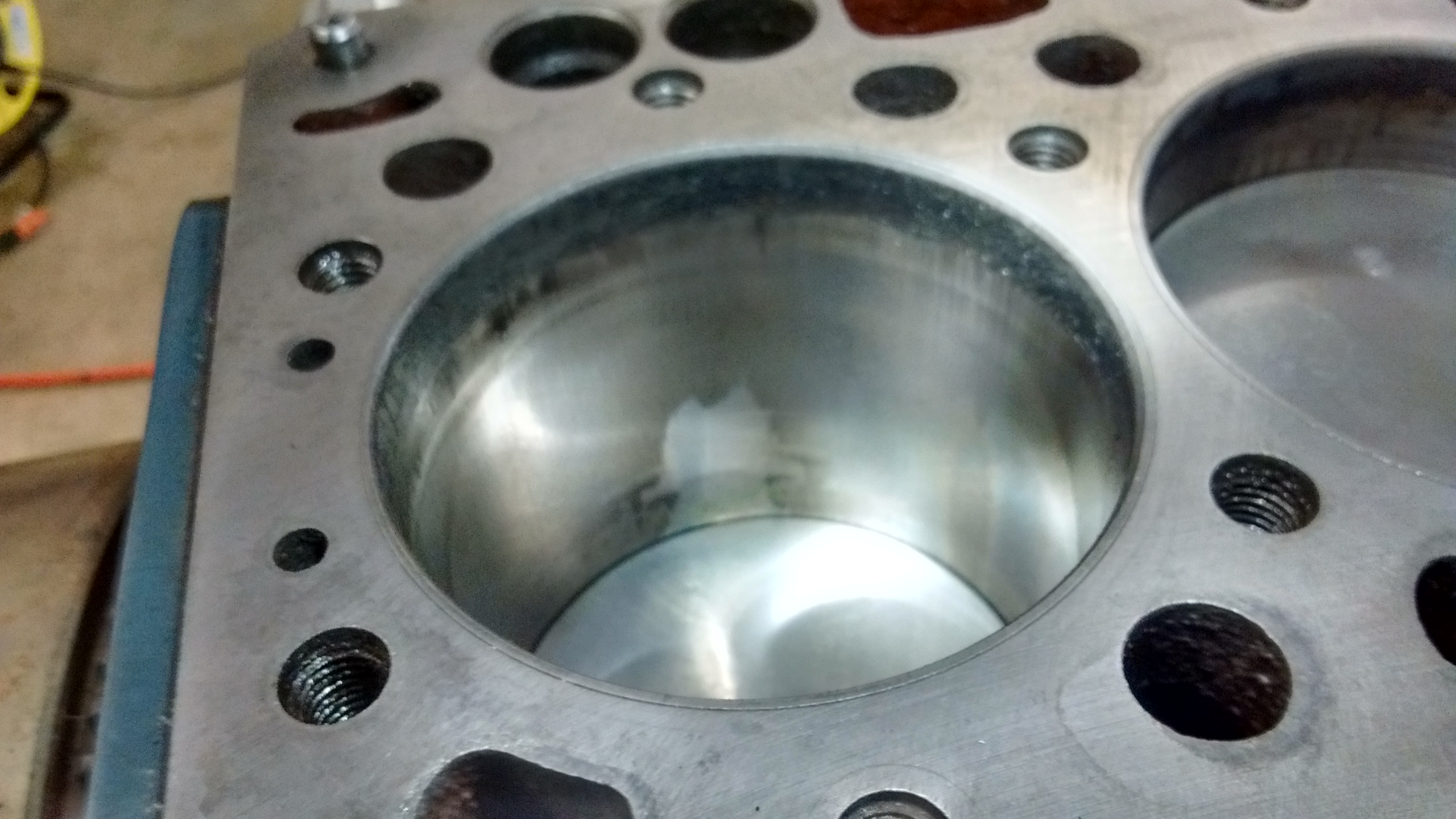

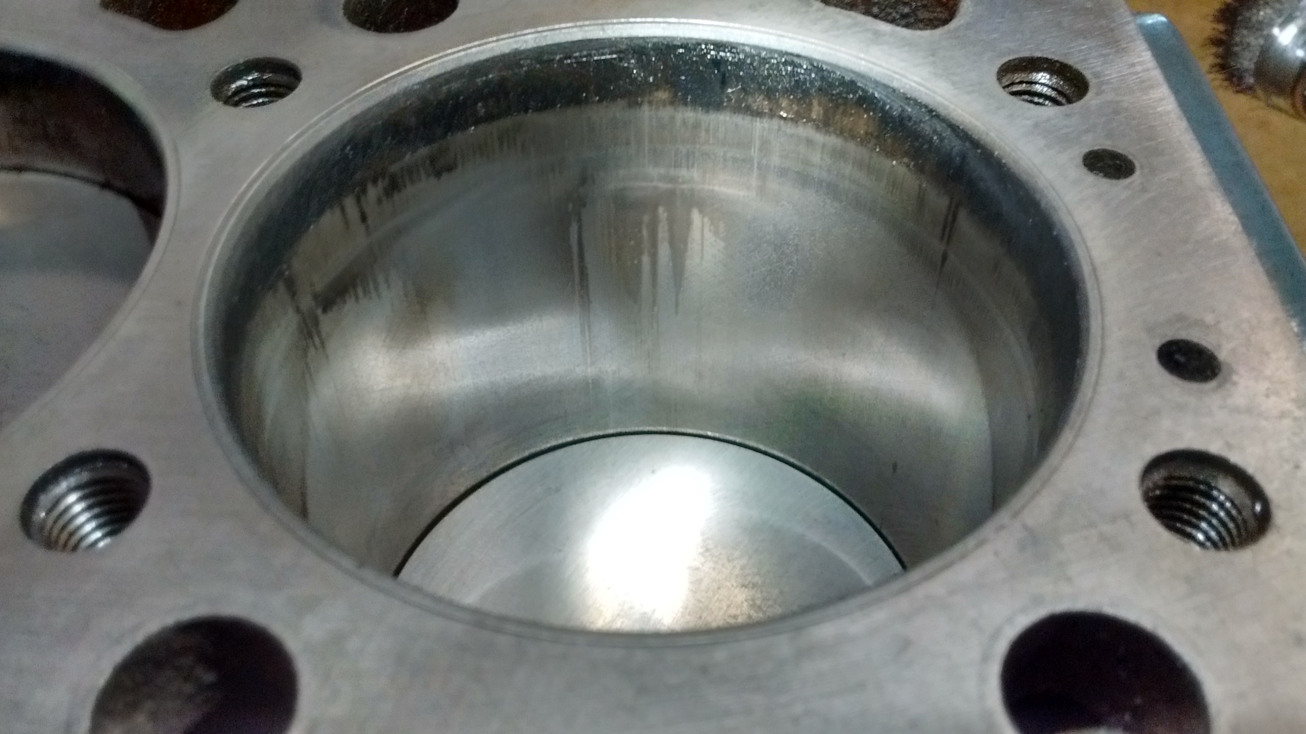

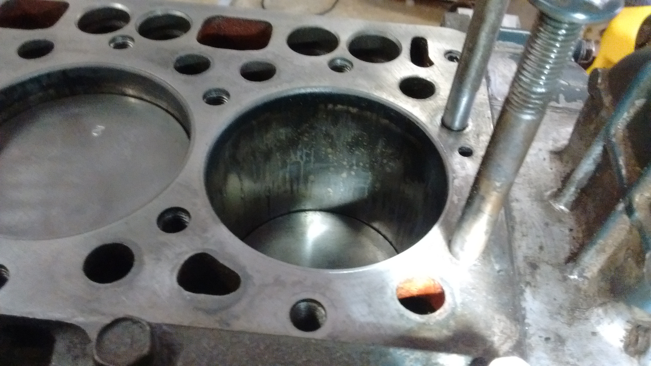

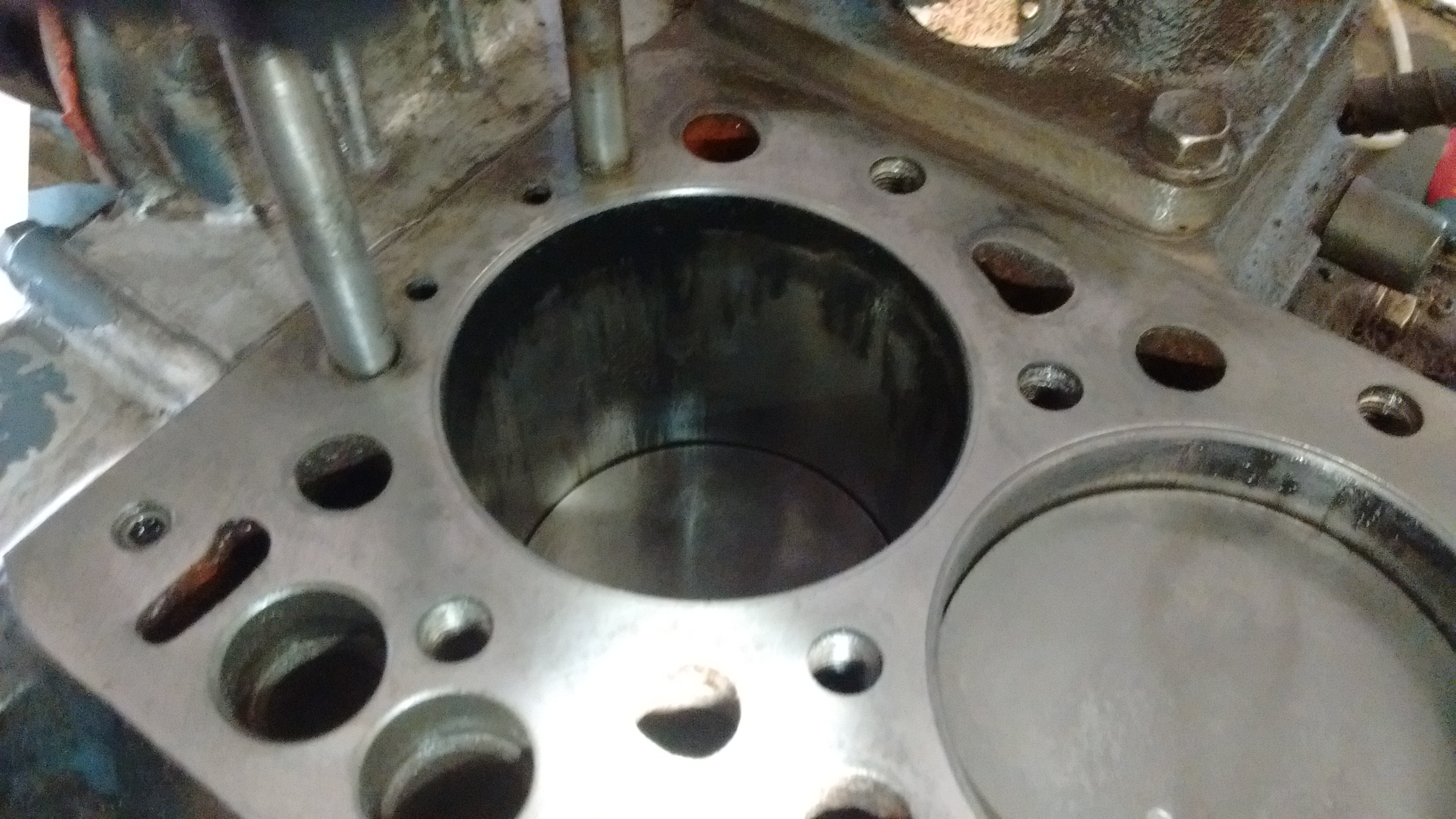

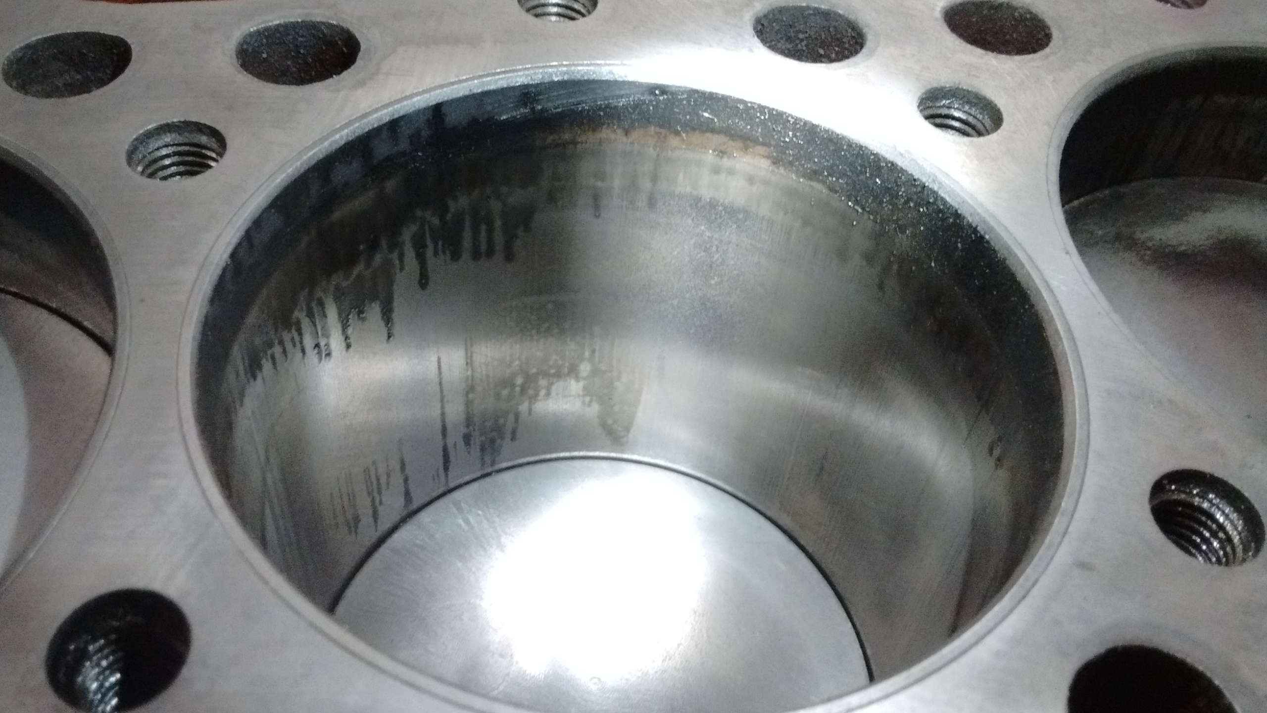

I'm not an expert mechanic so I'm hoping anyone with more experience than I would be willing to help me out. I've got a Kubota B8200 that was losing power. I'm replacing the injectors and head gasket and while I have the head off I figured I'd ask you experts on the forum if the cylinder walls of my engine look OK. I took pics from either side and would like to know if you see any problems that should be addressed before I continue.

Since you're only doing the head gasket & injectors, from my view, it looks good enough to cap it off and call it done. If you rake your fingernail over the top edge of the cylinder you can get a pretty good idea of how much wear you've incurred. From my chair here though, I think it looks pretty good.
Now - IF you were going to pull the motor, or do any bottom end work, I'd definitely mike the cylinders and see if they need to be re-bored. At a minimum, I'd hone the cylinders and go back in with new rings and bearings. However, I suspect that's much further than you'll want to go.

There really is not enough information to determine an answer for you unfortunately. If I knew the hours on the engine, or if the engine was making WHITE smoke, I might be able to help you better. That is a sign of a blown head gasket.
As for determining the amount of rebuild, there are varying amounts.
I just put a new head gasket in my generator engine (Perkins 4.108). It only had 2607 hours on it, so I did not bother to rebuild the head: it looked pretty good.
Your cylinders looked pretty good to me though.
/ Kubota engine rebuild - seeking advice #8
Cylinders do look good. Good luck,should be fine.
