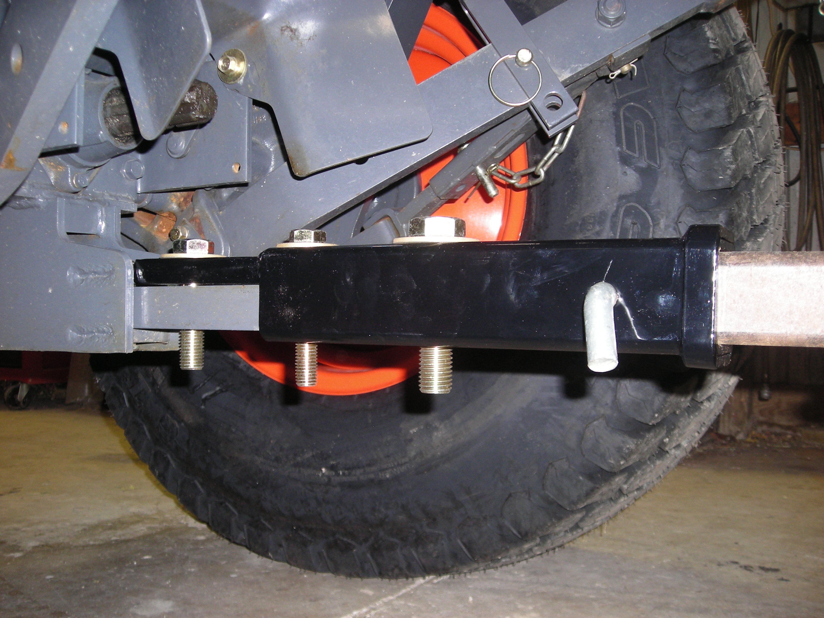

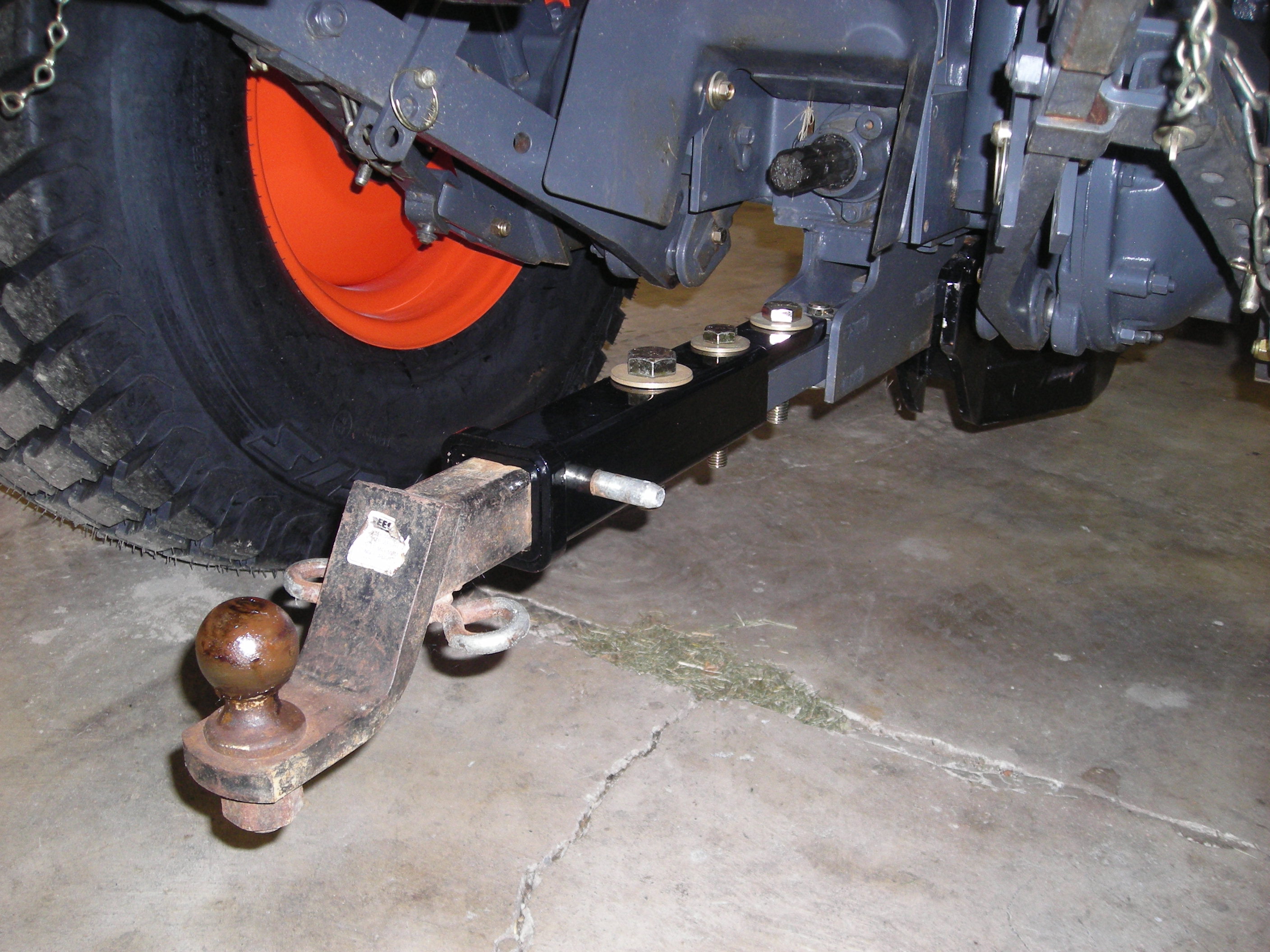

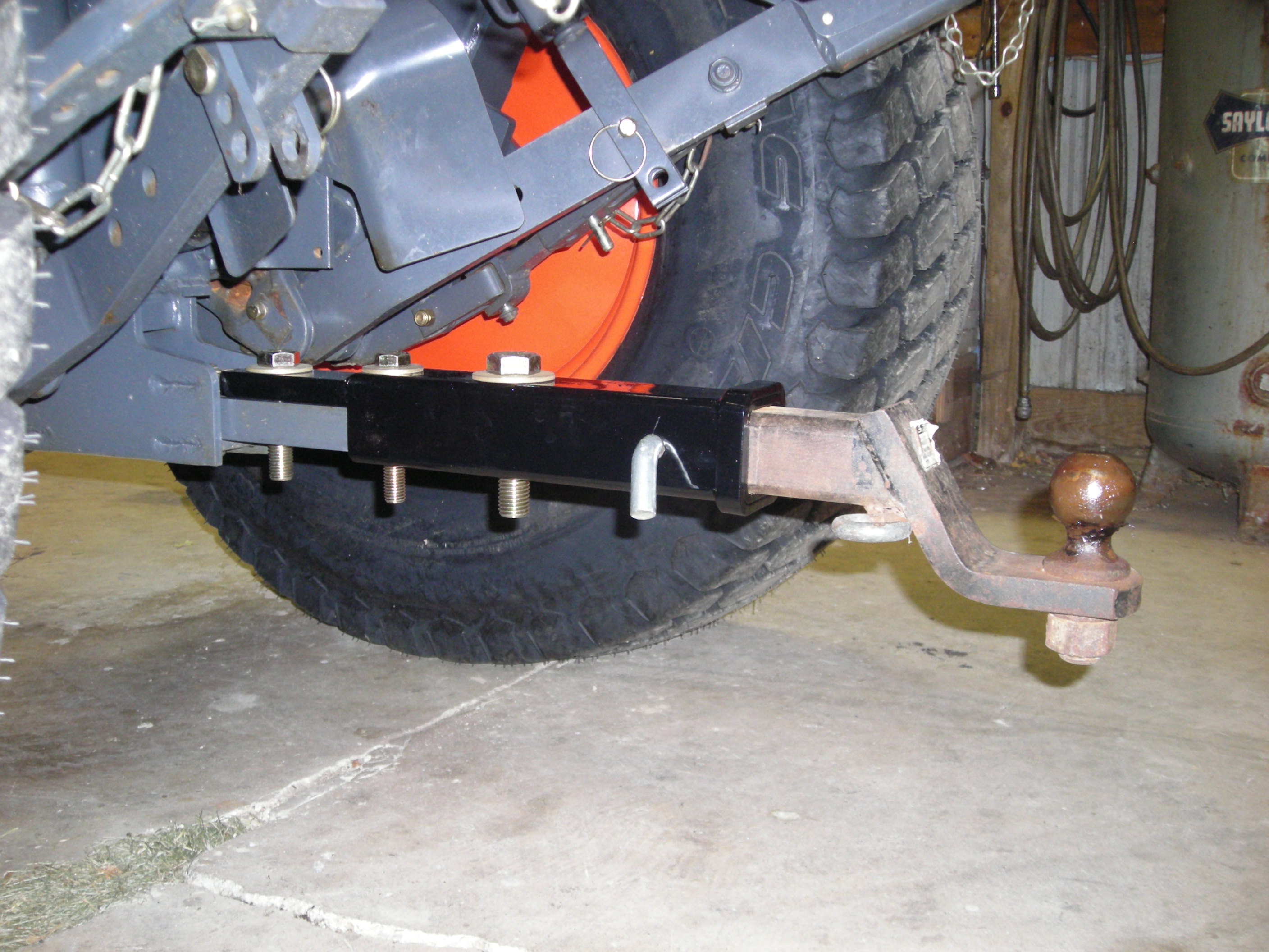

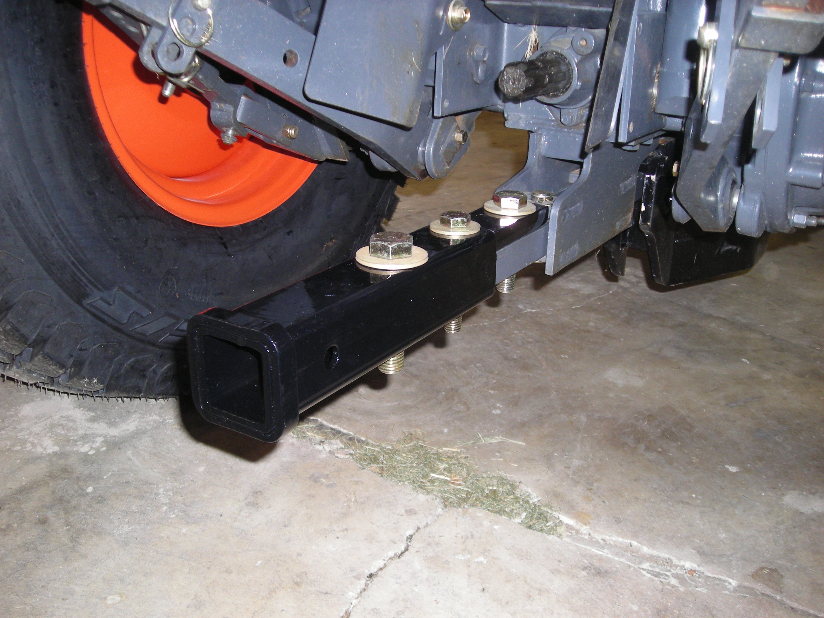

Try this. FYI, install nuts before using. Philip.
Why did you have to go to this length? Is there some reason not to just put a ball right into the Kubota bar? (besides my little hole-too-small issue)
I can use different drawbars to move ball height up and down. I can also quickly switch between ball diameters. Philip.

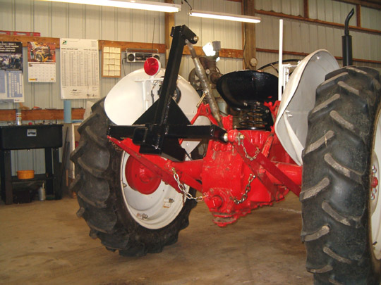

I would be worried about reduced tongue weight because of you effectively increasing the length of the draw bar. There is more leverage to lift the front end off of the ground. You also made it easier to bend your draw bar on the tractor (or damage related components).
I would think you vastly reduced the tongue weight your tractor can now safely carry. I'm sure an engineer can chime in with numbers, but I think those few extra inches equates to a lot of leverage.
Even if you have a load balanced so that there is not too much tongue weight, you also introduced leverage to move your rear end sideways easier. This can cause the rear end to slide when turning -- either pulling or slowing the load.
I have had 750 pounds tounge weight on this without a problem. Seriously now, we are moving a trailer from the back of the shed to the front of the shed at 4 mph, not going down the highway at 70 mph.
I normally use this set up so I don't have to mess with the trailer jack. Again, I have had up to 750 pounds tounge weight on this many times without a problem. Philip
