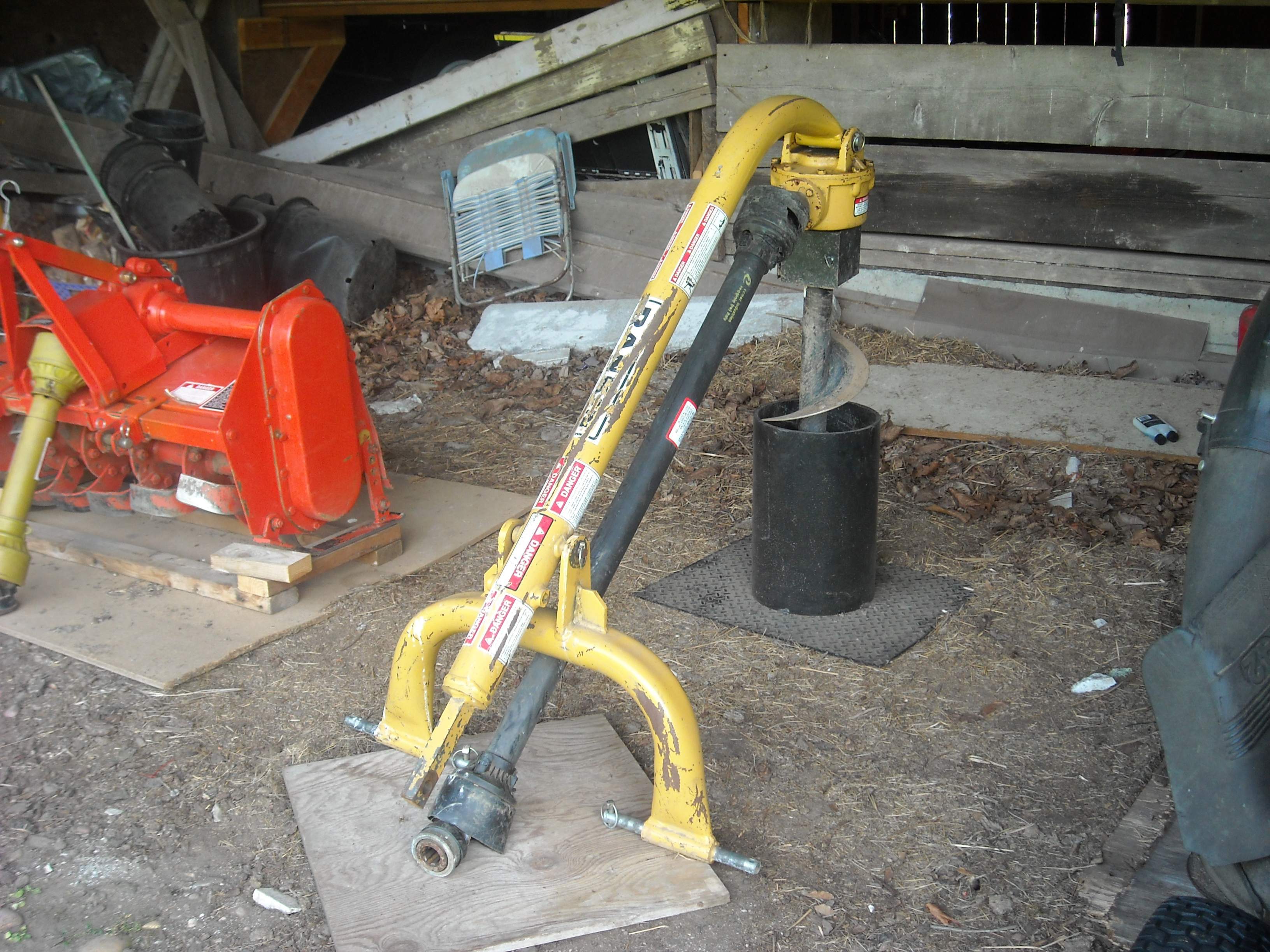

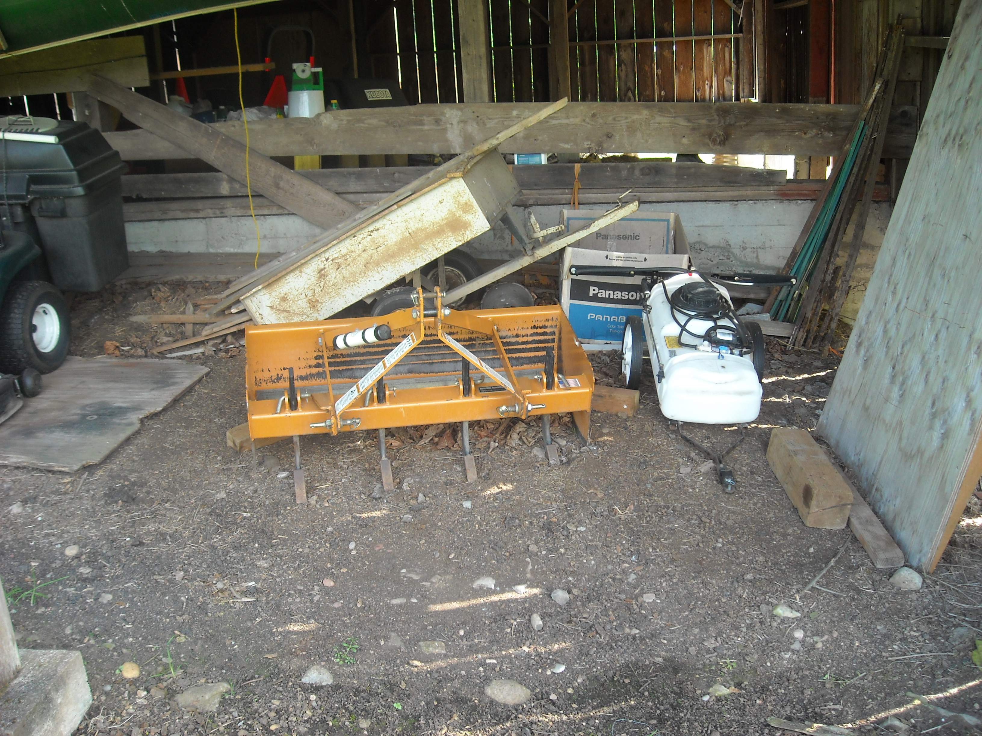

I recommend the 4' Woods box blade. Tough as nails. Adjustable scarifer teeth. With this box blade, you will have no need for a rear blade. Landscape rakes are nice though. This is how the Woods 4' looks on a BX.
YouTube - Using a Subcompact Tractor to Smooth a Gravel Driveway
Rankin PHD 301 with 9" auger. Good all-around size, and very durable.
The Kubota tillers are light-duty. My dealer recommends Machio (4' wide or less)
