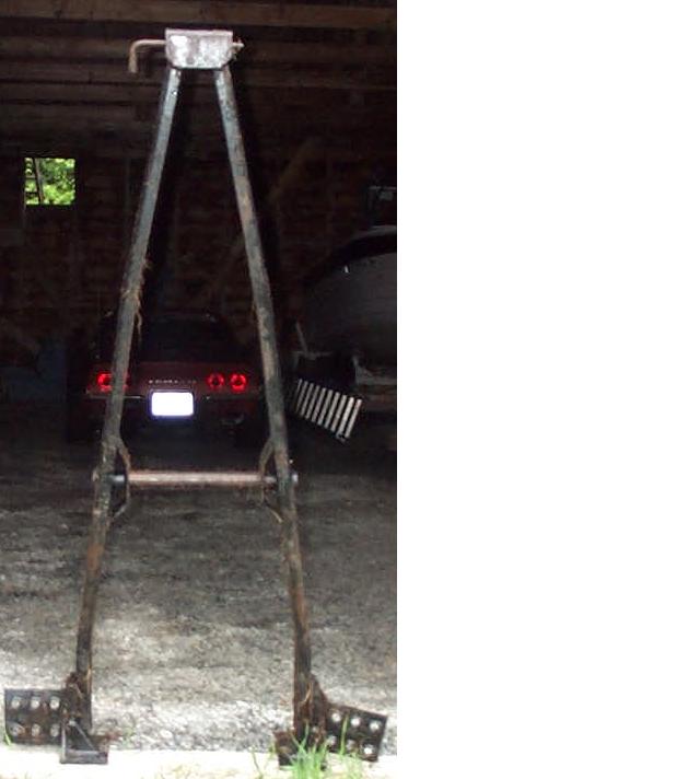

My first post after around 5 years of visiting this site. I never had a reason to post because someone else had already asked any questions I had. This post caught my attention though since I have what you might be looking for.
I have a woods 7500 on my 955 Deere. I bought it used with a subframe off a Kubota 2910. I ended up buying a subframe to fit my 955, and still have the Kubota subframe laying next to my barn.
I'll try to post a picture, in case someone wants it.
/ Kubota Backhoe subframe help #7
One note on the subframe. I have an L3130 and the BH-90 Kubota backhoe and subframe. The subframe not only included the rear framework for mounting the hoe, but it also included new side frame rails that were much beefier than those that came with the tractor.. thicker.. wider.. built to take the stress that the hoe puts on the tractor.
My brother tells the story of seeing a yanmar at his local dealer, busted in two from the stresses put on it by an add on hoe.

dh: Andirondeere's pic captures it pretty well. Someone else asked about this a couple of weeks ago and then I forgot to take pictures. I have to put the BH on tomorrow morning to get enough counter weight in the rear to unload something heavy with my FEL's pallet forks. I'll take some pics of both the main members and the mounting components and post them, probably on Friday. I'll also measure the size of the steel on the main members.
