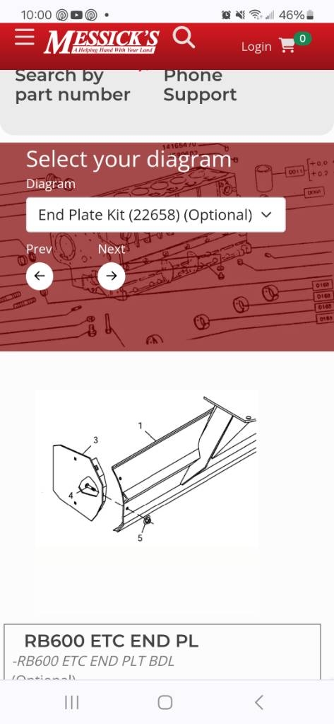

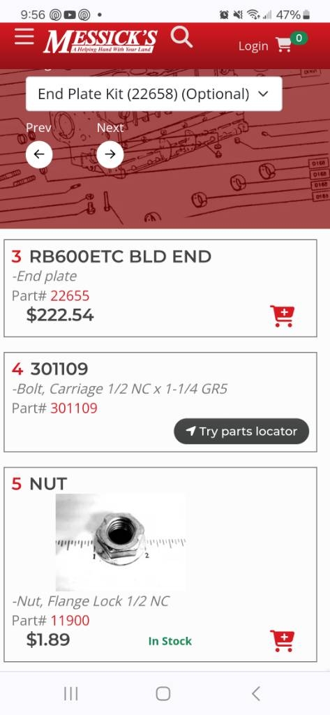

For the end plates; it 'looks' like you need item 3, 4, and 5. I can't tell if item 3 (the actual end plate) comes as a pair or if you need two? For $222.54; I would home that is both ends, but I would call and/or email to confirm if I were you.

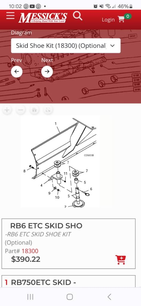

Here is the end assembly detail. There is also a skid shoe assembly available, I believe for snow plowing? For the price of those skid shoes, I would only order if you find yourself needing them, they aren't cheap.
