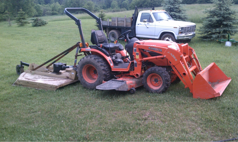

Just from my experience
I had a B2920 w/ MMM and loader. It did leave a great cut. This tractor did have a valve issue with the loader but outside if that the tractor seemed indestructible. I literally a used the machine for nearly 300 hours and it begged for more. I used (cautiously) a 72" brush cutter to clear some of my land and it handled it. This isn't recommended but it worked. I had hooks welded on the bucket and used them all the time. I literally took my mower off and loader or weekly if not more.
What I did not like was the quarter inch valving. Truly a pain. I read on here and "the other site" that quarter inch valving won't drop. FALSE. For instance if you have a 3pt implement and leave it up over night, it will be on the ground come morning. If I do that with any 3pt on my grand with position control it will stay were ever I leave it.
Also, when tilling, brush cutting, etc I always have my hand on the three point for unlevel ground and I can lower or raise and know where it's supposed to be. 4 is always 4. A quarter inch valve was just a pain as you can raise and lower and you'll get used to it but definitely not as nice as position control.
With all they said, the b2920 is a beast of a tractor and I had great experiences with it.
