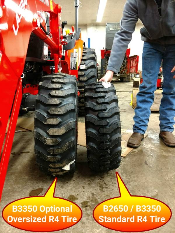

I run the wheel and tire package that is optional when buying the B3350SU.
According to a Kubota engineer response, it costs me 7.?? Percent of the designed gear reduction.
But, it adds a lot more fluid fill weight for my hills, it takes my width to 60.5" in the rear, it gives more aggressive tread design and it has much greater surface area... So it has at the least, equal or possibly less ground pressure per square inch to allow for less damage the grass.
Oh, and it looks cool as heck View attachment 550173View attachment 550174View attachment 550175View attachment 550176
Great photos of the standard/Optional R4 tires.
I bought a new B3350 this past Wednesday. I specified standard R4 tires because I may use it with a MMM in the future. I did not buy a MMM at this time.
I'm replacing a very good late model Ford 8N with the 3350. I use the 8N only to pull a 60" rotary cutter in areas that do not look well if I use one of my larger tractor/mower combinations.
I try to keep overall tire width more narrow than mower cutting width. The B3350, with AG, turf or standard R-4 tires is well within 60." I did not know the overall width of the Optional R-4 tire package.
I can live with 60.5". I just measured the overall width of my 8N with one size oversize tires (12.4X28) adjusted about as close as possible without fender clearance with tire chains and it is about 63+". No significant issues with mowing quality.
This week, I will change my tire specification to the optional R-4s so as to increase ballast weight and contact patch. If I ever decide to install a MMM on this tractor, I will buy a set of turf tires/rims.

Note that I'm at 60.5" rear width WITH the kubota 1.5" wheel spacers added, so 57.5" with the optional tires and no spacers. I believe it's 54" with no spacers and the standard R4 tires.
Gotcha. The taller tires will definately hurt you on hill climbing ability. 7% doesn't seem like much, though.
Again, I have to wonder why it won't go up the hill in L range any better than M range? Just doesn't make sense.
