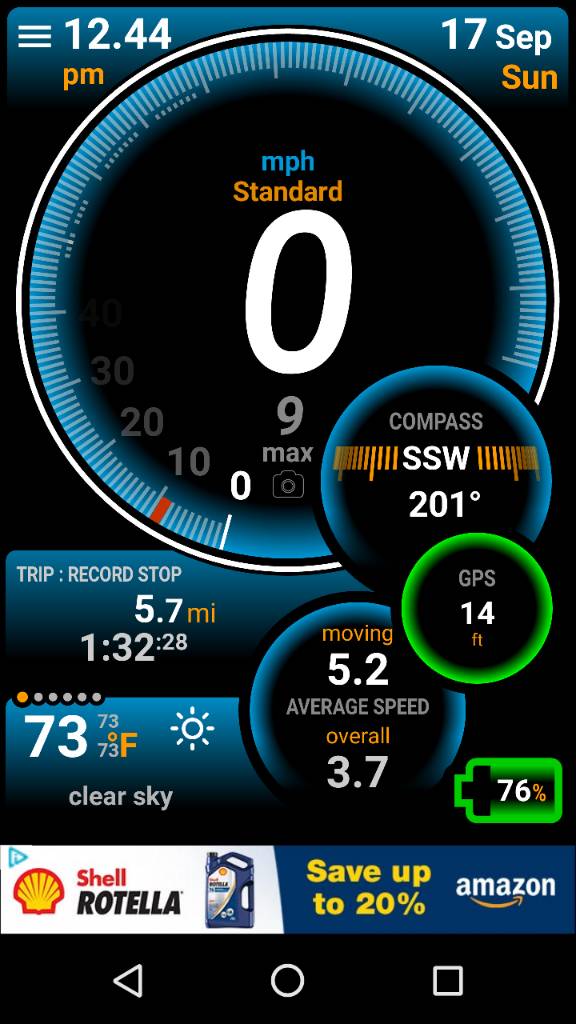

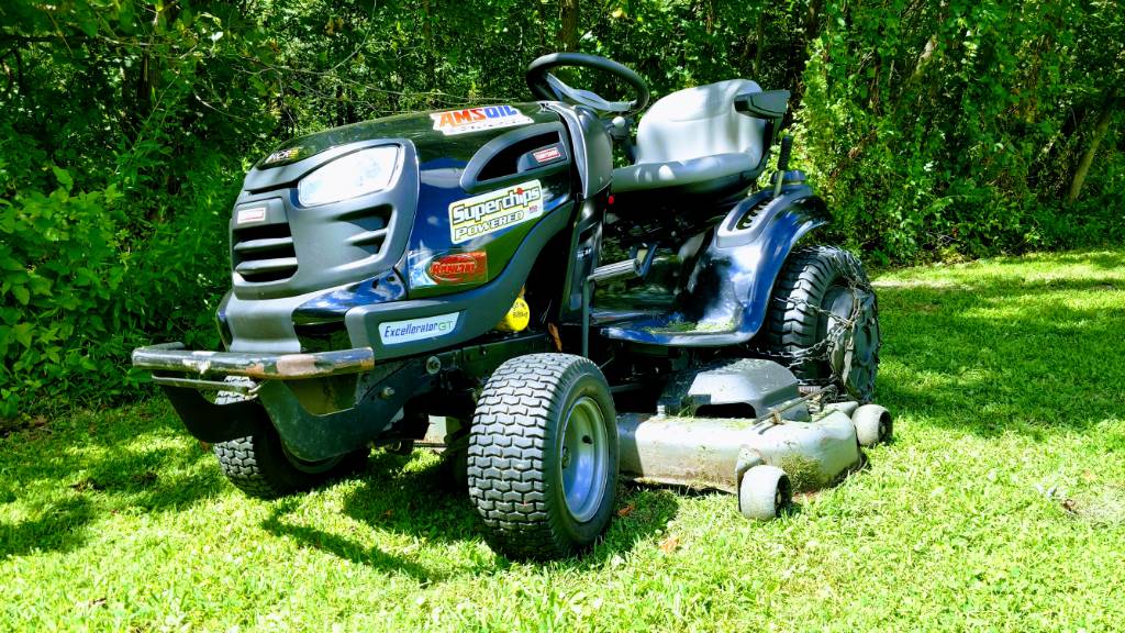

LOL, I love my little 26hp garden tractor though. I dread it's demise, with about 600 hours on it... I'm not sure how much life is left in the Kohler Courage it in the Hydro Gear G730 transmission. I have run Amsoil in the Kohler since new, so I hope that the oil adds time to the EPA class C (500 hour) engine, and I change the HST filter and use Cub Cadet branded HST every 200-ish hours. So I'm really wanting to see 1000 hours from this thing! But it cuts fast, nearly home owner zero turn speeds being 6.5 mph. I average over 5 moving mph over the 5.7 miles that run it cutting the yard. IMG_20170818_145017144_HDR-EFFECTS.jpegScreenshot_20170917-124439.jpeg
