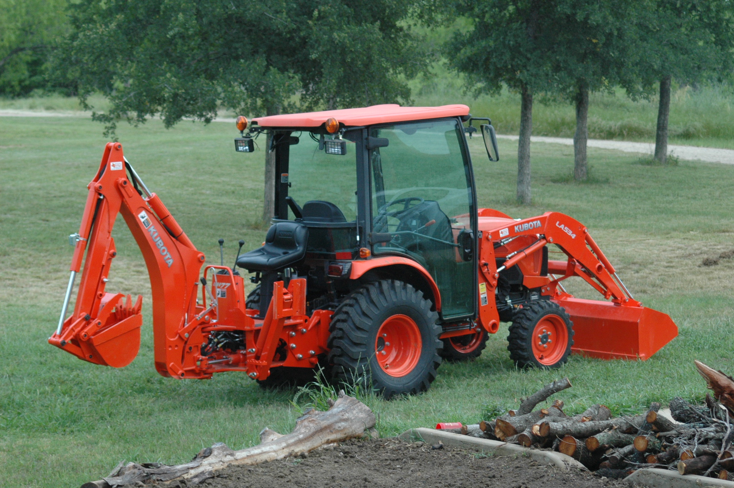

Seems to be very few 2650 or 3350's out west. I flew 250 miles to see a 2650 today. First impressions:
With cab closed, engine noise was well muffled and hydro whine was not as bad as expected. It is the dominant sound, of course, not overly loud (for a tractor). Fit and finish, especially on the cab was very good. The rest was typical Kubota, which is to say not bad at all.
Now I just have to decide if I want the 26 or the 33. I'll be installing a 62" front mount snowblower and I live almost a mile up, so the 33's turbo and additional horse power would be welcome in the snow, but those extra PTO ponies cost $500 each!
Comments or advice is most welcome.

62" front blower combined with high altitude, 26hp will most likely lack power in wet/heavy snow situation, it is not a brute, even just for loader work, it could use the extra ponies.

Thanks for the link, though I have previously read it, and most everything else I could find over a few weeks of searching! Honest, I've tried to do due diligence on this (it's a lot of money!). Since the 3350's have only recently started delivery, there's not a lot in the way of reviews . . .
I previously owned a 24 hp Kubota, one of the first HSTs, so am aware of the bogging down thing. However, since these two tractors share the same hydraulic flow and pressure, I was assuming that those systems would behave the same. And the extra horsepower and torque of the 33 would only be apparent in top speed and at the PTO's . . . No?? So I'd think loader and BH bogging down would be the same, but not so with the snowblower driven off the PTO of course.
I am concerned about not having enough HP for the blower with the 2650. Some say the rule of thumb is 5HP for each foot of snowblower width.

When considering the two models - even though the larger version has more HP - some of that power will be lost with the fuel soaking DPF muffler - all in all the best bet is the 2650 you get a clean engine and you have $5k for fuel or goodies to hang on the beast. I have a B21 and while it does not have ton's of power, its fine and will dig like crazy.
/ Kubota B2650 & B3350 #53
When considering the two models - even though the larger version has more HP - some of that power will be lost with the fuel soaking DPF muffler - all in all the best bet is the 2650 you get a clean engine (new 4 cylinder) and you have $5k for fuel or goodies to hang on the beast. I have a B21 and while it does not have ton's of power, its fine and will dig like crazy.
Not arguing about which is best, but to keep the record straight:
The B2650 has a 3 cylinder engine while the B3350 has a 4 cylinder engine (bore and stroke is the same).
The B3350 does have the "nasty" DPF, but it has a turbo to make up for the DPF power loss. This may be more important if you live at a higher altitude as a normally aspirated engine looses 3% per thousand feet.
So I'd say it depends on one's circumstances as to which is the better choice.
