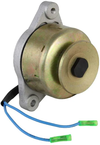

These have a standalone rectifier/voltage regulator. Some are 2 wires, others are 3 wires. The B7000 I had, had a 3 wire one, while the Kubota D640 engine I have on my backhoe came with a 2 wire alternator and I had to buy the rectifier for it.
There are rectifiers/voltage regulators available out there for each type of alternator.

I believe Kubota refers to them as a 'Dynamo' and it's basically a permanent magnet DC generator with minimal DC output. Problem is, the minimal DC output is insufficient to power anything but recharge a the starting battery and power a few lights. I would replace it with a one wire GM style alternator of sufficient amperage output to power what you require. One wire alternators are internally regulated so hookup is simple. Of course you will have to fabricate the necessary mounting brackets and match the drive pulley to the existing tractor pulley configuration.

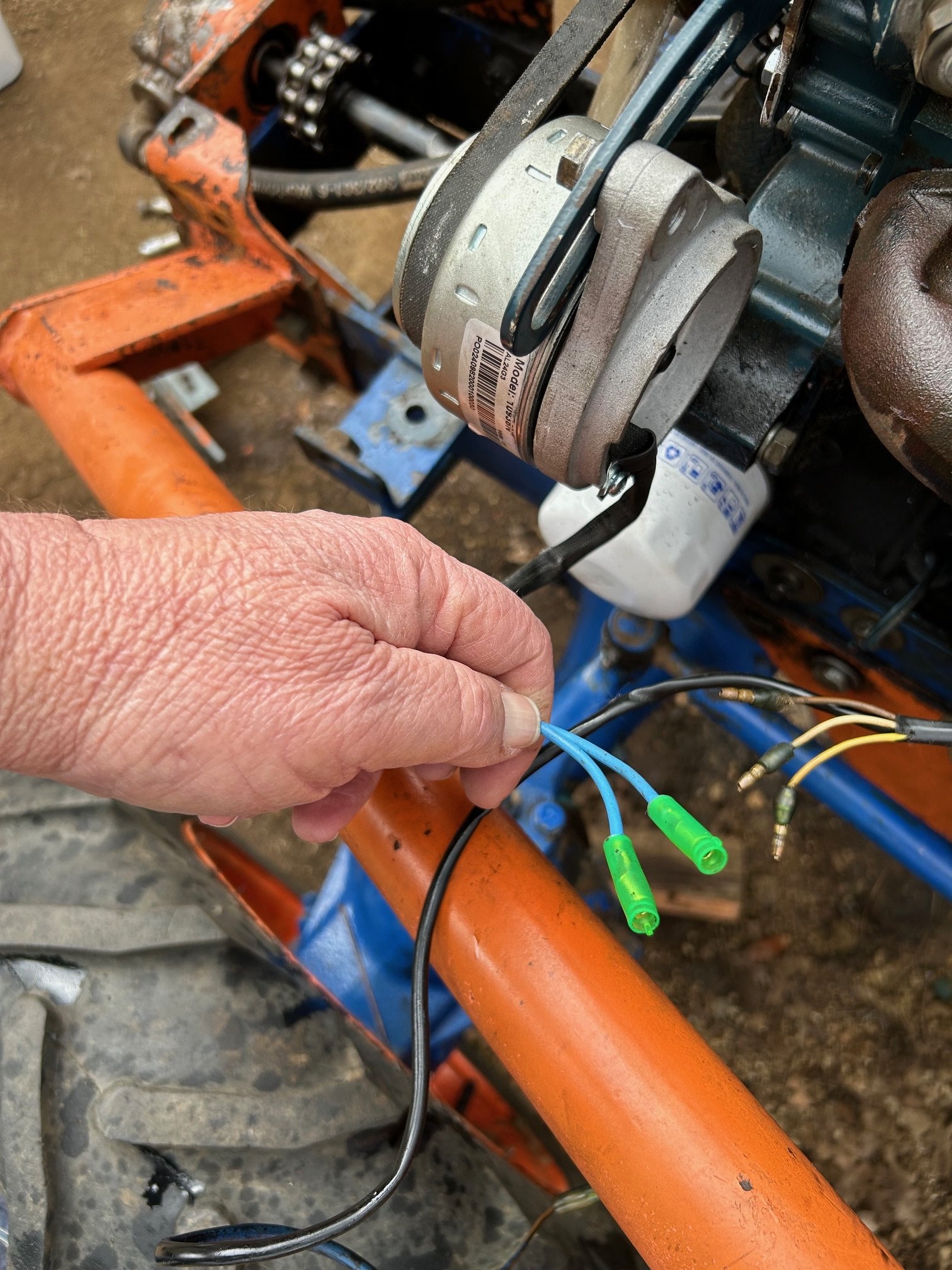

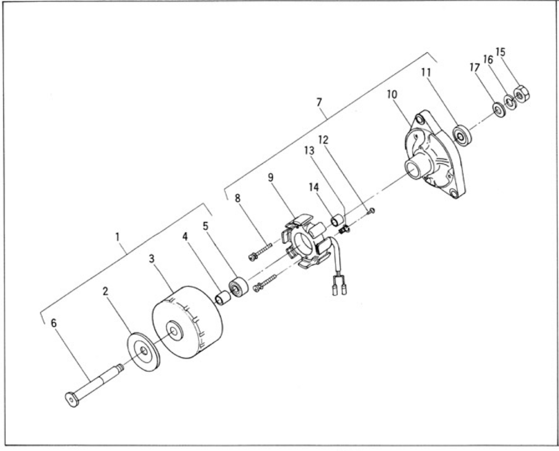

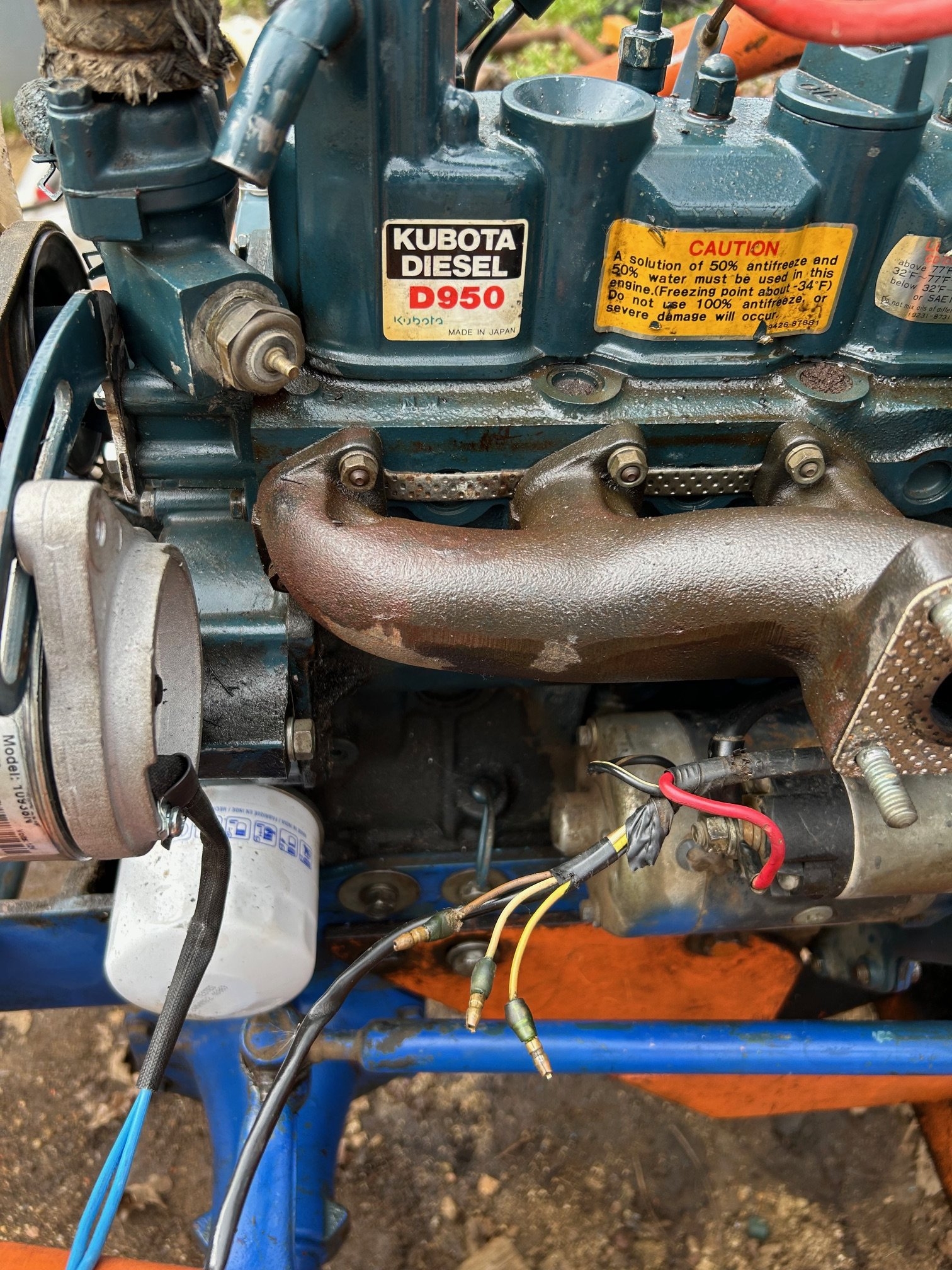

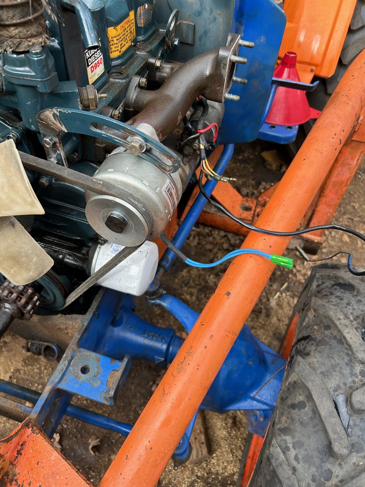

Thanks for the replies. A few photos are attached. This new engine is a later model.
OK. It seems this "alternator" is barely up to the task. Can you just bypass the Kubota wiring and use any old alternator/regulator and go straight to the battery?

That dynamo is AC output, all day, from what the diagram shows.

You must have an external rectifier/regulator module in your tractor that converts unregulated 2 wire AC to regulated DC.
Almost all newer alternators include internally, rectification to DC, and also many have internal voltage regulation , so depending which you get , will determine if you bypass the original rectification/regulation

Yes, electrically you can use any alternator/regulator pair that will physically fit. They all put out twelve volts. How much amperage (current) that they can potentially put out doesn't matter to the battery or the electricals in your tractor. The battery and electricals in your tractor will only take as much current as it can use.
All alternators makes their power when a magnetic field moves past a stationary coil - or a set of coils called the stator. The difference in low output and higher output alternators is in how they make that first magnetic field.
A small tractor or motorcycle alternator - often called a magneto type - uses permanent magnets in a spinning rotor to make its initial magnetic field. It spins that field past a stationalry set of coils. This type of magneto/alternator is small, lightweight and doesn't rob much horsepower away from the tractor or motorcycle when it is doing its work. It makes 12 volts or even more, but its amperage output is low.
A magneto type alternator can charge a battery while a small headlight or two are on, but not much more than that. Because it does not rob much HP to do its work, the pulley and belt can also be lightweight.
It's a nice fit for a little diesel tractor that doesn't need much electricity to run.
Cars and such use a heavy duty alternator doesn't have permanent magnets. It needs a more powerful magnetic field than magnets porvide, so its spinning rotor is actually a big coil wound into an electromagnet that is self-powered. This electromagnet is much more powerful than the permanent magnet type in a magneto rotor. With the big magnetic field and lots of heavy wire for multiple stator coils. This big modern alternator still puts out 12 volts, but can potentially put out much more amperage and can charge several batteries while also running heat/AC and multiple headlights on a car.
The downsides of that big car alternator on a tractor are it is large, heavy, and robs a lot of horsepower to do its work. Plus the pulley and belt have to be heavily built to handle the hp required by the alternator.
BOTTOM LINE: The sweet spot for your tractor is to use an alternator/regulator pair from a small imported car like a vintage Datsun. They are inexpensive and have the rectifier plate and regulator built right into the alternator body.

Actually sweet spot is using a alternator that is internally regulated and one can eliminate external regulator....

One of my motorcycles runs an aftermarket permanent-magnet alternator and a combo rectifier/regulator unit, so I have some familiarity there. I like the idea of the "one wire" alternator for the Kubota. I'll suggest that. The owner has a well-equipped welding/machine shop at his home, so making a bracket is a simple process.
