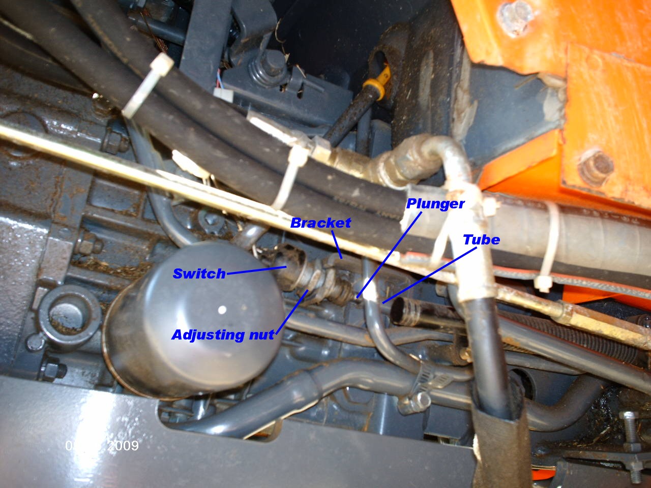

I was fighting the HST switch on my L3830 - Did a quick search to see if anyone is having a simular problem and stumbled upon this link. Though the 3830 has a different set-up, I was able to quickly located the switch on mine. It runs off of a cam type set-up so I cleaned the area up and gave it a few shots of WD40 and seems to be working fine now. Thanks for posting the pic's and all the helpful advice.

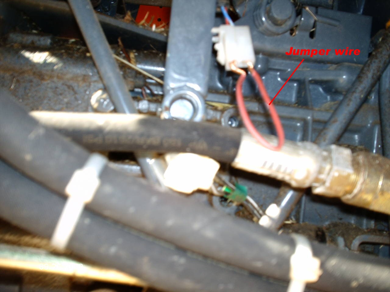

This thread saved me a lot of head scratching; over the years my B7500 sometimes wouldn't crank, but it was always either the PTO lever had moved into gear after I shut down or the HST pedal wasn't centered; yesterday, it wouldn't start no what I tried; found this thread and the pictures of where the HST saftety switch is located on the B7800 (same location on B7500) and saw the rod for my HST pedal switch wasn't aligned with the switch; bypassed the switch for now to get it running; snow storm tomorrow; thanks TBN members!!

Had a B7800 some years ago and after experiencing the no start issue and trying several fixes finally discovered the foot go pedal has to be centered or no start and later was established this was a common problem on the B7800.

THANK YOU, herringchoker, for such a clear diagram of where the switch is. I was under my 7800 and wasn't sure where to look.
