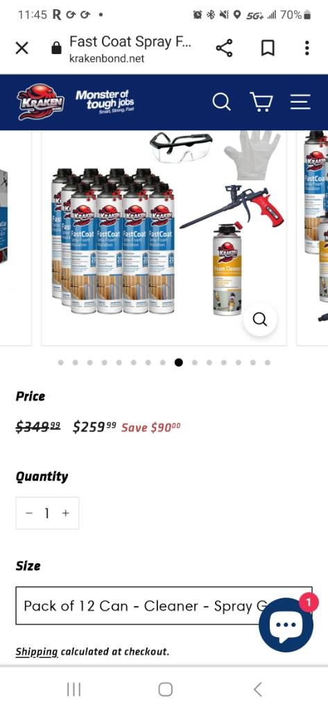

Anyone used the Kraken Spray foam on the metal panels of a pole barn walls/roof? I have a 16ftx24 ft pole building that has been cobbled together over the coarse of 15 years, that I tried to insulate with 1/2" rigid foam. Like about all pole buildings, there are gaps, and this one is probably worse then most, as I used a mix of new and old metal, and new/old poles and purlions, and the shed started out as a 12x16, and had been added on, about 10 years after the first part was built. I have a 12000w window unit in it, and it keeps it tolerable, but I know I'm loosing a lot of air through many gaps, and poor insulation. Dogs stay in shed at night or when we go anywhere, and without the AC, it would be 100-120 degrees in there. I dont care about getting R40 or anything, just want maybe R5 on walls, maybe R11-13 on roof and the air gaps closed. I dont want to spend $300-500 on the 'froth packs'; but a $200 Kraken Kit 'seems' like it might fit the bill. Anyone use them? Happy, unhappy, durability? Walls are only about 8 ft on the high side, like 7 ft on lower side. I would plan on removing the rigid foam before spraying, and maybe reinstall; or maybe foam ceiling and reuse rigid foam on walls?

No I haven't talked to a contractor. It's just a pole barn with a window unit, work shop and place for the dogs. I dont care enough to drop $1k; but if $200 can be used to apply a 3/4" layer, and seal up the gaps, that would be great. I think it runs approx $1/1 sq ft at 1" thickness with the Kraken foam.
Similar (maybe same company) seems to be very popular in eastern Europe(based on YouTube), and just available at their hardware stores. Not sure why the small disposable cans haven't been more available in US? It all has to be ordered online, and 1 can plus gun, plus cleaner, is only a bit cheaper then 6 or 12 cans with gun and cleaner. Would be nice to try a can and see if it works OK, before ordered a 12 pack, and finding its a waste. 12 cans, plus gun, plus cleaner is $259; 2 cans plus gun, plus cleaner is $90. Heck 6 cans, plus gun and cleaner is $185.

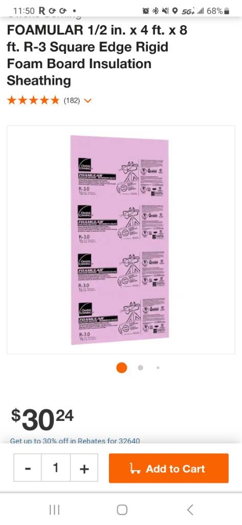

By their math, 16x24; at 1 inch, that would take 20 cans, for the ceiling. I'd be happy to place 10 cans at 1/2", and a R3.5, if it would apply that thin. Dang 1/2"×4×8 rigid foam is expensive, not to mention it doesn't seal worth crap. unless you Great Stuff the joints.
/ Kraken Spray Foam?
Conventional fiber glass is hard to retro fit in a pool barn, and doesn't do much for stopping air.

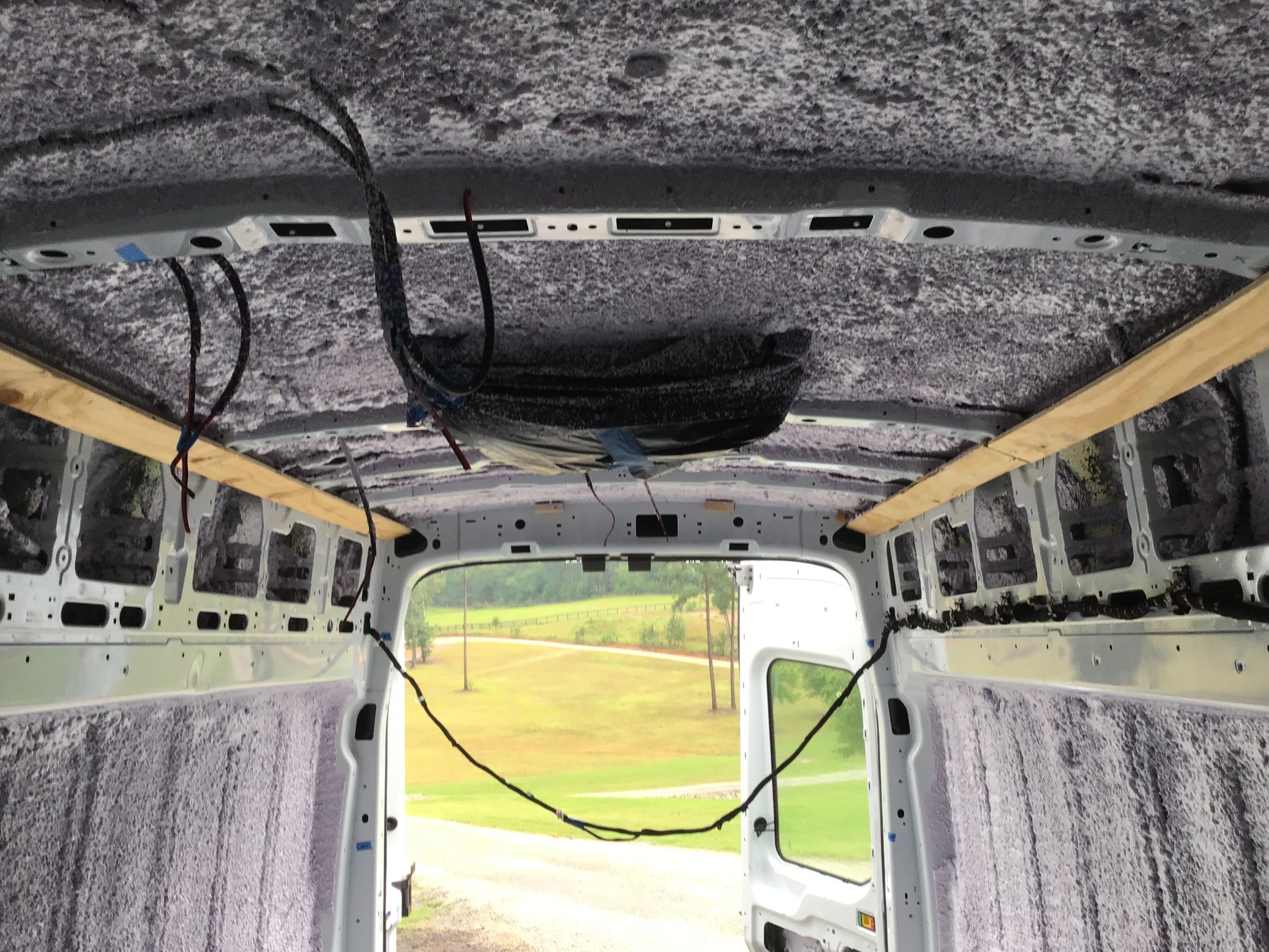

I recently used closed cell spray foam cans (20 oz each) to insulate a Ford Transit Cargo van. They actually worked really well for my use. I bought a kit off Amazon for $275(?) that was 12 cans, gun with adjustable rotating nozzle, zoot suit, mask, goggles.
Have you thought about leaving your rigid foam in place, and just use the spray foam to spray over and around the edges to close up any areas with a void? I would think that would be better than stripping down your rigid foam. Just my 2¢.
The big difference in using the closed cell cans is there isn't much expansion at all. Maybe 2:1, 3:1 at most. Why? Because the foam in the can is already mixed with the 2 parts. The "propane tank" kit doesn't mix the chemicals until it hits the gun nozzle. Thus the higher expansion rate. These cans are filled with the foam pretty much already expanded.
Single component and 2-component urethane foams are different chemistries (related but different). The foam isn't "pre expanded" in the can, it just needs exposure to air (and mainly moisture in the air, IIRC) to foam and cure.
That van looks like the kind of thing that is a small enough area for these smaller cans to be appropriate, IMO. Good to see you were able to get a decently uniform coating, so perhaps it is a possibility for the OP, but I still think it is a bit impractical there.

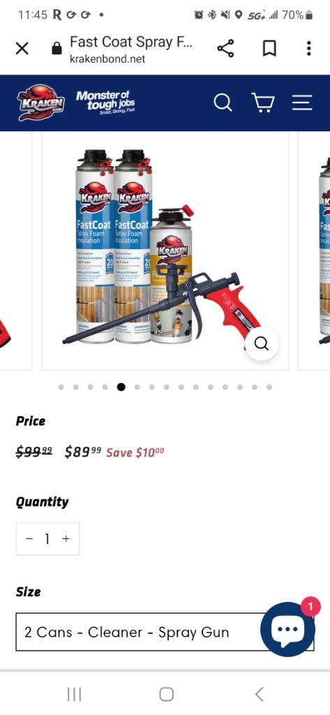

Well, a year later, I might as well give an update. I finally bit the bullet and ordered the 2 can, 1 cleaner, and gun pack for like $87. Used the 2 cans of foam, both on awkward parts of the cieling/underside if the roof, where rigid foam either would be a pain to attach or where it had odd wires/ect. The foam went about as far as advertised maybe, I covered more square feet, but not at a full 1".
Several observations; it isn't too bad, but it is hard to get a consistent/even thickness; if you overlap previous spray, you get thick areas; if you don't, the outside edge of the "fan" is thin.
In tight areas, the cieing nozzle is good, and bad; if you turn the gun/can too vertical, it doesn't spray well; but you can get in areas that would be difficult to cut/fit/seal with rigid.
It doesn't expand as much as maybe I hoped; but I'm thinking it did help a lot on air sealing.
I haven't made up my mind on picking up 6 more cans; or getting some more rigid foam, but for the walls; it's gonna be rigid and maybe traditional spray foam on the seams.
It isn't that messy; but it's a fine overspray of foam that gets on you and everything else.
