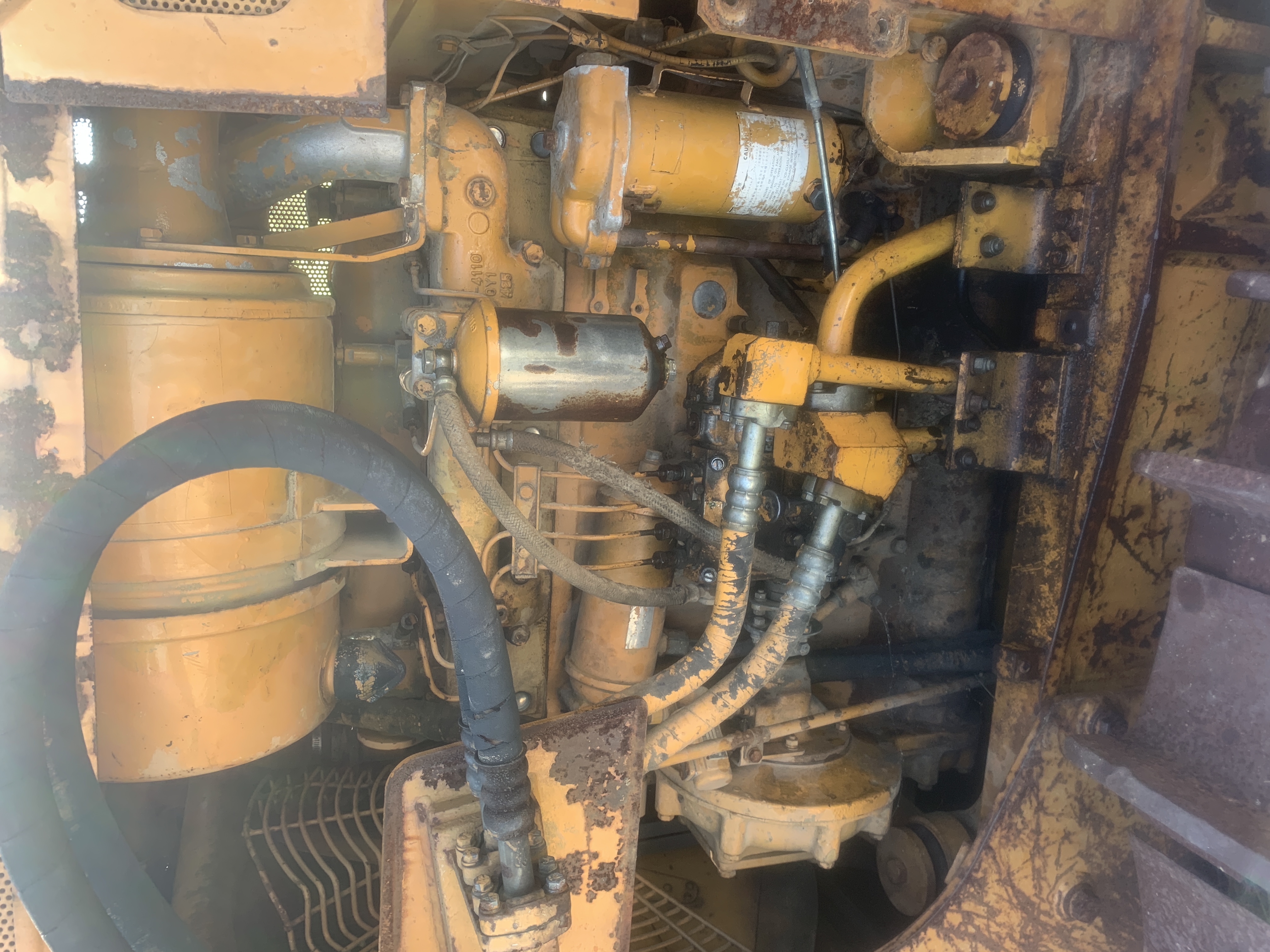

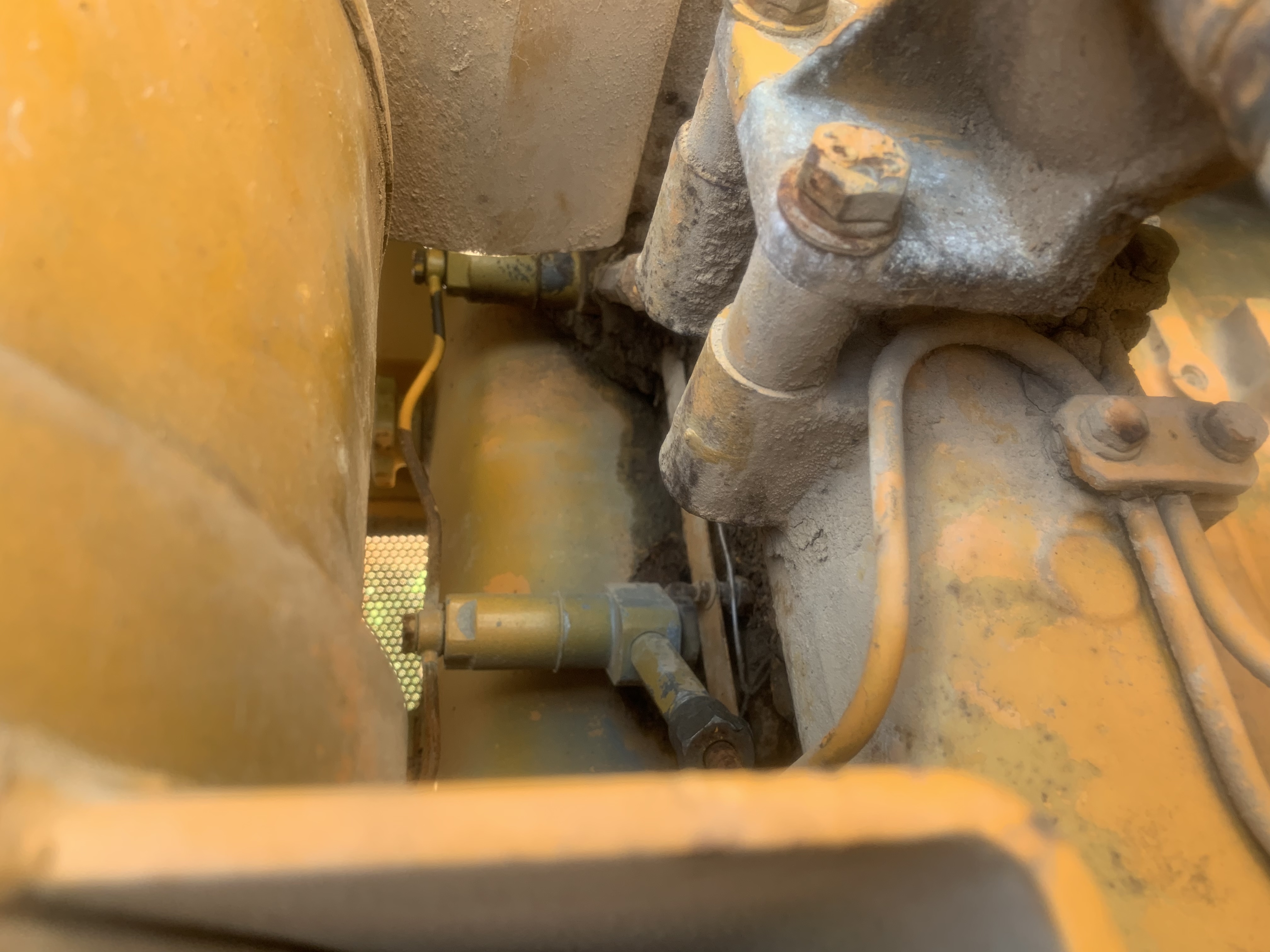

As a side note: one time my dozer wasn't running right and I changed the fuel filters, it didn't help. Then I found a "small" screen "in" the pump at "inlet" of it! I took it out and it looked clean, BUT I washed/brushed it good, blew it out with air pressure, reinstalled it and the dozer has run fine ever since!
SR
Im expecting to find something like this hiding somewhere... and I won't be suprised at all if it is the culprit
/ Komatsu Dozer wont start
#62
6 months later, nothing has changed...

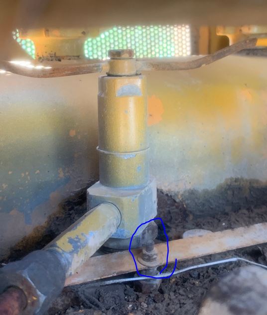

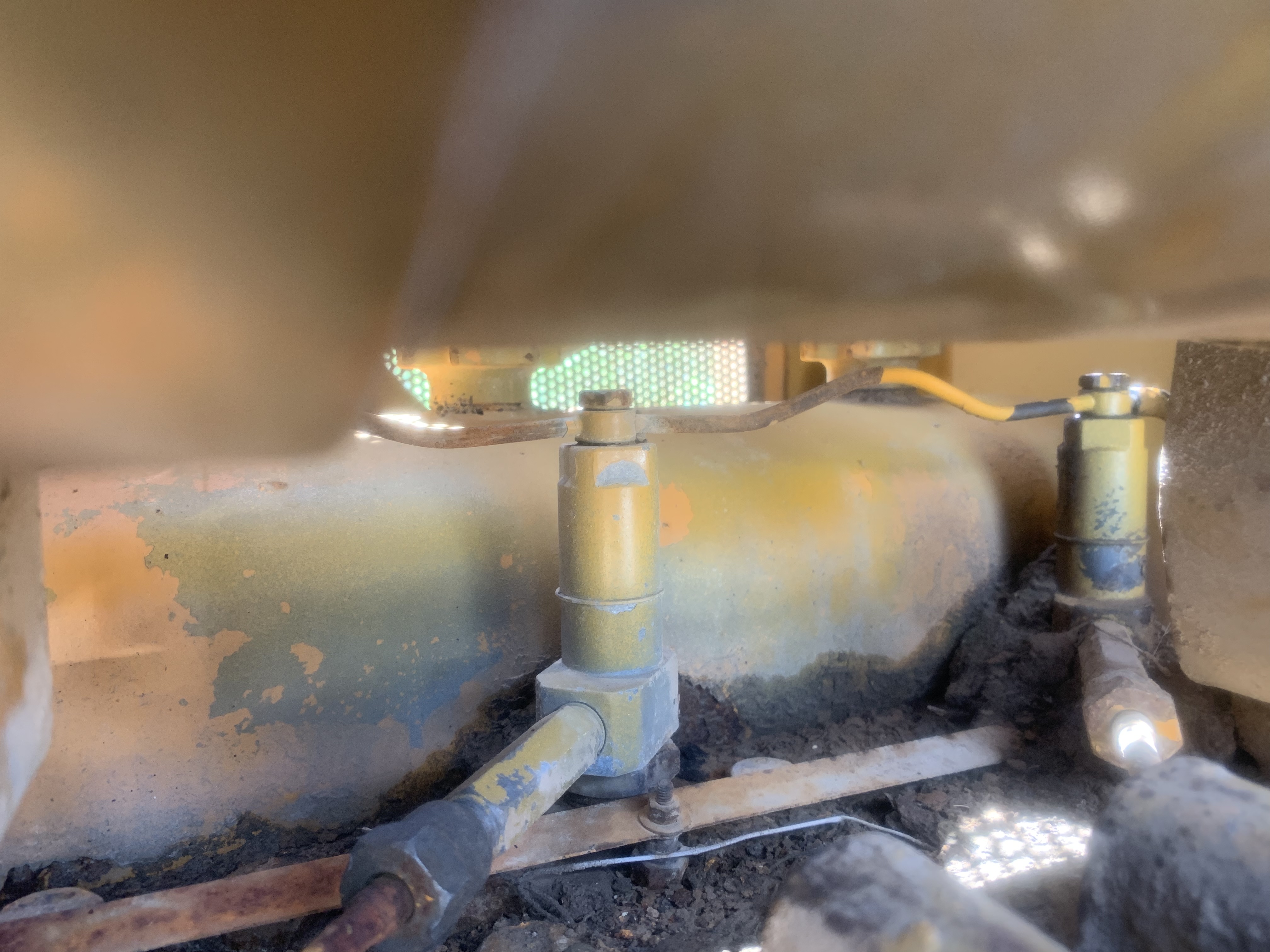

3 manual primer pumps later and still they die after about 5 minutes. I am going to try to blow air back from the fuel filter housing all the way to the tank again. It would be so much easier if the fuel tank could be pulled off and cleaned
#63
It’s alive!!!
we finally had a few days to focus on it and after rebuilding the pump that the primer was on, replacing a collapsed fuel line, and fully charged batteries it fired up and ran!
father in law then had the bright idea to fill the fuel tank and add some cleaner stuff to it. Now I’m changing fuel filters about every 10 minutes. Gotta be a better way to flush out that tank and get rid of the crap than $22 filters every 10 minutes
