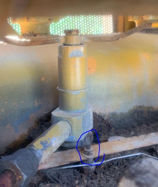

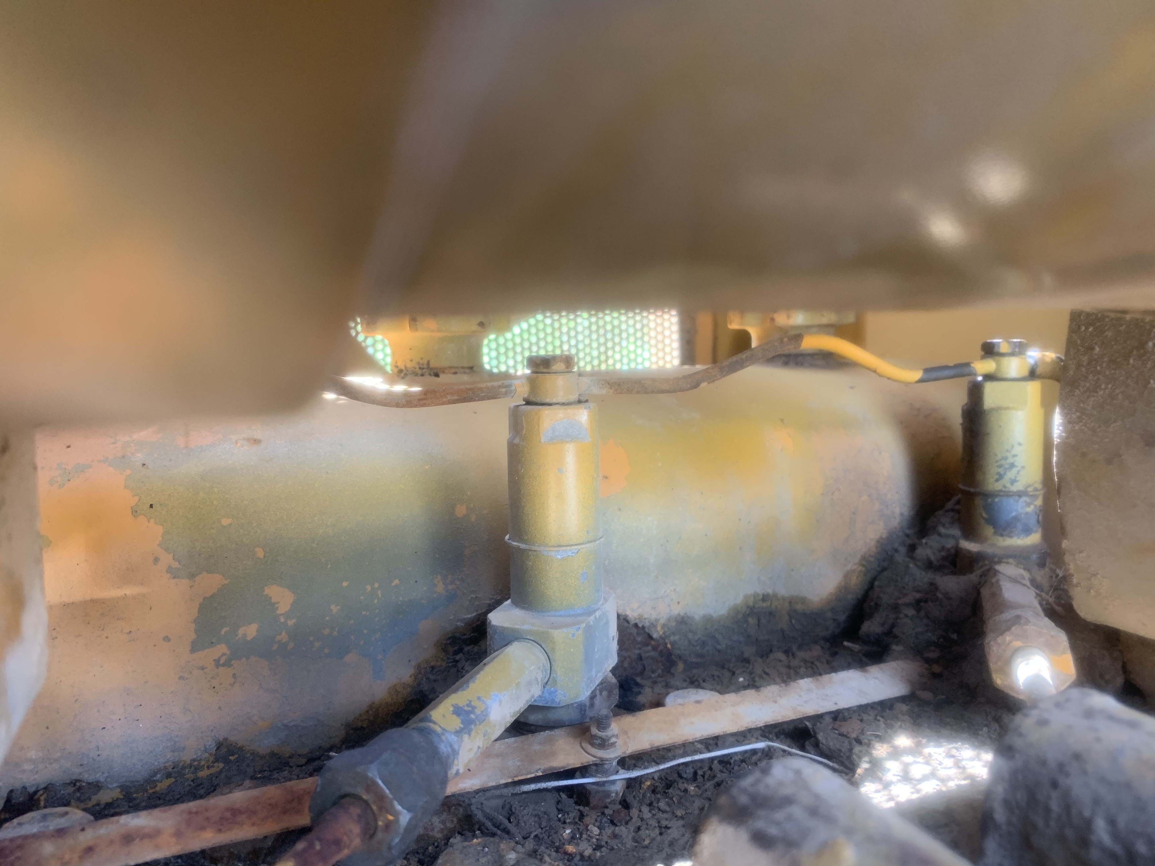

That BAR UNDER the injectors is the connection for the GP's.. U can clearly see them..
IF u have a test lite or multi-meter, check to see if they're getting 12v when u turn the key ON..
SOME operate when u turn the key to the LEFT..
I THINK I told u to use the hand primer, way back.. when this 1st came up.??
