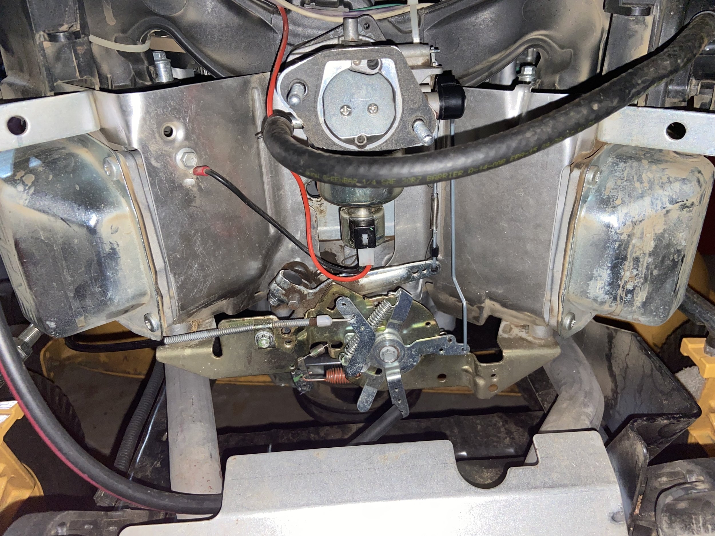

my mower has a Kohler elite 7000 and I see a lot of them have two cables going to the front when mine only has one. Are they always supposed to have two?
/ Kohler 7000 series #5
They are built both ways. Welcome to TBN!
/ Kohler 7000 series #6
Thank you. I just wanted to make sure something wasn't missing because it isn't running right now.
/ Kohler 7000 series #7
How do you adjust the throttle when only one cable?
/ Kohler 7000 series #8
You'll want the choke control to start to move when the control begins to enter the choke position.
